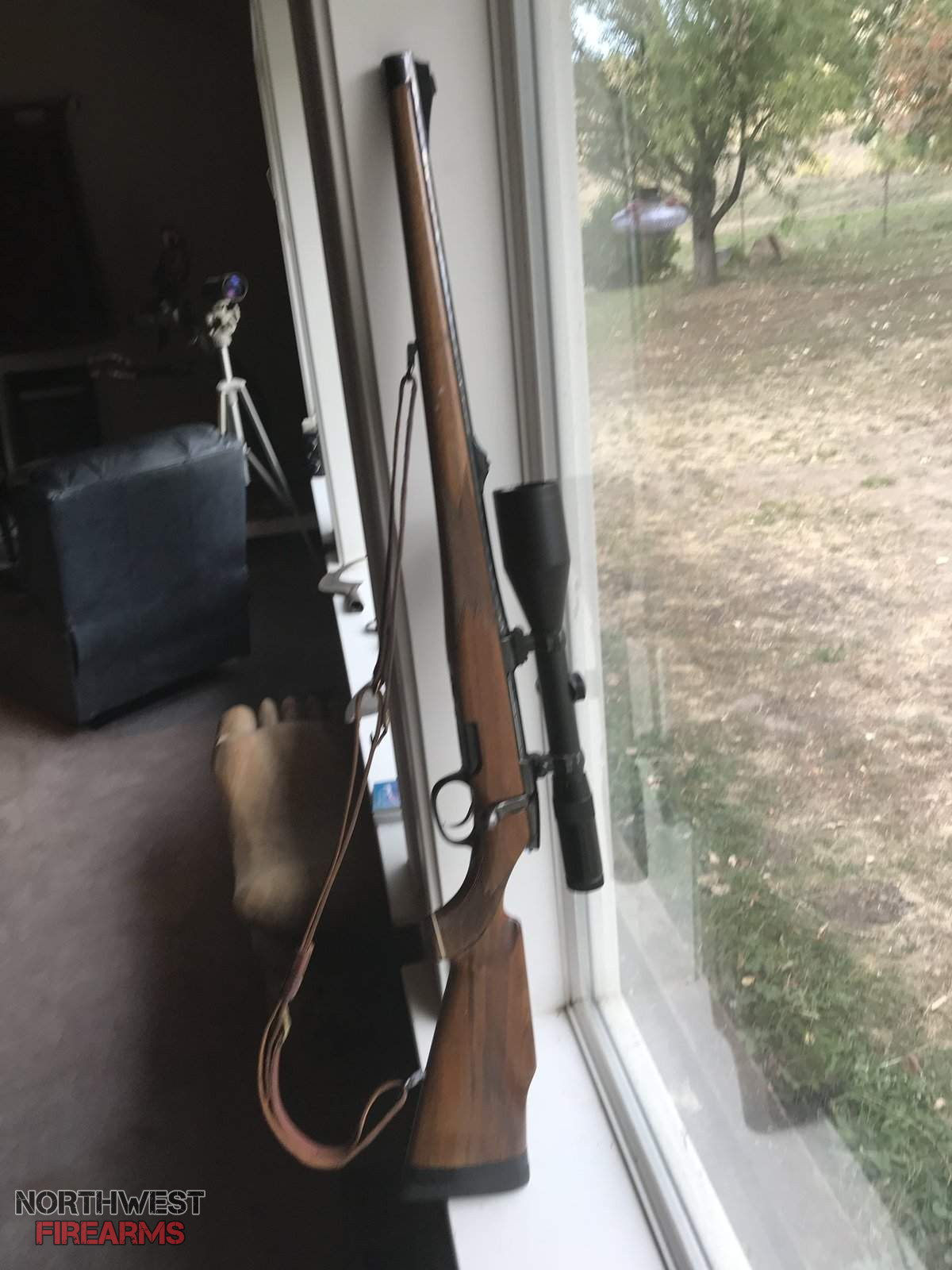

My AR-10 wears a Leupold 8.5-25 which I would feel comfortable putting on the AR-50. I would Not feel comfortable using another brand of Scope even for this Shorter Range Rifle. I've had too much Excellent Luck with the Leupold line.
