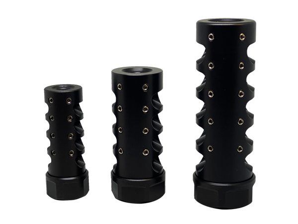

Probably a little media hype in that 84% figure, but they are well known to be one of the best on the market for highest felt recoil dampening and lowest to no concussion. One nice feature with them too is the ports are parallel and only partially drilled... allowing you to adjust Lt/Rt gas expulsion and barrel rise custom to your rifle.
I don't own one, but I was able to run a few mags with one and helped a buddy drill out his ports for fine tuning. Pretty sweet brake and would be right at the top of my short list.
One nice feature with them too is the ports are parallel and only partially drilled... allowing you adjust Lt/Rt gas expulsion and barrel rise custom to your rifle.

I've never shot that one, but just using a bit of google-fu and some reviews over the last while... it looks pretty good. Most info is on the lil and some on the Big B, which both seems to be geared toward larger calibers, but they have a micro version.
There may be more port adjustability on the lil bast*rd, but it's also about 1.4oz heavier than the hypertap (4.4 vs. 3). That makes me wonder more how the micro would compare, but there isn't much review info on it.
In testing the lil was pushing over 60% and has very low movement scores, which were pretty impressive. Certainly cheaper and worth considering, IMHO.
