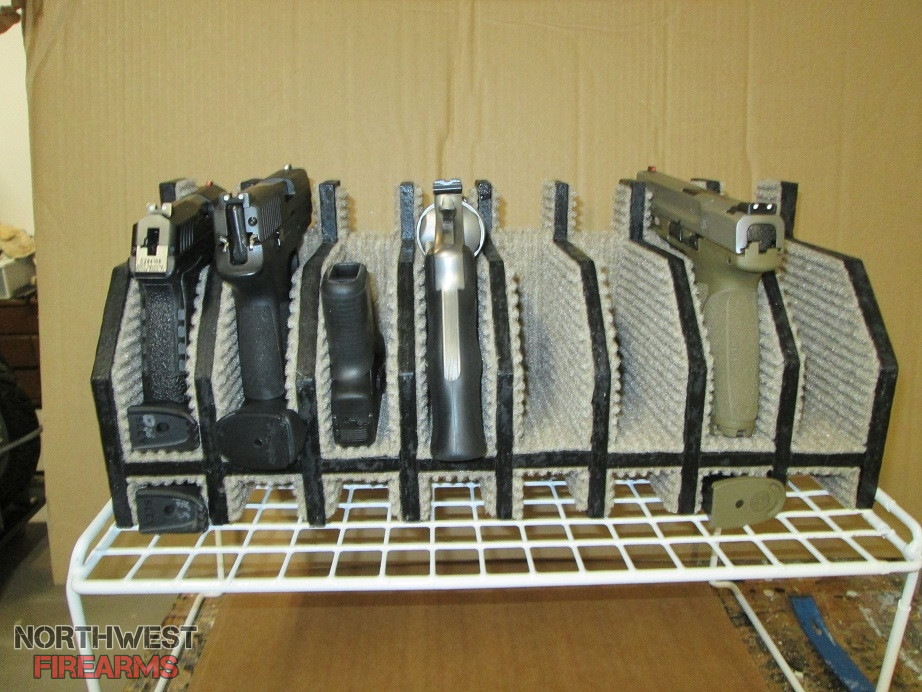

I gutted my smaller pistol safe and replaced the shelves with coated wire type shelving that are stacked.
And just this week added 2 pistol racks made out of some scrap siding, covered with peel and stick carpet tiles.
I used small 1/2x1/2 aluminum angle brackets to hold the wood together on the back and underside.
I could not find the brackets I wanted so I bought aluminum angle, cut it up, and drilled the holes for #6 wood screws.

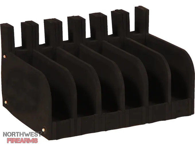

I copied this rack, made of foam, that got some negative revues as being "flimsy".
I put cubbies under each gun slot to store a 2nd magazine.
