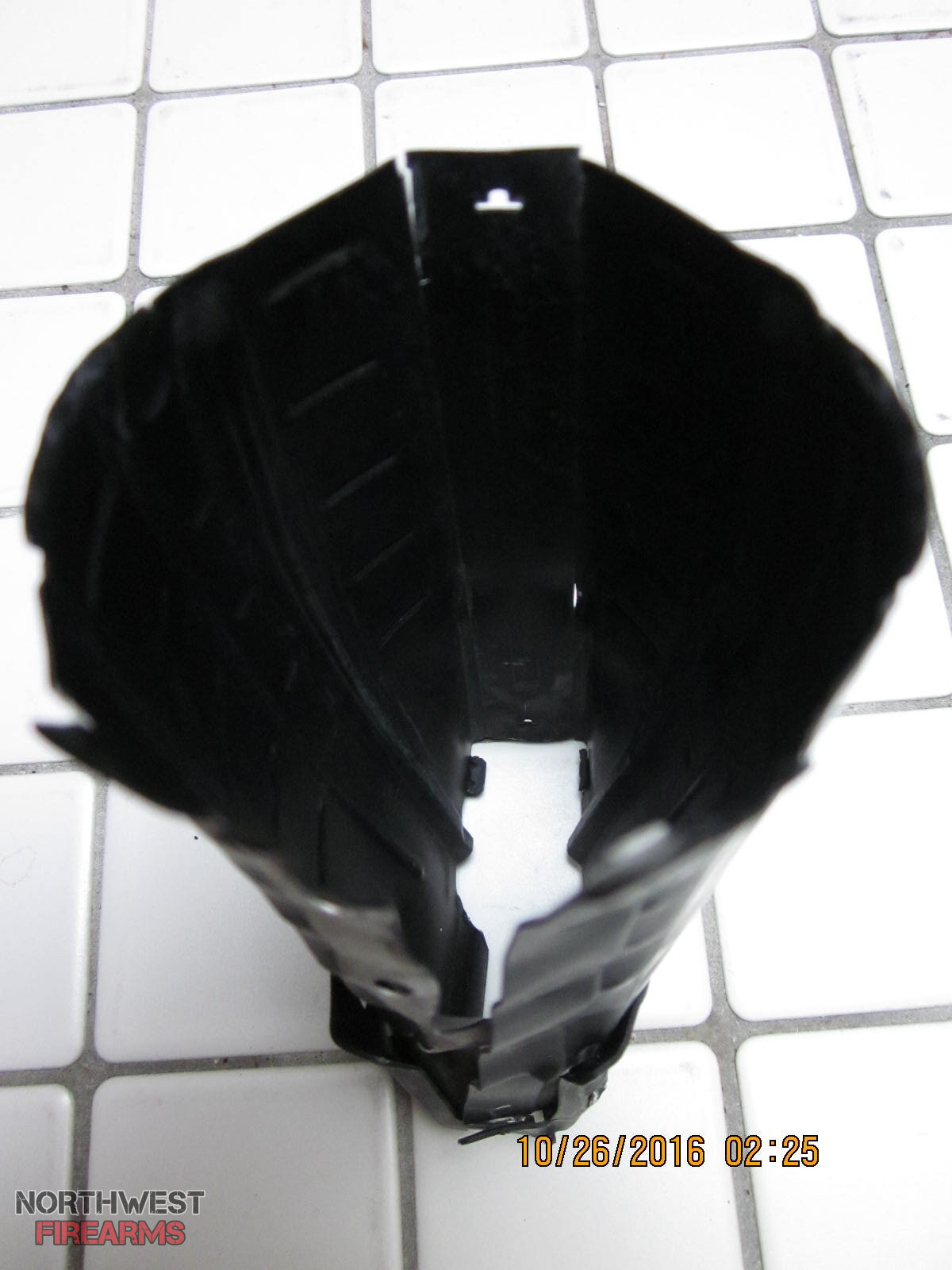

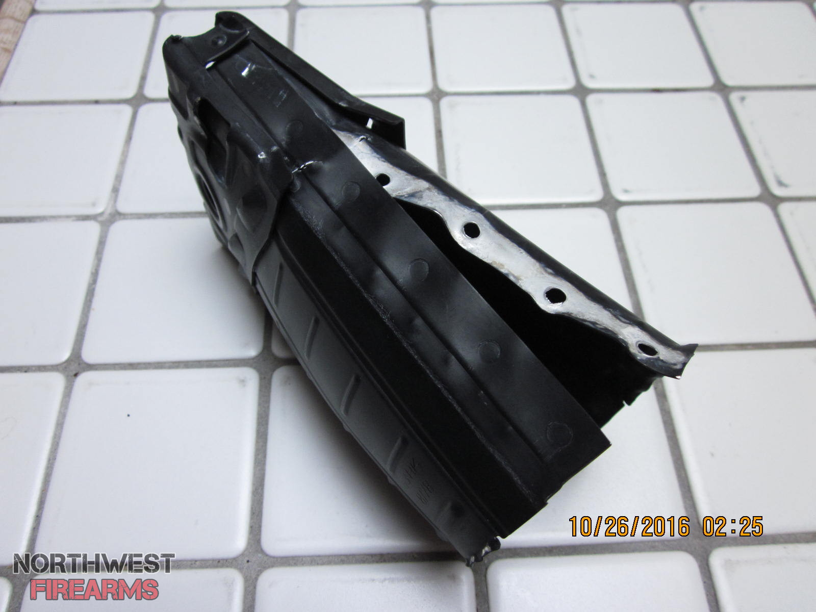

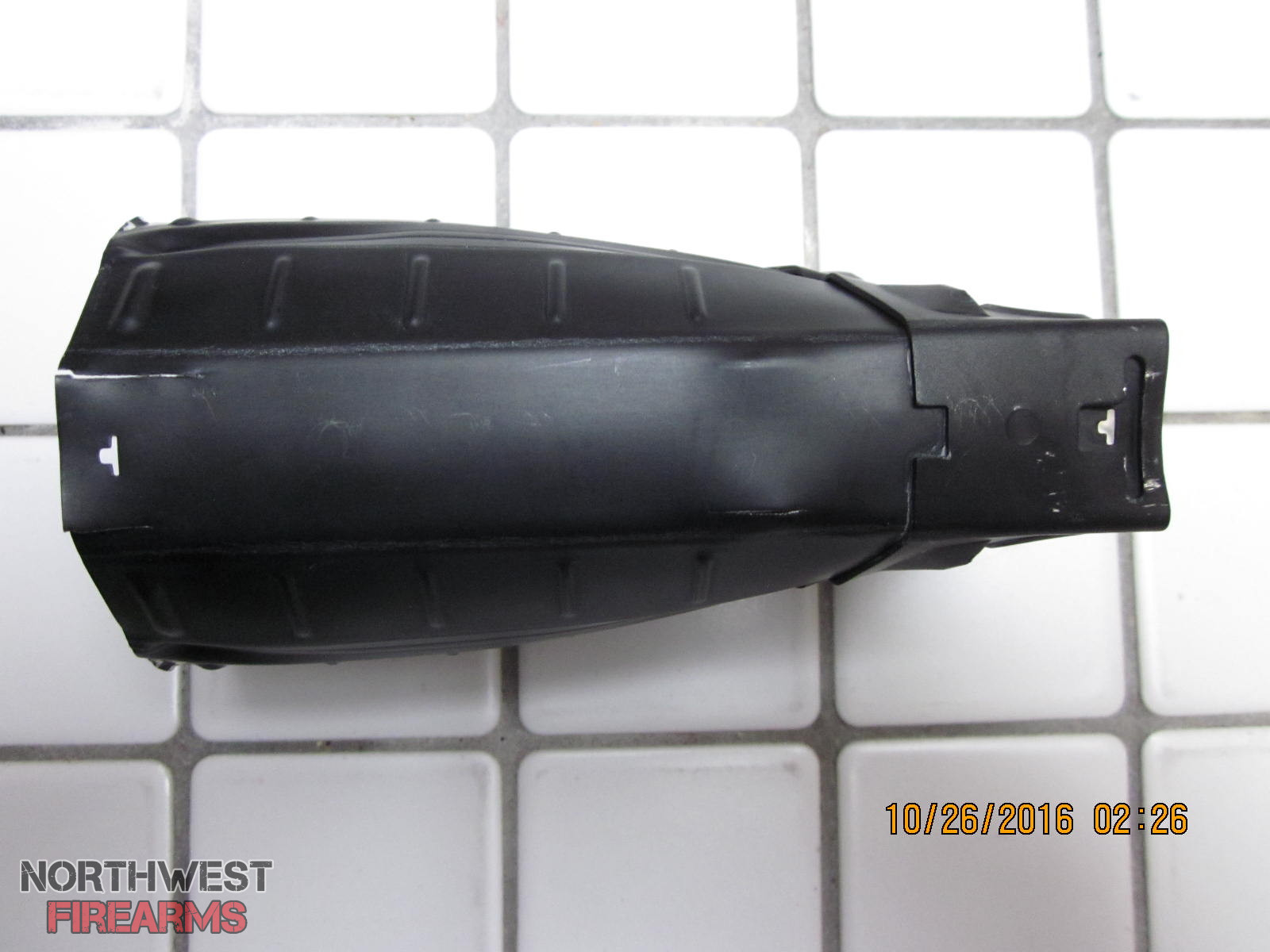

Here's what happens when a bad milsurp round is fired in an HK-91. Bowed the receiver sides out. Remaining rounds and spring, follower and baseplate ricocheted off my leg. No blood, but maybe a few tears.
