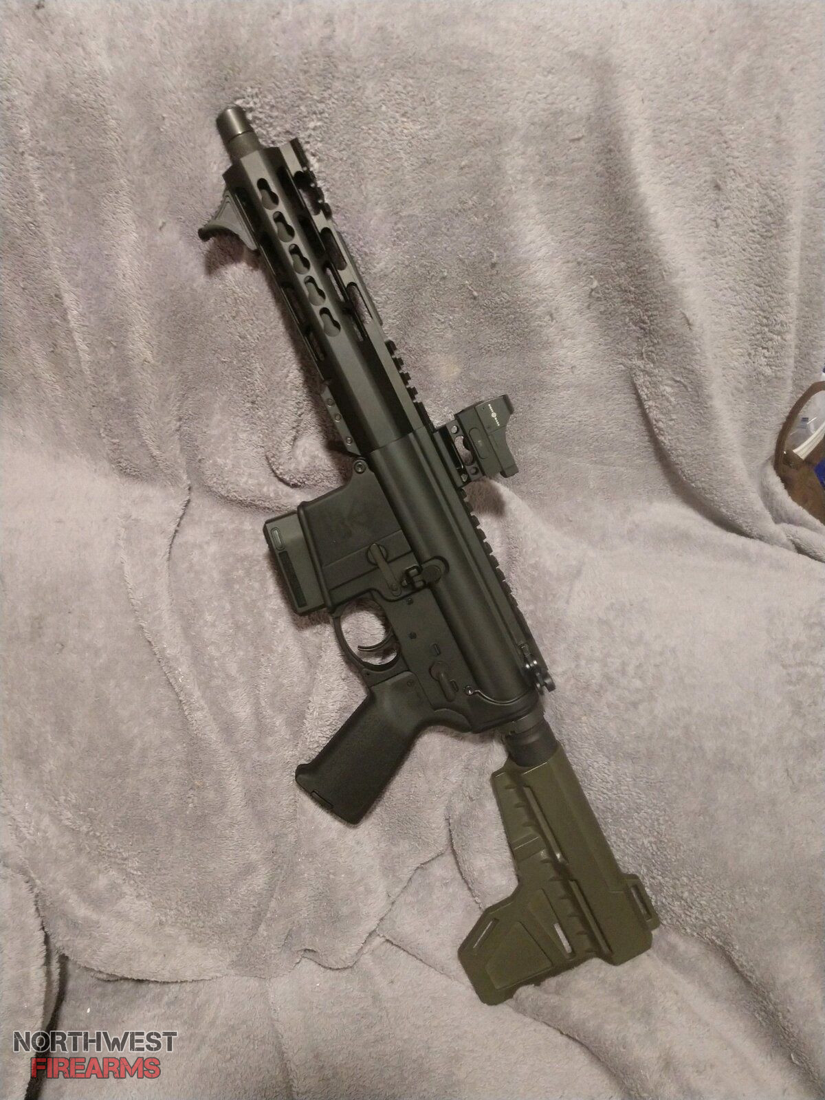

Here's my latest pistol gassed PSA 8.5" build, ended up with a wonky green kAk blade (something I'd like to trade for a black one some time.)
230grain Lee tumble lube mold and silver high temp engine paint for the budget reloading.....
I really love this caliber.
My carbine upper is just as fun for plinkin'

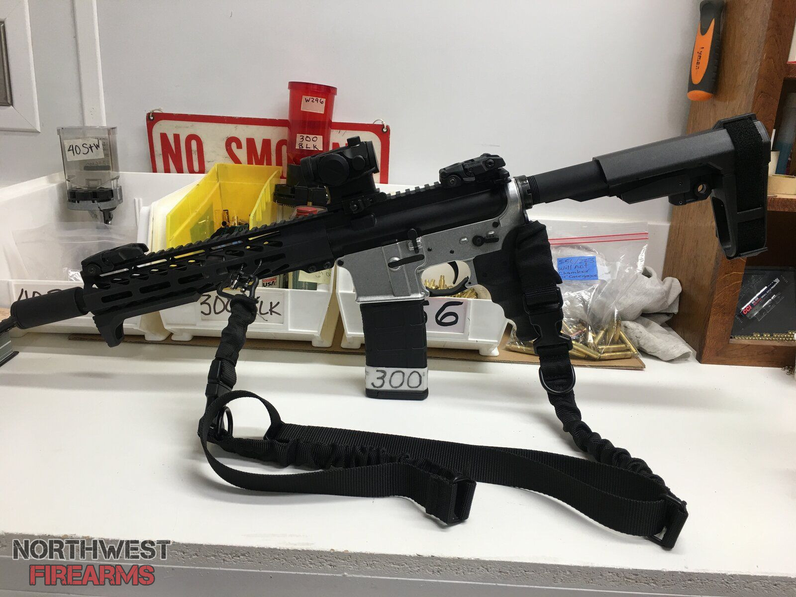

I built a plain Jane a few years ago, It has a 10 1/2 inch BA barrel, pistol gas, low pro gas block, 80% raw lower, Aero upper and just ditched the shockwave for an SBa3 brace.
It was a budget build, $327. I had most of the parts from trades and dealings over the years. One thing I can say is it runs supers flawlessly and I’m not going down the rabbit hole for a can...:D
