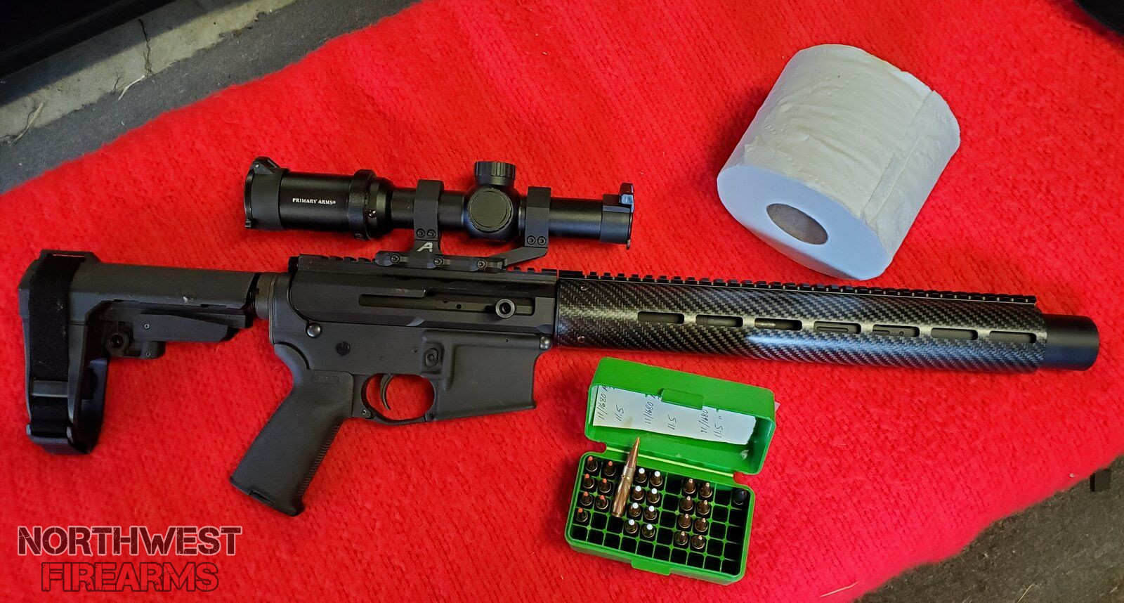

Personal choices I guess. I built this for sub suppressed rounds only. Will only use it inside 100yds ... and some night time coyote hunting. This is a side charger ... just wanted something different. Andersson, 7.5" generic barrel, suppressor is in there.
Just essentials in the picture. GLW build.

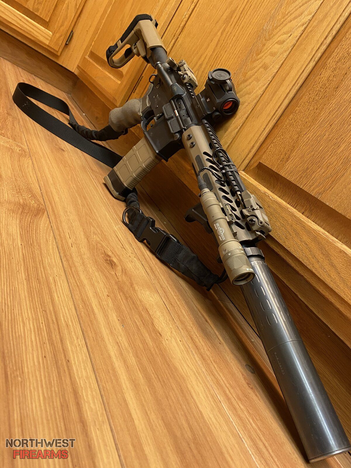

I think go no more than10.5" both of mine are shorter. 8.2"Noveske/PacNor, and Seekins 8.5".

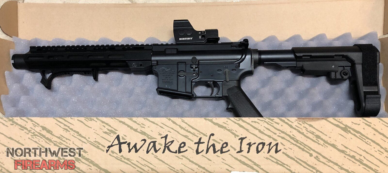

I went with adjustable gas blocks, and when shooting subsonic the JP silent captured spring takes away the "twang" from a normal spring.
Both are pistol length.
