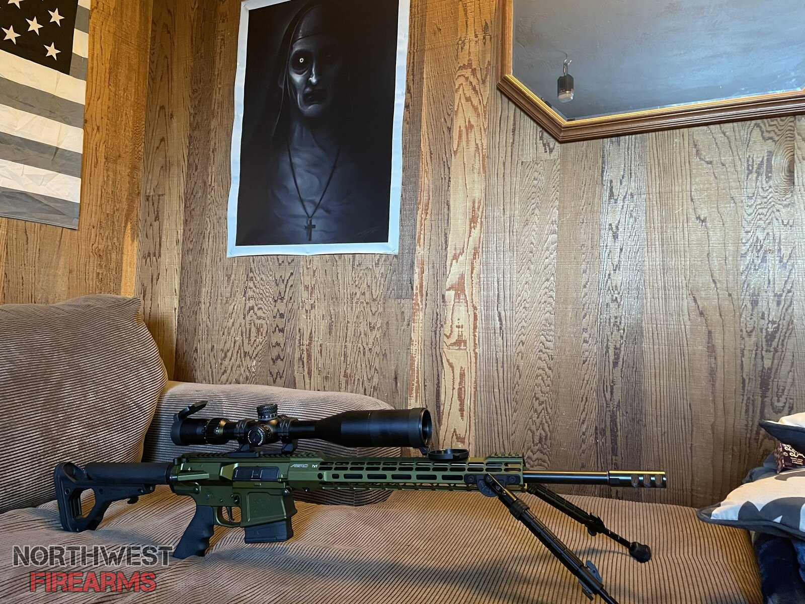

Am I the only one thinking there appears to be plenty of rail to mount regular xtra high rings?
OP what is your objective size?
Looks like you got the low version for LPVOs. For most scopes, about a 1.5" rise works great on an AR.
Here's a pic with the 1.5 mount, seems to have plenty of clearance, apx 3/4 clearance inch at the objective side

Thank you, going for a DMR style. It's rocking a nice 20in heavy profile barrel.
I feel like the warne you turned me on to will go perfectly. Next on my hit list is to replace the Amazon bipod…

50mm objective size, the mount pictured is a 1.5in high mount.
With the relief in the rail, from the picture you posted, you might get away with running plain ole high rings. That would also lower the thing a bit as in that mount it looks more like a chin weld might be needed.

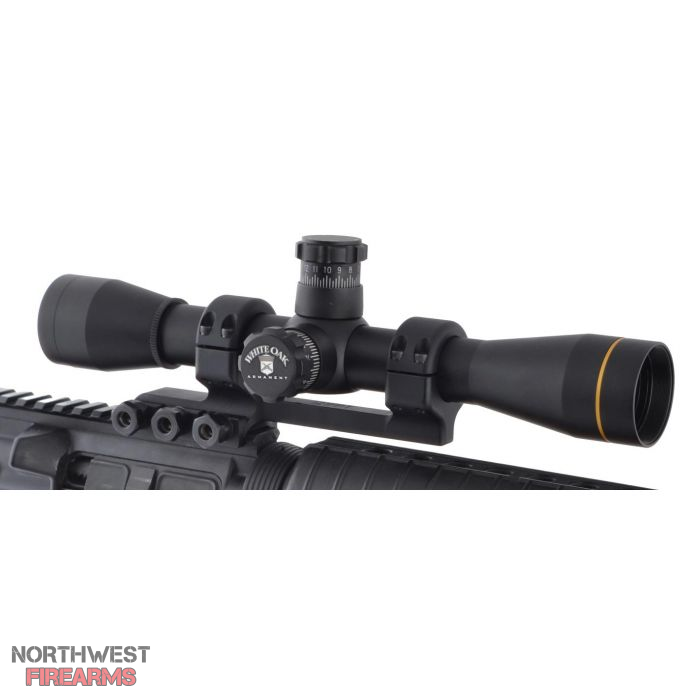

A standard A2 sight is 1.365" (200 yards) to 1.465" (600 yards) above the receiver. I like this freedom Reeper
one piece 30 mm mount it is 1.38" above the receiver to get a good cheek weld on the stock. Also has 3.8 " forward
offset to get the scope far enough forward. Nose on the charging handle. No Loctite needed and available
with 20 MOA elevation.

Why would a scope need to be that far forward? Is the mount specific to a "scout" scope setup?
Not my type of shooting either, as mentioned above I prefer taller mounts for most of my ARs.
