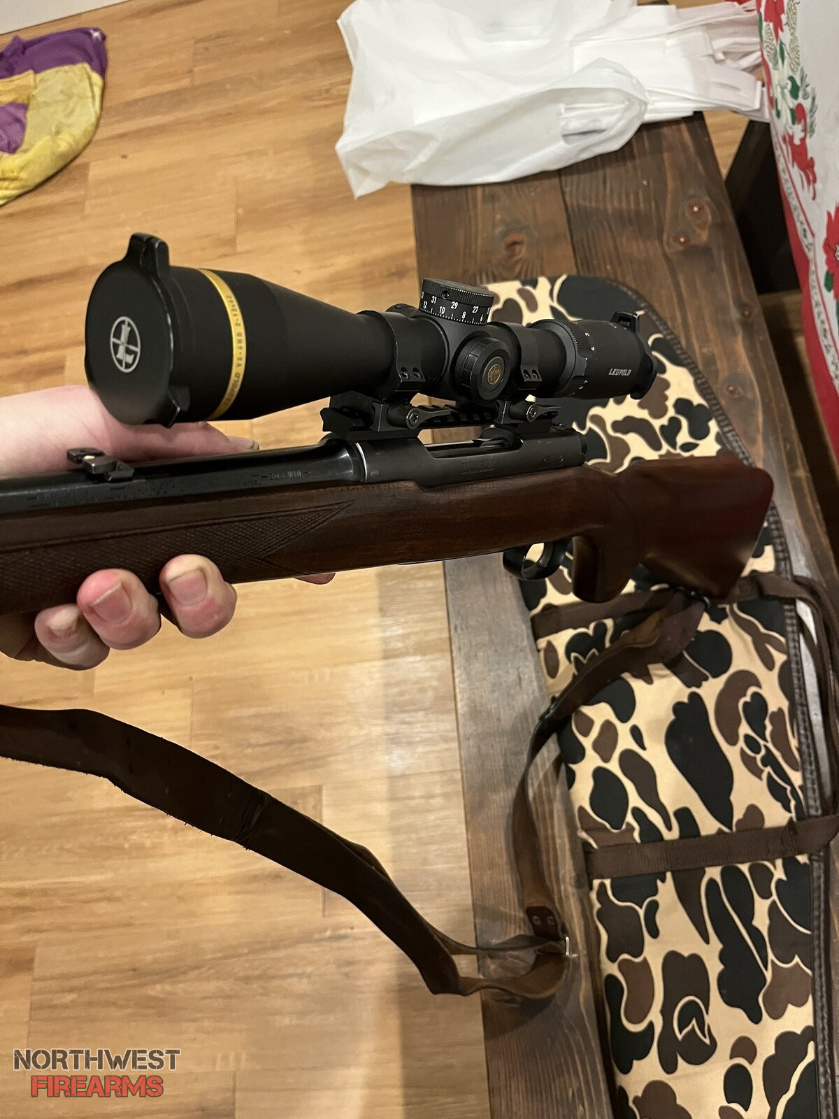

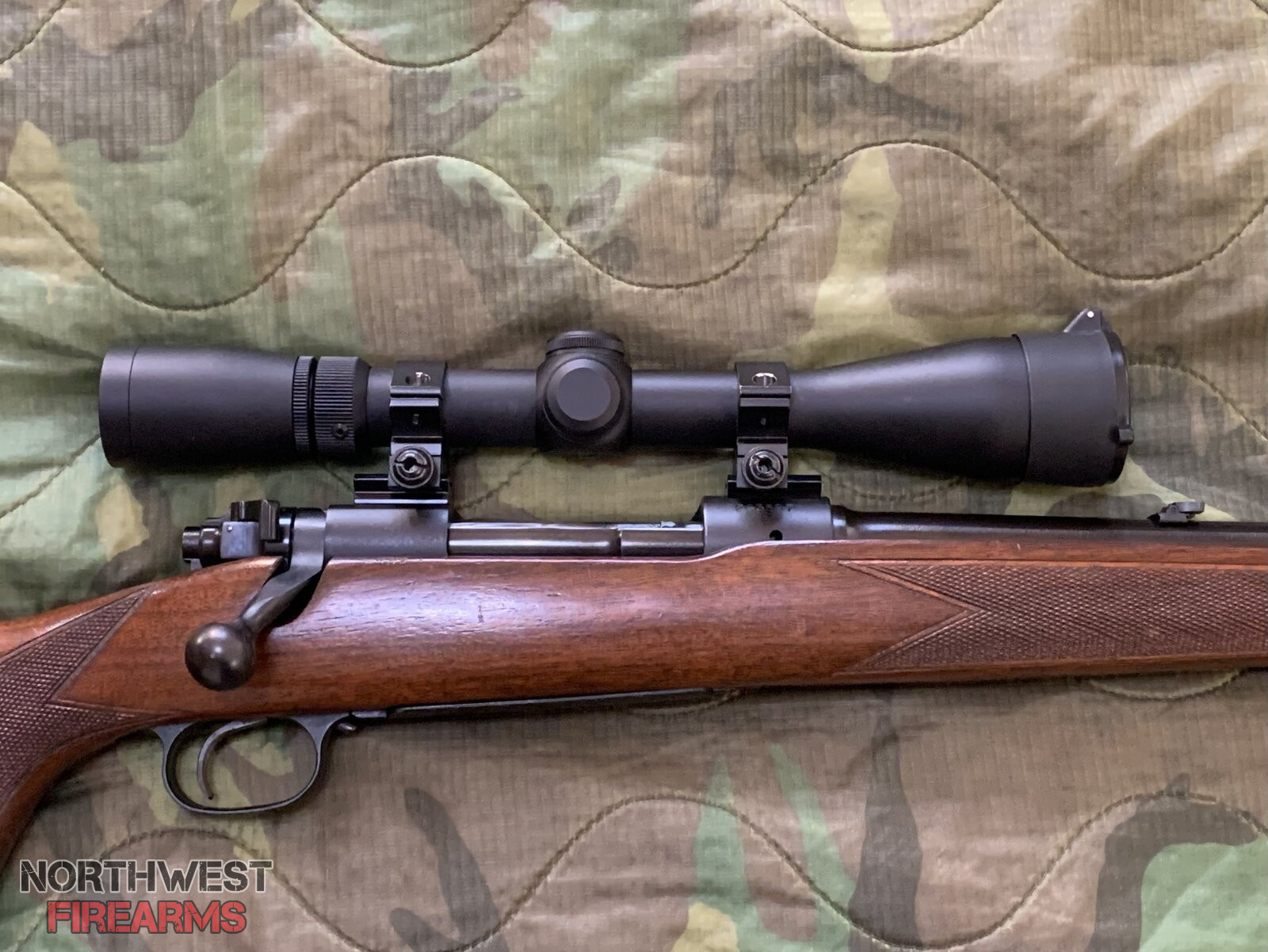

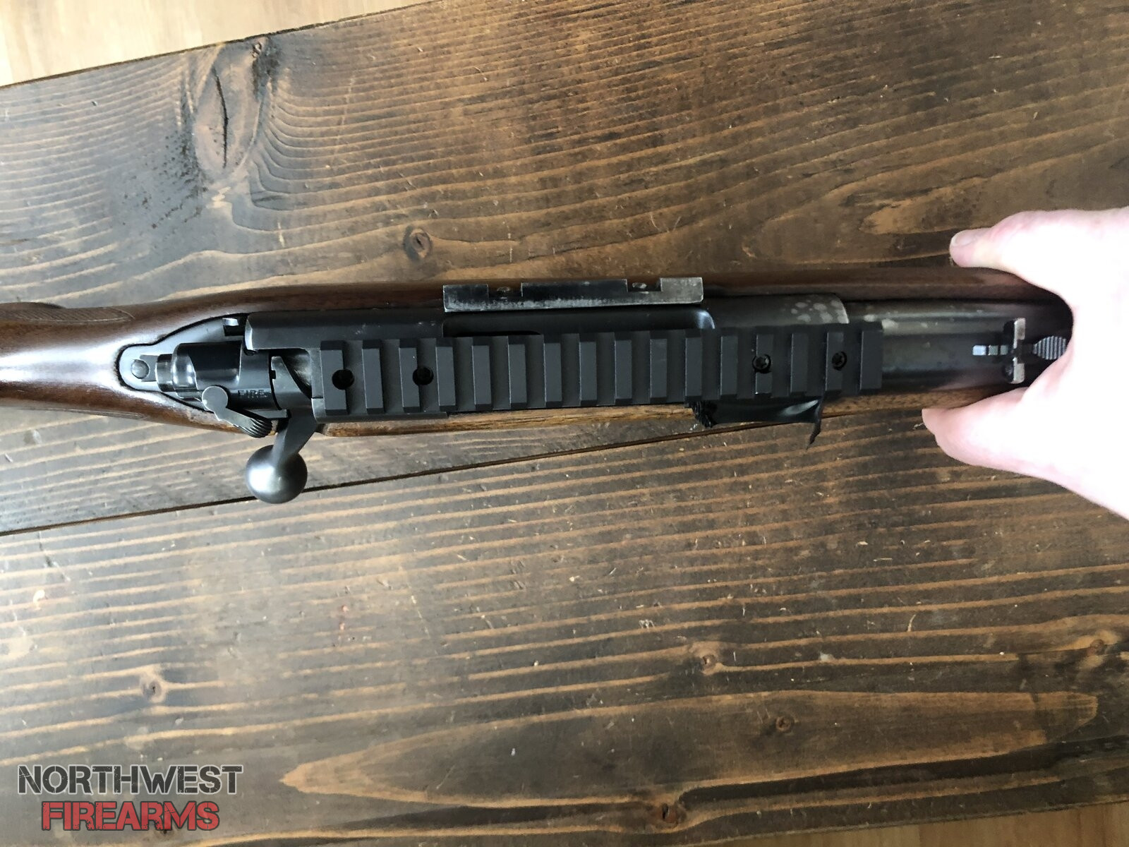

Two separate pre 64 rifles that I did it to.

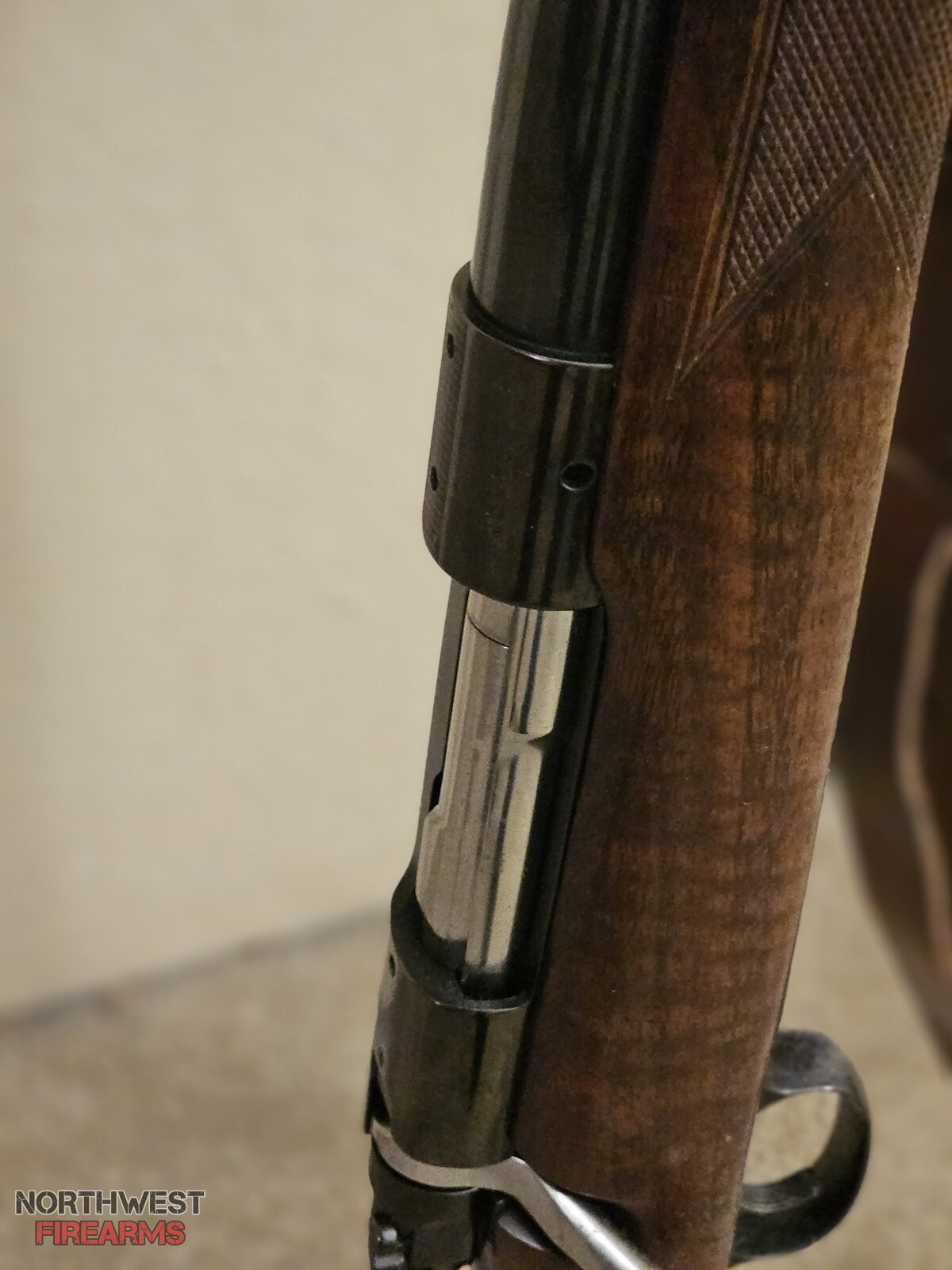

Its a .270 with 24 inch barrel. cost about 1200 last year from Montana.
It looks like the standard hole spacing in the photo, and a standard cartridge , so any pre-64 non-magnum base or bases should fit.
