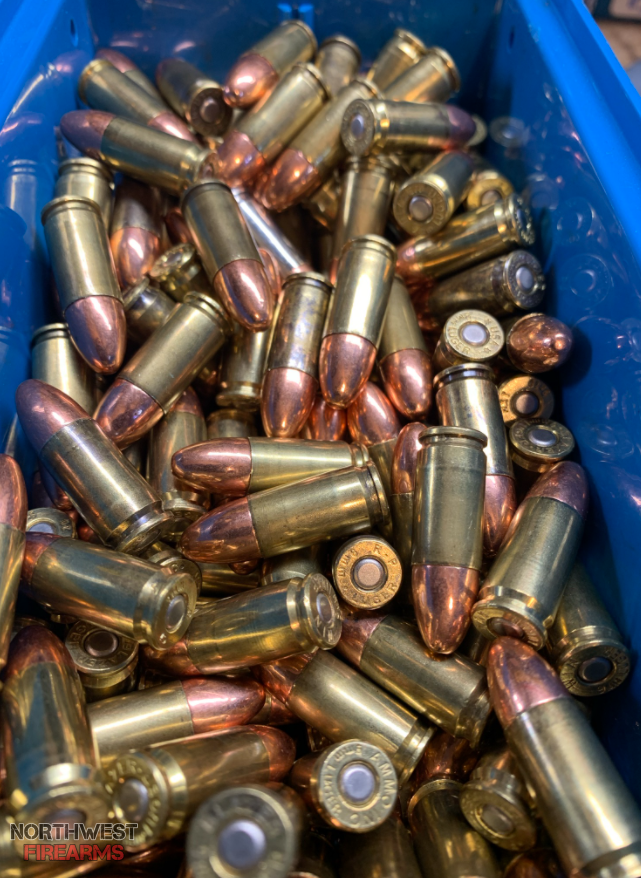

pumped out 200 147gr 9mm subs for the subgun.
The 750 makes short work of them.
Running my powder check and full on progressive mode minus bullet feeder.

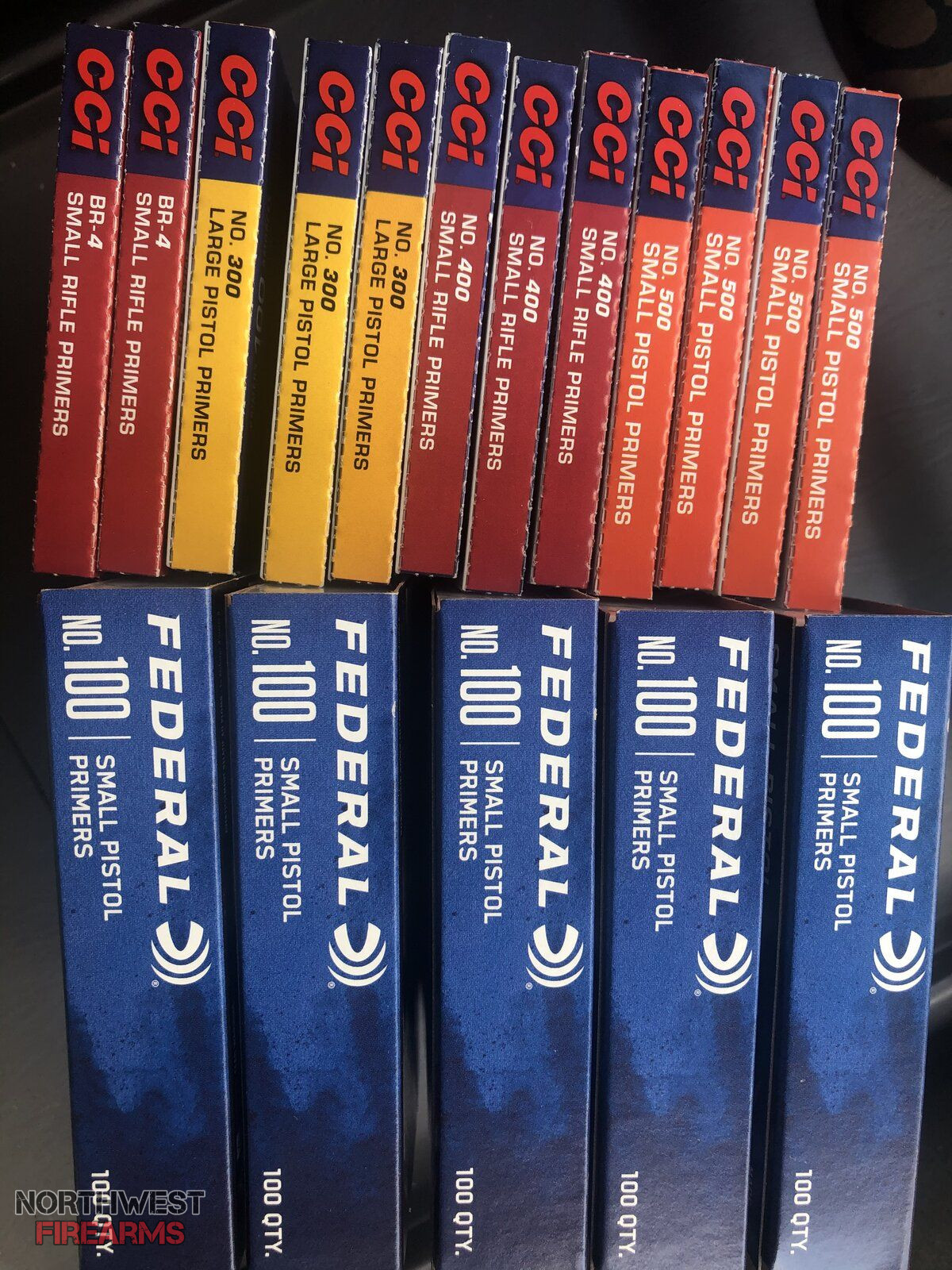

I get it, I loaded a lot of stuff in March/April and haven't loaded since. So I depleted my supplies and now I am low but at least I still have quite a bit of laoded ammo. I have some components but I will have to be judicious on what I load next. I am limited by primers. As spring comes around I will be heading out to the range a bit more.
