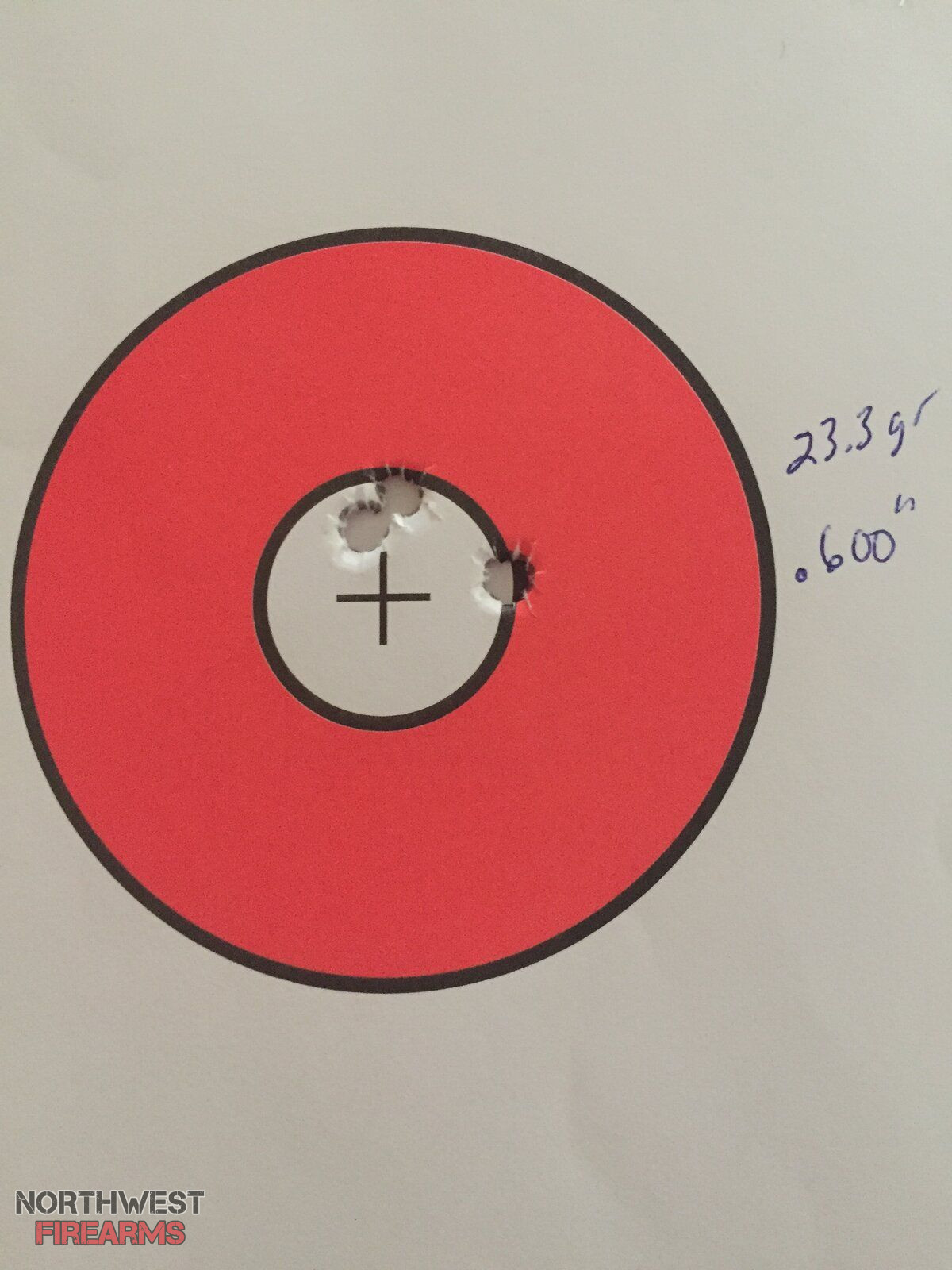

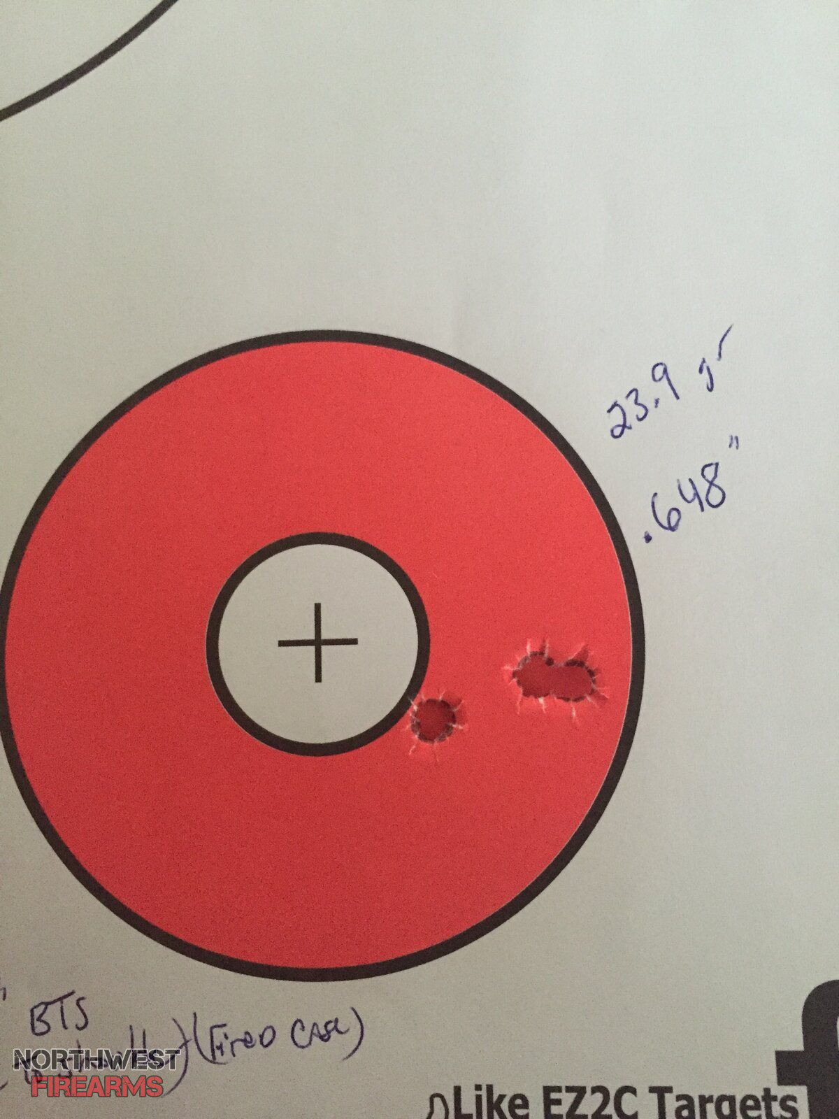

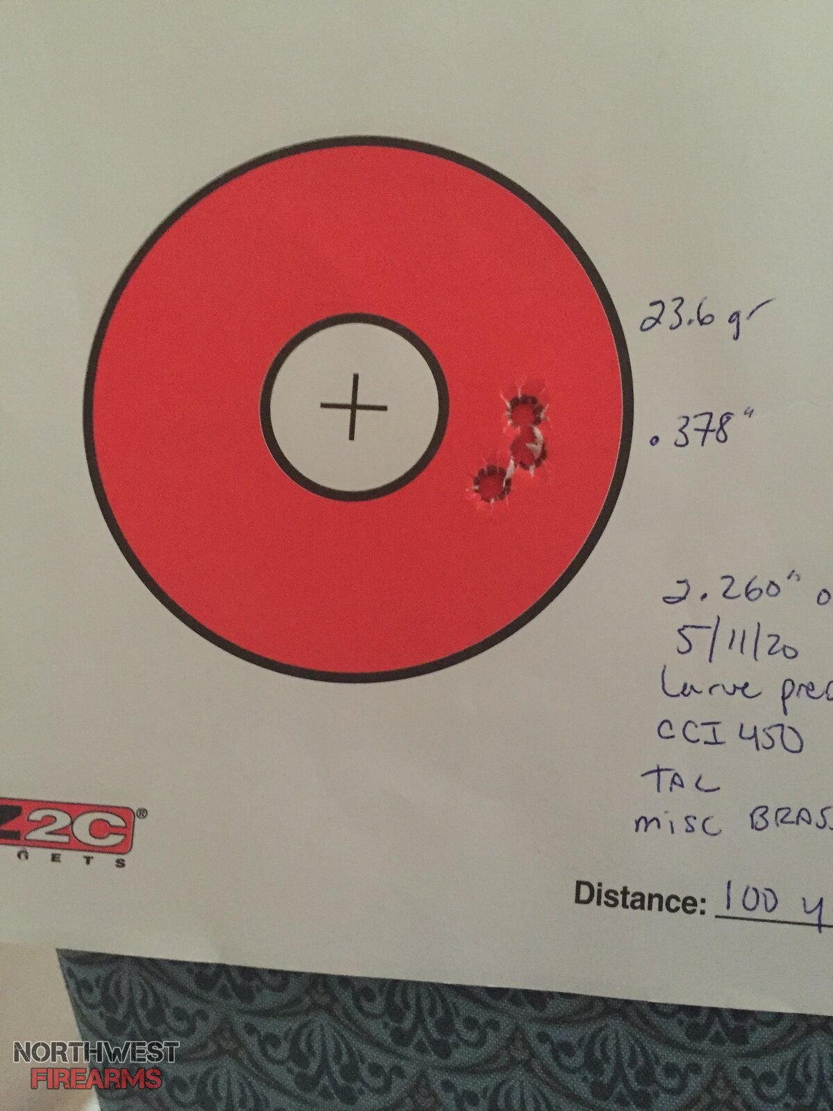

Some primary results from the last load work up.
Here's my problem with that ^^. How do you know that you're not just pulling one shot out of three? Your groups of two are touching for heck sake! And one shot pulled on two of the three targets. I'm not that good! I'm not doubting YOU are that good though. If you look at it that way, your three loads shot the same.

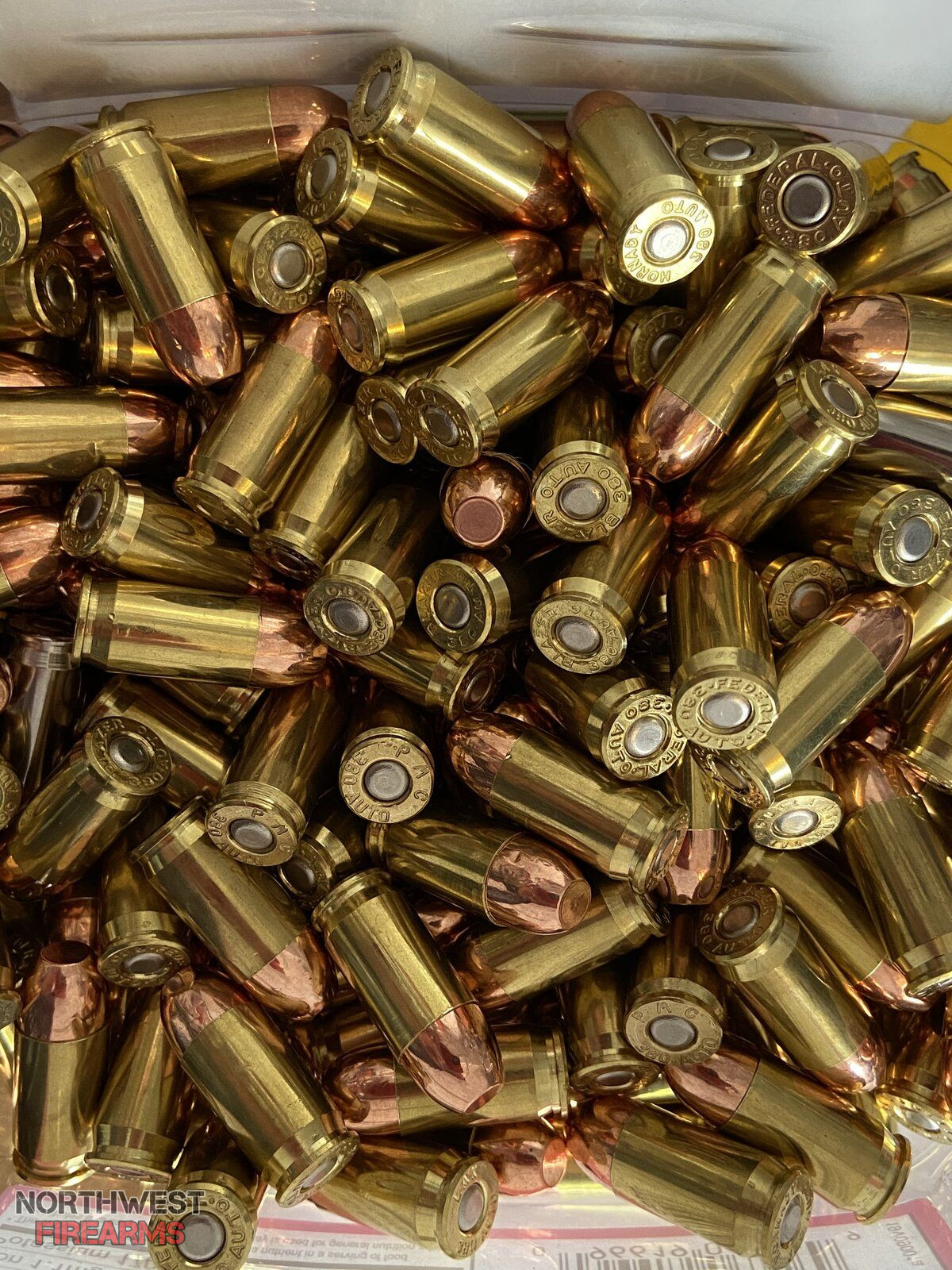

Thanks @Lesliet , I'll put this data into my notebook for future reference. This last batch I've been testing has been designed to use up some old stock of powder and primers. I have about 5 pounds of aging Red Dot that I'm shooting up as well as some old primers I got in a trade along the way. The Red Dot was opened in 1988 and has been going strong ever since, but it is getting long in the tooth, and I have way to many different cannisters of powder on my shelves so am trying to use up odds and ends. After I use this up I have a couple of 8-pounders of PB and Herco that will need shooting then I might get to trying some of the newer powders out there. Since I have three kids shooting as well as myself, the consumption of this much powder will probably happen sooner than you might think.
So, I settled on 4.1 grains of Red Dot under a Speer 115gr. TMJ's I got on a killer sale a while back. This was 100% reliable across 5 different pistols and the accuracy was plenty good enough for holster drills and speed type of events. The smoke cloud this powder creates is kinda fun too!
800 so far … will do another 700 over the weekend using up all my 115 gr. bullet stash. Then there is the 1,000 147 gr. pills sitting on the shelf (oh … will it ever end …).
I've just shot my first home rolled rifle rounds. I set the target at 75yrds because I'm using the irons on the Garand. That's hard enough for my eyes, with glasses, to see the RED dot. I actually got decent five shot groups, with three at about 2" and two flyers a couple/three inches out. Powder weight varied 42-46 in four five shot groups. there was very little difference in the groups. Is it me? Is it the load? I'm not really looking for any answers. I'm new at reloading rifle rounds, but I'm getting the same thoughts that I did with handgun rounds, powder amounts don't seem to make a lot of difference.
Maybe I pulled some shots, but they felt pretty good when the trigger broke. Sometimes the groups just look like that. I'd be happy if they continue to hold that size. Have to go back and proof them with a couple of 5-shot groups for each charge.
The scope was not high power. Vortex viper PST 1-4. The dot in the center of the reticle is 1" @ 100 yds so I'll be happy just to repeat this. It's a load work up with random range brass out of a 16" carbine I'll be using for 3-gun. Was just wanting to use a bullet that will hammer the steel a little more so the RO can call the hits easier.
I decided some decades ago that shooting for group was useless. I only shot for point of aim.Having a nice 3 or so group 3" away from the bull just means you missed 3 times.
I find shooting for groups quite useful when working up a new load. I decided decades ago I'll shoot for groups to see what combination the rifle likes. Then I'll adjust for point of impact once the load is completed.
