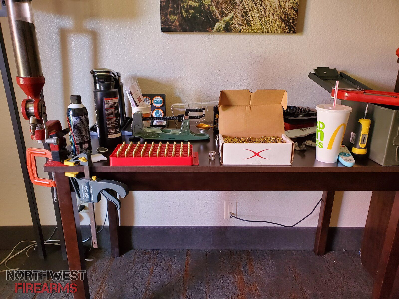

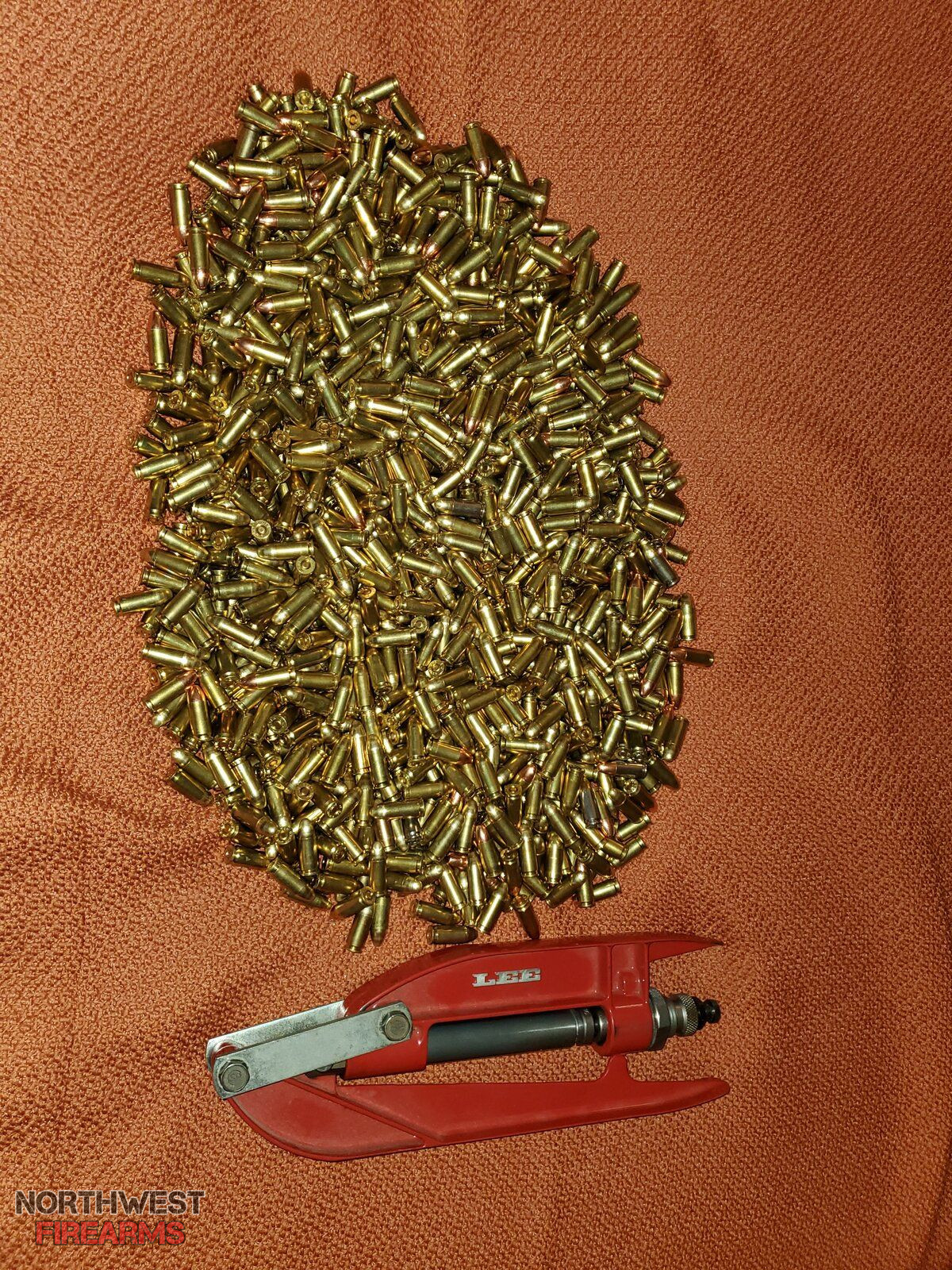

I stay in a hotel a lot. Some times I have a little extra time so I take a Lee hand press a hornady powder dispenser mechanical scale. I enjoy reloading otherwise I wouldn't have loaded 1500 rounds today. Now this was prepped brass sized pri.ed and flared. Just add powder and set bullet.
View attachment 694867 View attachment 694868

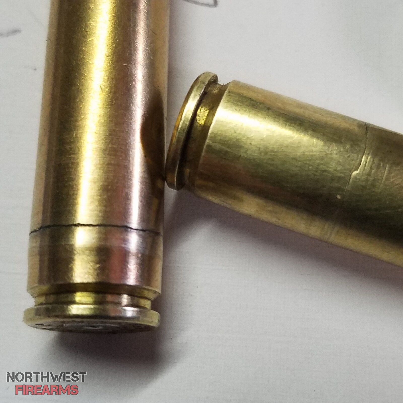

I have fire-formed ~120 cases thus far using 47gr out of an ancient can of IMR4831 and 17¢ 140 grain plinkers. I think I tossed three S&B from the first batch.
Yesterday was 50 cases, and those are two that failed. I noted a dozen of the cases had pushed out primers. All R-P. Either loosening primer pockets or they really were over pressure. Of those two, nothing at all occurred during the shooting, just noticed those on brass inspection before deprime and tumbling.
[edit to add] This would be the 3rd firing of these cases. I have two hundred Lapua 6.5x55 brass still in the box, but I wanted to be sure I loved the cartridge before I made them value-less. I think I'm way past that now. :)
With my other 100 odd brass pieces (RP/ S&B / PPU), I want to develop a better way to fire form than wasting bullets. I think I'll give the packed kapok on 15 gr of Titegroup recipe a try. Why waste a bullet, even if it only cost 17¢ ?

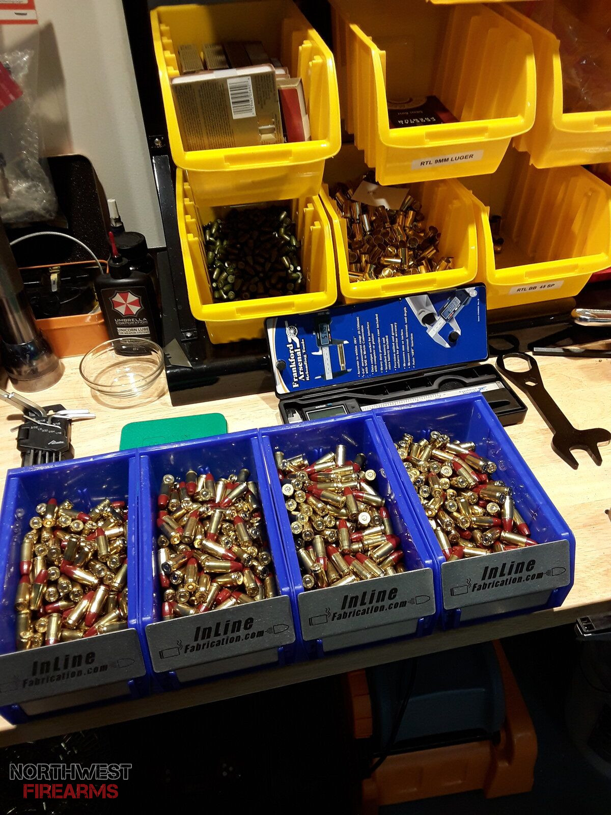

750 rounds of 9mm gamer loads. Need to up my game, shot 850 today! If we start getting more checks from the gubmint, maybe I can spend it before the currency devalues, and get a fancy Dillon with the feeders. Been reading that the Hornady feeders don't work as well, so that press could just stay set up for .380.
Set up ladder tests for several different weights of 9mm bullet using AA2. Need to size my cast and Hi-Tek coated 135 grain 9mm slugs, so I can ladder test those. Trying to get more data in my loading book for the powders I can get, and get to where I can use a bunch of different powders depending what's available. Can't find WSF anywhere local, that's been my go-to for 147 grain 9mm loads.

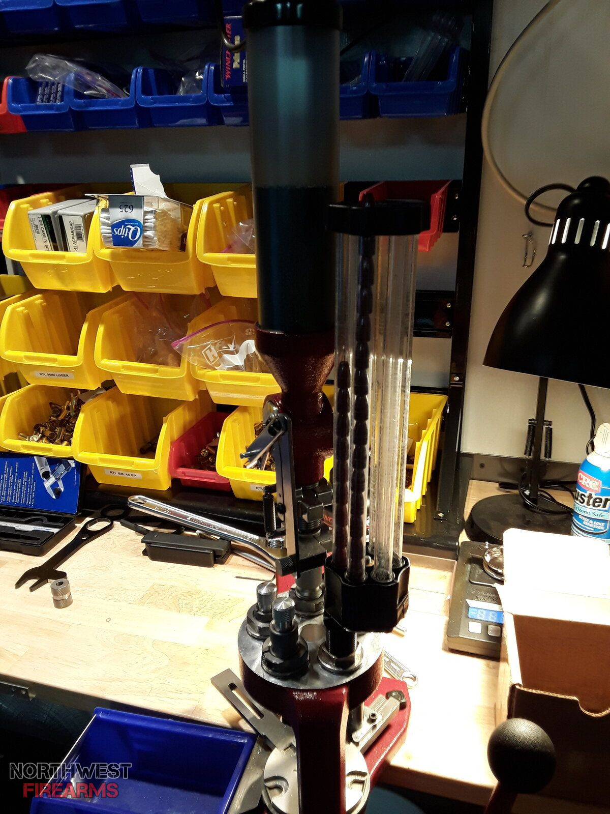

Sized 850 of my 9mm 135's, time to load some up with Accurate #2 and see what works.

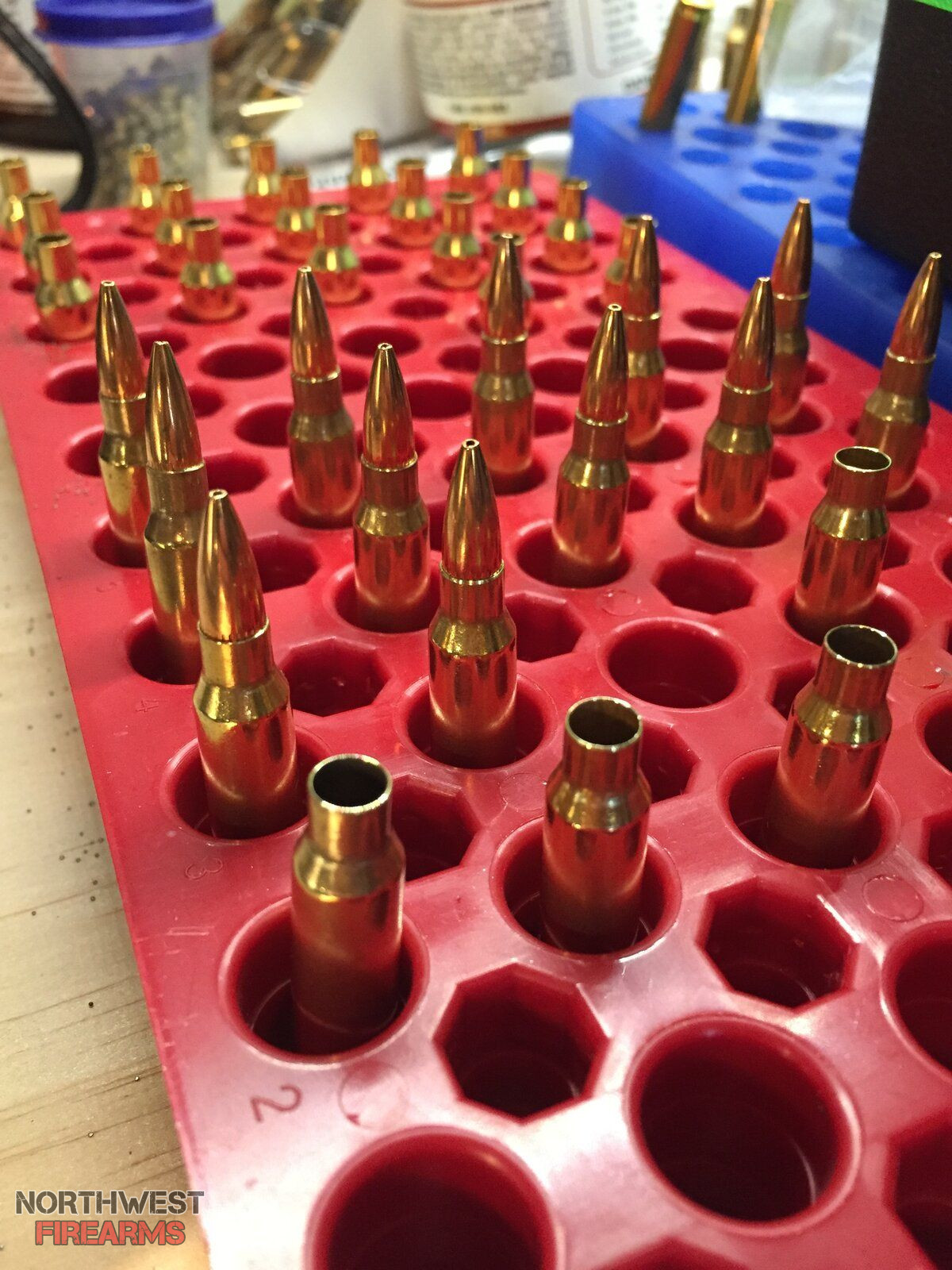

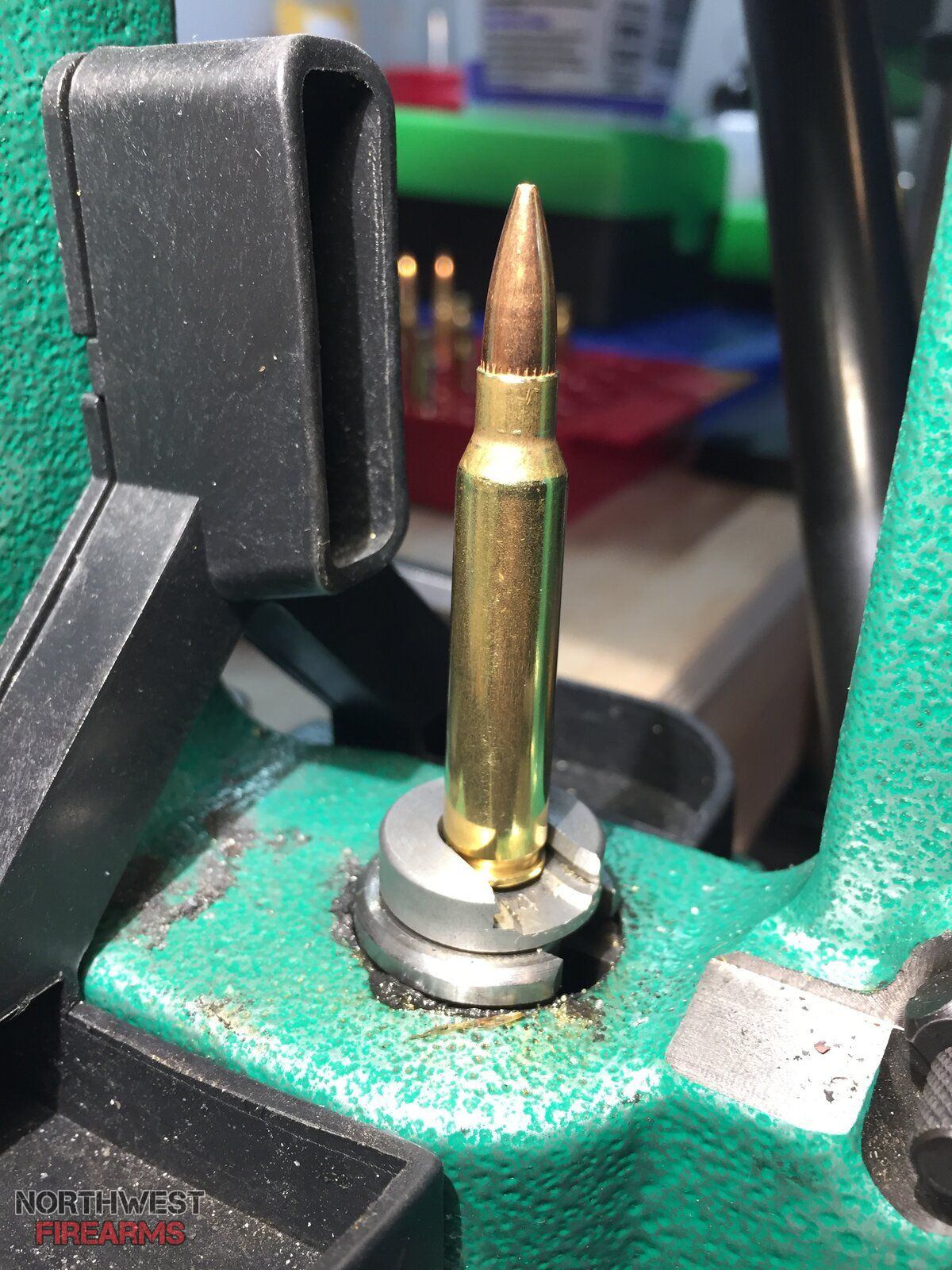

Loaded up some .223/5.56 ammo and tried it out the other day. I was pleased considering it was all mixed head stamp range brass.
Gave me some hope for creating a good short range load for the AR for dinging the steel out to 200 meters at the 3-gun matches!
