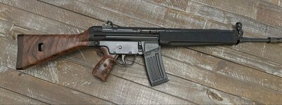

That alone makes it special if you're an HK fan.
Seems to me a lot of folks endow HK with qualities that aren't real. Probably due to being expensive and hard to get (similar to Cuban cigars - they aren't as good as some domestically available brands). Fe hk UMp .45 kicks like a 30-06. Not a great design but it must be good right cuz it's HK? No not compared to other designs.

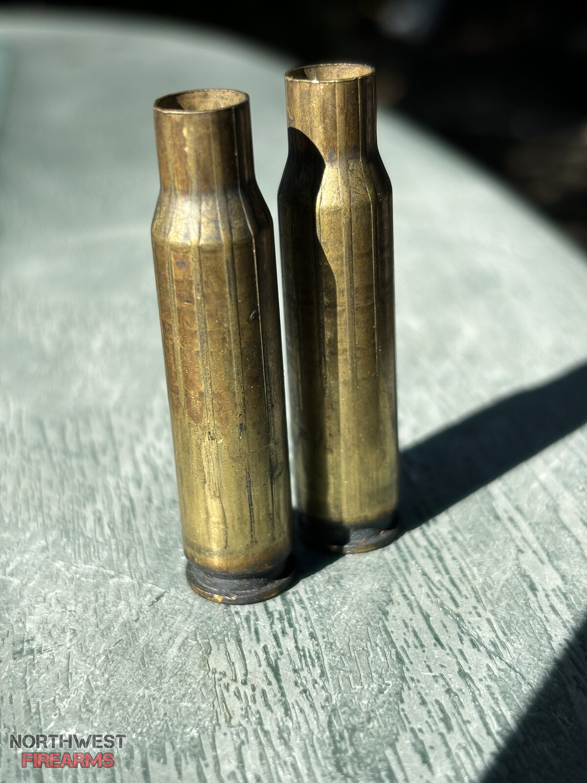

So fluted chambers must be better right? No, they are a necessary design component for the roller locked system. Fluting in rifle calibers can create its own issues. For example here are some of my .308 cases. What looks different about them? Yep, the brass extruded into the flutes, making the case harder to eject. In other words it's doing the opposite of what they were intended to do, making the case more "sticky" in the chamber. The reason is even though hk, ptr, and others allowed for .308 to be used it's still a 7.62x51 chamber, not .308. That means it's designed for thicker cases. .308 cases tend to do this expansion into the flutes.
I was thinking more along the lines of the MP5. Even with a not-great factory trigger and no LRBHO, it's still a pretty terrific platform. Plus it tags my brass for later retrieval. :)
