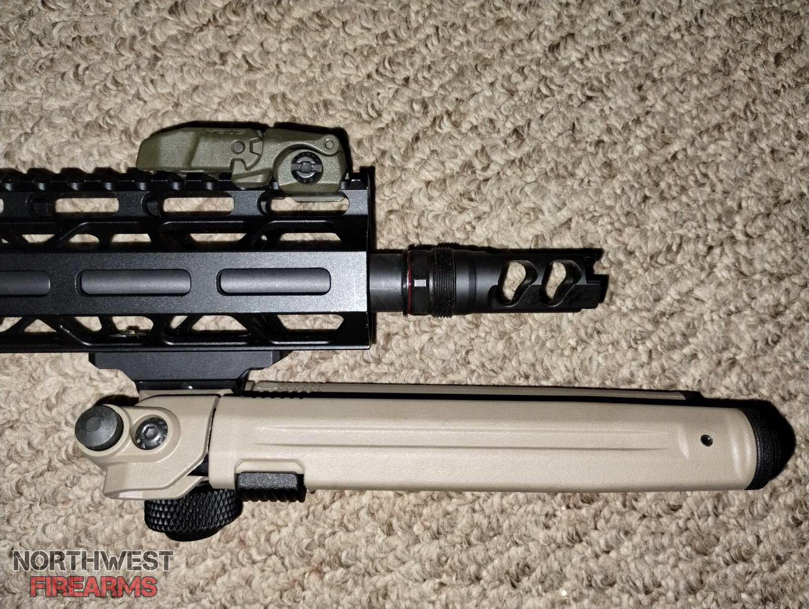

Looks to be clocked ~1/10 of a degree off. Better go redo it.View attachment 1869459
Well that was a lot of work, but I got it done. My soft jaws were not up to the task of holding the barrel, but my vice had a pipe holder and the metal was softer than the barrel. That thing is now dead nuts the correct way and I only had to open a new bag of shims to get it there. Red loctight reapplied and I hope I am never that dumb again.
You're gonna see that every time you pick the gun up. Best to get on it now before it sets up.Looks to be clocked ~1/10 of a degree off. Better go redo it.
I like to clock all my guns just off enough to bother other people who look at em. Or just not clock them at all because YOLO or somethingYou're gonna see that every time you pick the gun up. Best to get on it now before it sets up.
I do this with optics. Because I just want to watch the world burn.I like to clock all my guns just off enough to bother other people who look at em. Or just not clock them at all because YOLO or something

Yeah, I have a lot of muzzle devices that don't need clocking. Just a crush washer to keep things tight and the will to use it. But breaks are really nice, and they kinda need to be clocked if you want them to be most effective. I had the option to get the non-clocking adapters, but the breaks do do a little bit to help the can be more effective. It was worth the hassle for me to set it up optimally.It's one of the reasons I use 3-prong flash hiders instead of brakes.
I hate screwing around with the damn shims to get it just right. If it's off, it's going to bug me.
