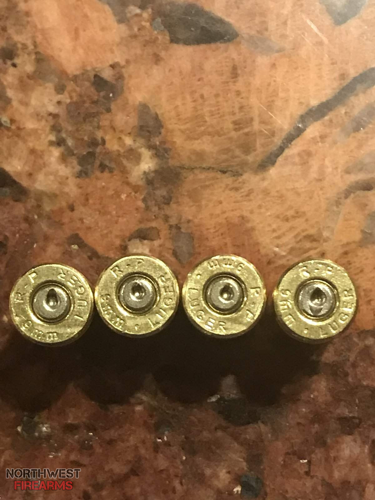

Question out of curiosity, regarding the fire-pin drag.
Would this be a symptom of barrel movement, after the FP striking the primer, the "smear" or "tail" makes me think so?
396
639
It's byproduct how most striker fired guns work. The firing pin protrudes into the breech face until the slide retracts enough to pull it back, meanwhile the barrel tilts down in a Browning-tilt barrel design causing the drag.
