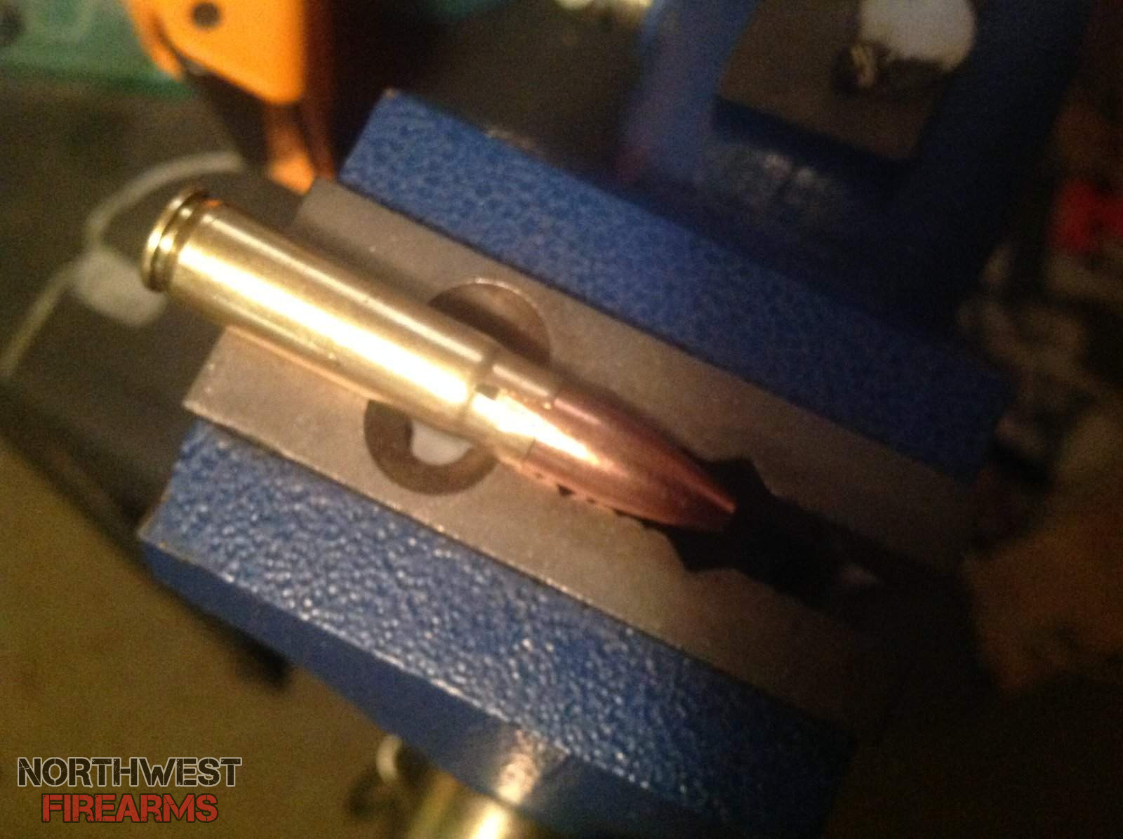

A lee taper crimp die is a must. Some of the lighter bullets don't seat in very far. Here's a pic of a case I cut to get seating depth.. as you can see this Speer 130grain HP isn't very deep in the neck for a COL of 2.040" IMG_2859.JPG
