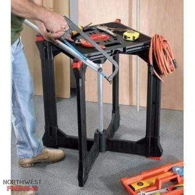

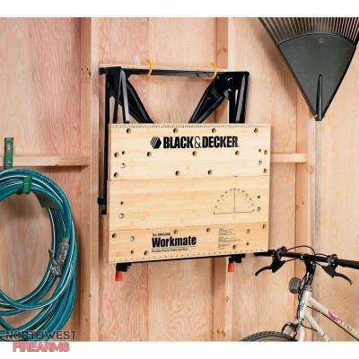

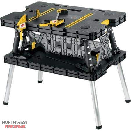

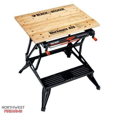

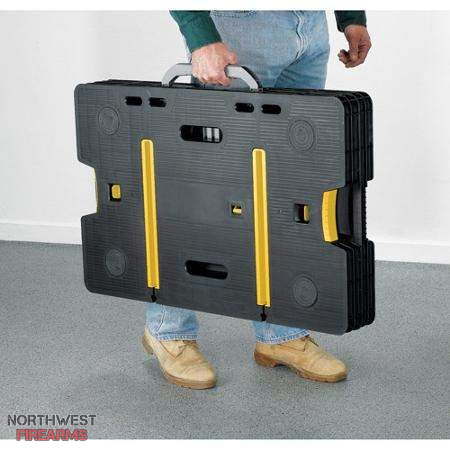

B&D Workmate folded.jpg B&D Workmate set up.jpg Husky.jpg Keeter Collapsed.jpg Keeter table set up.jpg
I can deal with the bolting and unbolting, maybe quick release. A suggestion for the Black and Decker Workmate 225 led me to the work site portable benches which look interesting. Some have clamp features that may be either useful or get in the way. Need to check at a store.
