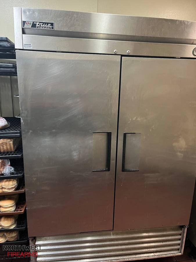

I am looking to move some stuff into my garage/shop. It is not temperature controlled and our weather goes from 110* in the summer to the 20's in the winter. Daily fluctuation can be 40* or more. We don't get crazy humidity but we do get some. My thought is to acquire a commercial grade stainless steel double door freezer unit, the big one's. I don't want a working unit and I have seen two for free advertised online. These units weigh 600 pounds or so.
My plan would be to first convert or update the shelving to hold lots of weight with the right spacing for ammo boxes. I would then cut some pressure relief holes through the back of the unit and plug them with rubber plugs leaving the insulation intact. I would strip out all the non working items as well and possibly make shelves or drawers for boxes of bullets under or over the enclosed unit behind the stock panels. I would like to put a golden rod or other dehumidifier in the box along with desiccant packs inside the unit. My goal is to even out temperature swings, control moisture, and have a secure place to store a decent amount of ammo. I have ammo cans, single cardboard boxes with 50-300 rounds in them, 100 round MTM boxes, and coffee cans of ammo. I don't want to mix my powder and primers in with ammo so I will find another smaller freezer for that most likely.
Something like this.....
I think with proper stacking I could get most of my ammo into one of these. If not it would be enough to alleviate having so much indoors.
Having the thermometer on the outside would be a good way to quickly check temps without opening the unit. Has anyone done anything similar and does anyone see anything I am missing with how I want to build it?

First off, that reach-in doesn't weigh anywhere near that much. Especially considering the fact that you're most likely going to gut it ( the box is light, the motor and radiator are a substantial amount of said weight)
Second, the shelves inside are probably plastic coated steel grates. The attachment points are designed for easy adjustment. Not load bearing.
Third, " free " commercial refrigeration is usually pretty well used up. The insulation inside might be full of holes. Or even dry up dust.

Even if the unit was well used it can be re-insulated, and shelves can be reinforced fairly easily as I have made one of these into welding rod storage that weighed as much or more than ammo. The one I built for welding rod lost 1/4" in total inside width and 1/2" for every shelf....not a bad loss for the weight gain.
One of the free listings had the unit weighing 600 pounds as is. The one unit we had where I worked was every bit of 500 pounds empty.

Modifying shelving/doing a shelving insert would likely be a collapsing death trap waiting to happen. Unless you did reinforced shelve struts all the way to the cement pad…
I like the basic idea of repurposing a freezer to store ammo. Most insulation made lately is fiberglass, it doesn't really deteriorate inside those walls. What I would be a bit wary of is if the wall voids where the insulation is located have been infiltrated by water. Checking that would be just part of the transition from one purpose to another. Drilled holes, you just tape them over. You're not storing nuclear warheads, just creating basic thermal protection for conventional ammo. If you find wet insulation, it should be replaced because when enclosed, it won't dry out.
You'll probably want to fabricate new shelving, the wire racks may not be sufficient as has already been said. Or if you're storing in steel GI ammo cans, just stack the cans if you don't mind moving them around from time to time for access. Put the new or little used stuff on the bottom, the high turnover stuff on top.
