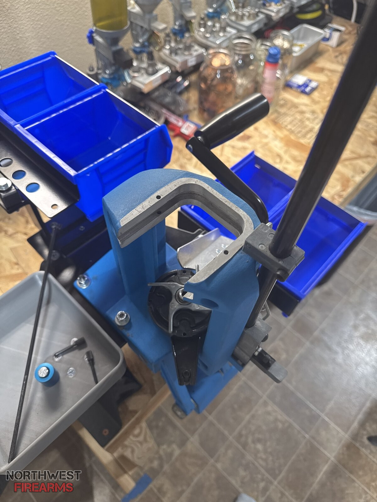

I have press mounted benches and I can work comfortably at them standing up or sitting in a tall chair.
Half of my bench is 34-½"
Presses sit on that with a 10" riser.
Looking down into a Dillon XL750 press and looking at a 550 on a 10" stand on a 34" press.
Both have proper handles that accommodate their heights.
Working height from taller side of the bench. I can easily see in cases and everything is at perfect height.

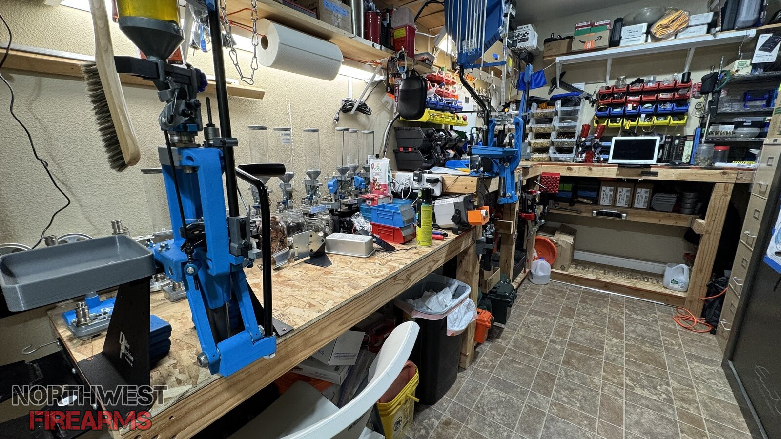

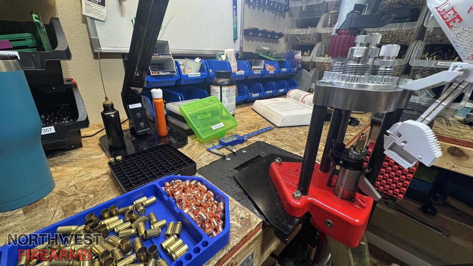

Have a lot here that's seen and not seen. What's not seen are the quick change plates for the presses mounted into the bench. I can have all 5 presses out or only have the Dillons (they are hard to stow). 4 quick change mounts, everything was done for planning.
Bench slopes 3/8" towards back wall so anything rolling won't roll off the bench. 4x4 posts and leading edges. Almost zero play in the mounts and presses. 2' depth of bench, it's enough to comfortably reach the back wall and have a whiteboard that's usable without reaching.
Room under for ammo can storage shelving as well as holders for the turret heads. Have the Dillon tool heads mounted to the wall on the low bench with a rack system. Allowed lower bench to serve as a taller sit down bench but allowed tool heads to be complete when stored and out of the way of the overhead shelving (low enough).
It's rough but it's purpose build and strong.

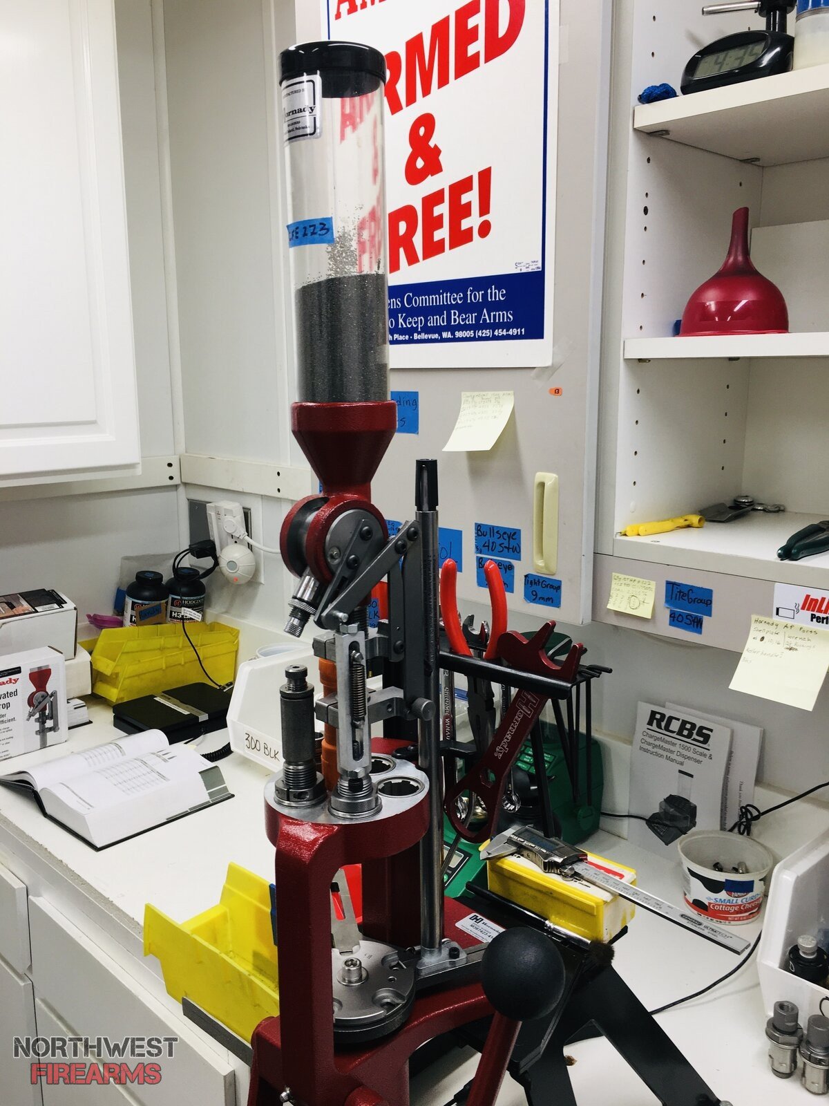

With your bench height Bobbygun, that's ok for sitting. Inline fabrication makes elevated metal press stands if you want to get a press up higher in order to load standing. I have never used Inline Fabrication's products, but others have and have good things to say about them. I have seen plans online for homemade stands as well.
