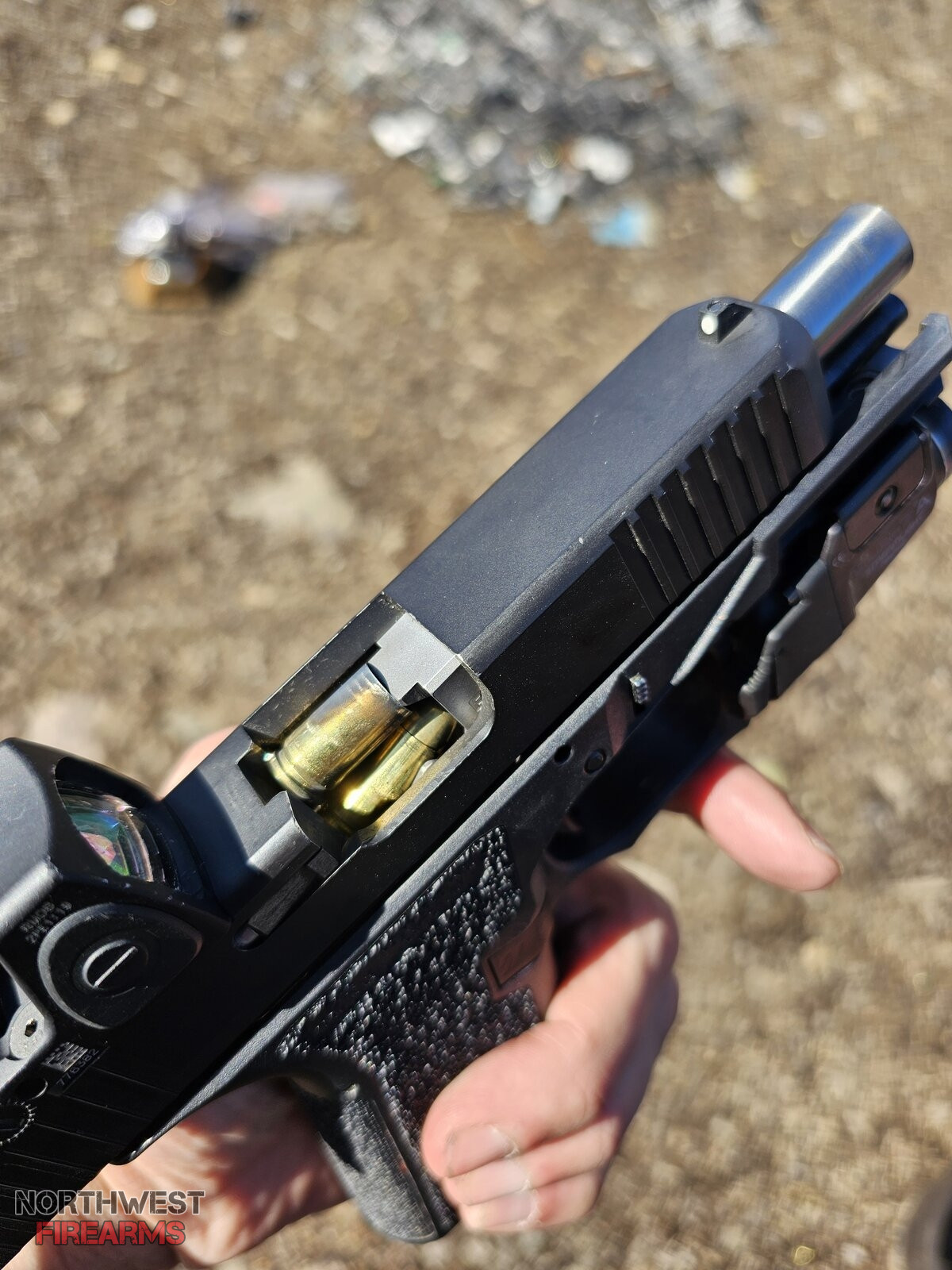

Generally speaking can stovepipes be caused by too strong recoil springs? Would a slightly lighter recoil spring fix the issue? Could it be a worn or weak extractor?
Specifically this...
details:
P80 PFC9, 115gn FMJ 9mm, 18lb recoil spring.
Looks to me it extracted, but didn't eject. One thought should all else seem right;

Its random occurrance, maybe once every 75-100rds. Otherwise runs fine. So I dont suspect the ejector... which is brand new on this build.
So it is possible that the slide is not recoiling enough to clear the spent case, but more likely it is your extractor is worn. That looks like a fairly modern pistol (a bit glocky, but I never keep track of all the clones that are out there), which means it likely has a blade style ejector. Unless that is worn down to a nub or missing entirely that is likely not the problem either. A worn extractor means that the ejector does not flip the cartridge out to the side, but knocks it more forwards into the action. Check to see if your extractor can hold onto a cartridge with no help. If it cannot it is probably too lose, thus leading to the ejection failures.

A most common cause of occasional FTE/stove pipes I have seen is limp wristing.
Probably not what you want to hear.
If those are not reloads (if they were, need hotter charge… brass did not fully seal chamber… see soot on side), it is probably a combo of additional mass of RMR plus a spring weight that works well for 45acp, but is a little heavy for 115's. I would buy a 15 and 13lb spring and try those. You are not getting full lockback. Limp wristing a Glock will do the same thing.

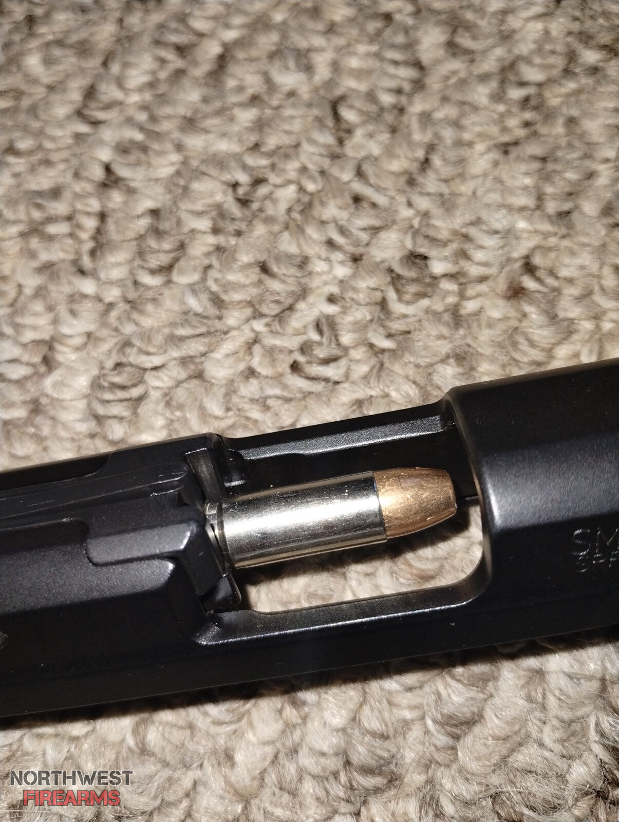

It holds. At least against gravity alone.

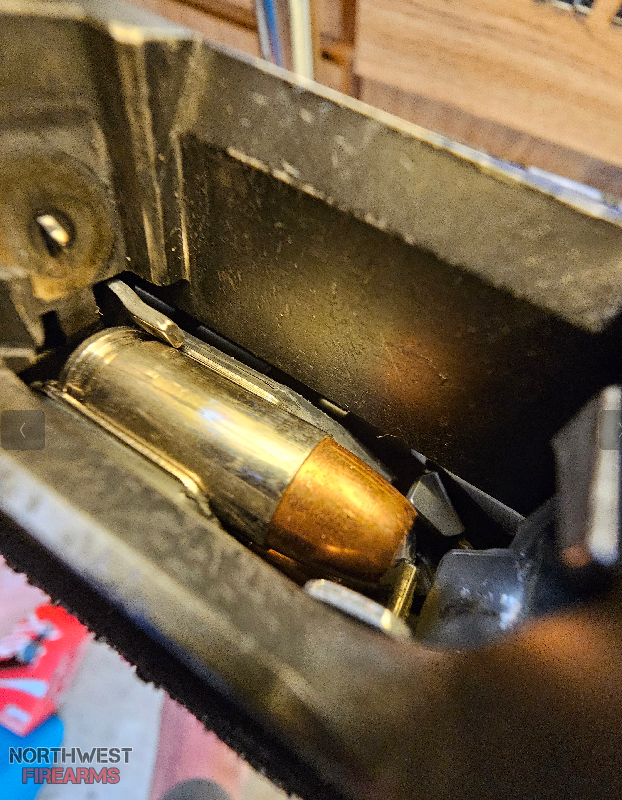

Does it pass a shake test? What if you change orientation? The cartridge should be held decently tight in that position. If it just barely holds until you move it that is no good.
This one has a tight hold. I can toss it around and the cartridge will not fall out. It takes a decent smack to dislodge it.
Orientation?
When I put it in position of full battery it holds tight. When I put it in position where it goes once the slide unlocks just before extraction it holds, but will eventually work itself out with enough shaking.
I think my extractor is good?

I can toss mine around like a baton and it will hold onto the cartridge. Only a good smack will dislodge it. It does not have to be that tight to work right, but it does need to be tight enough to hold onto the shell until the ejector peels it off. From the rest of the comments I think I agree that it is limp wristing, if it works well for the first half dozen mags in a string and only fails on the later ones it probably is not anything mechanical with the gun. If you got a random failure occasionally at the start of the string (and you are sure you were not being lazy/fatigued) then maybe look at the spring. But really it is almost never the spring, as most guns will run totally fine even with an overly heavy spring so long as the bolt travels far enough back to pick up a new round and the ejector is long enough. Your image showed a stove pipe with a new round picked up. It should have cleared that case, unless a limp wrist let the gun keep up with the fling and eat it again (assuming all the other mechanicals are working right, which seems to be true).

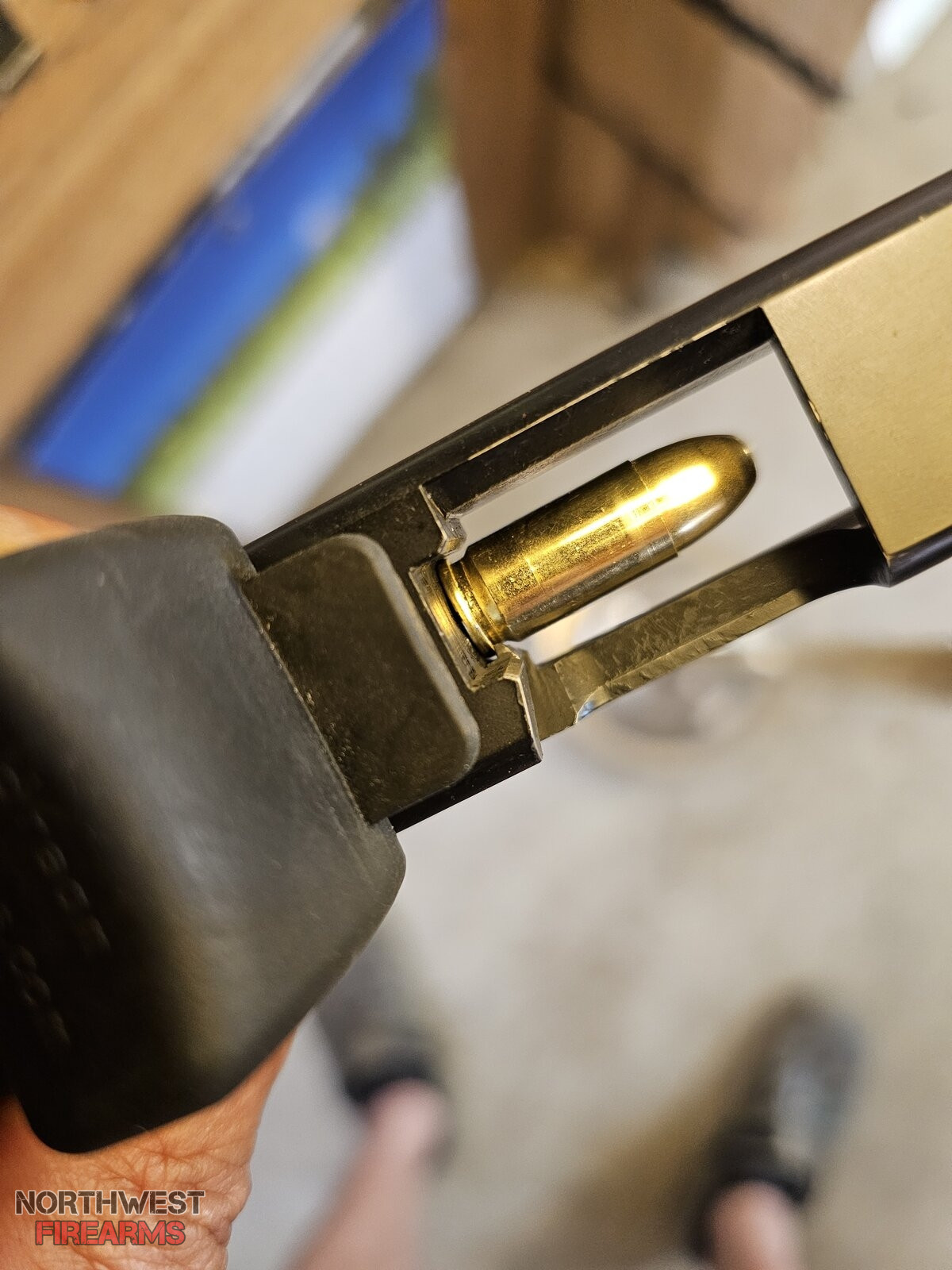

This does bring me to the last possibility I can think of for a mechanical issue. If you have a strong spring/short ejector combo that is juuuust right it may cause reliability issues on a weakish grip that might not be a true "limp wrist." Figuring out if your slide just barely grabs a new cartridge is hard to do without a decent camera, but checking where your ejector is assuming you gun does that is much easier. A blade type ejector really should come out over the back of a new cartridge by an eighth of an inch or so, or the entire length of the rebated rim up to the start of the case wall. If you do not have that much ejector you may be getting weak ejection, which would make the gun's tolerance for limp wristing much worse.
You can see how far my ejector sticks out over the back of the next cartridge. If you have less than that you may have a more finicky gun when it comes to grip strength.
The position most people put the sample round in for this test is much different than the position the round is in when its being contacted by the ejector. This makes a difference in the test.
My ejector is new, Im intentionally running a gen5 ejector in my gen3 architecture (yes this works and not the issue), not only does it protrude well over the case but the Gen5 tip is bigger to engage the round.

Gen5 ejector

Gen5 ejector
Yep that does look like a good long ejector. I am not sure the weaker spring is going to help you as by the time the bolt face gets back far enough to pick up the new round the old case should be long gone. Pretty sure your problem is getting little girl wrists after popping a few too many down range. At this point I am going to need a good high speed camera if you want to convince me otherwise :s0140:
