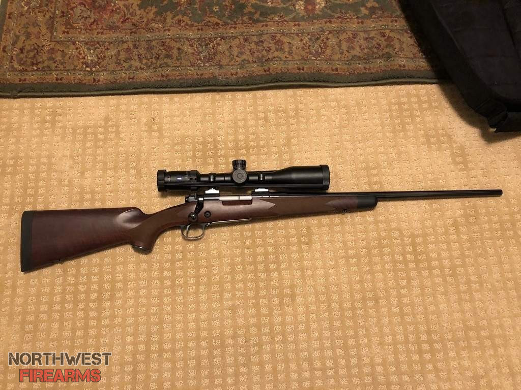

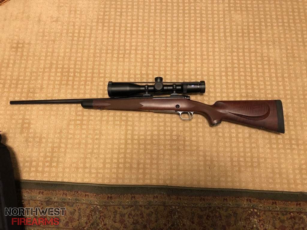

OK, latest report from Velzey. You guys are not going to believe this! I really think there's a very good chance bsa1917hunter is going to owe me that beer. :D
Hello David,
I will give you a call shortly. And answer your questions. I had to get shooting in early to beat the rain. I went down to Douglas Ridge.
New Timney is wonderful, set at exactly 1.5lbs
Your not going to believe how well it shoots. Here is a sample.
This is a 4 shot group, from a sandbag rest at 100 yards.
As you can see, we decided to go with the Timney set at 1.5 lbs. Everything else is factory - including the ammo!
Now, do you think I'm a very, very, happy camper? You bet!
So here is the rifle with scope - all done! What a beautiful and extremely accurate rifle! The wife and I couldn't be any happier. :D And the mounting job is absolutely perfect! You can't even begin to imagine how happy we are with the work Velzey did - he is truly amazing!
