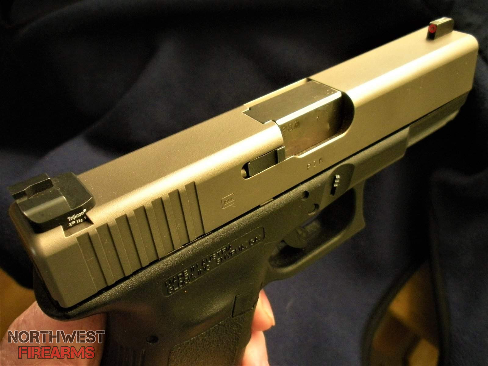

Has anyone gone down the NP3 path? I'm considering it for a 1911
I bought a Glock with something like that on the slide and barrel.
And it don't rust.
