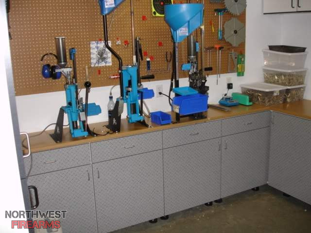

I have mine at 36" standard cabinet height but mine are on strong mounts. You can shorten the case feed tubes for a lower ceiling. I can stand comfortably or sit in an adjustable stool I have.

Thanks for the photo. The 650 I'm using is on a strong mount, so I think having the reloading bench at 36" to match the adjacent workbench would be best.

My bench is at 36" and I have the Dillon 550 on strong mounts, I can sit on a stool or stand.
The other part of 36" I like is the press is near one end then I have several feet of work area, for cleaning guns, and dis/assembly.
