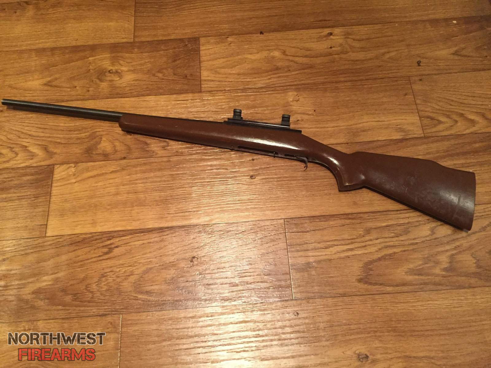

I have an old Rem 788, shoots well, but the stock is ugly. so so ugly. My father bought this rifle back in the 70's I think. Ive been tossing around the idea of refinishing it myself. Well because I want to, and pulling it out of the closet brings back memories of the old man, I remember when he had my grandfathers stock refinished, and it from truck beater to prod to have it hanging on the wall piece. I don't see any value for me in keeping the stock "original" although the gun is oldish... about my age... i don't see it ever becoming any type of item where the originality would matter.
I don't really have a "well ventilated" space to work in... (stupid apartment city living)... is there a poly/stain remover that won't kill me indoors with only a window fan running?
Is that what I'm looking for a Poly/Epoxy/Stain remover?.. (I've been to several hardware stores to investigate products they sell) so far Bi-Mart had the one i think i would need , Jasco something varnish/stain remover... but I've read that gels work better than liquids because they stay in place better.
first i want to get the old coating off, then see what i have underneath... Im leaning towards sanding, then hand rubbing in a boiled linseed oil, and calling it done, but it its ugly under the glossy finish also... i just settle for some sort of paint job. and try my hand at some camp type stenciling.
ideas / suggestions / especially regarding the remover, or possibly other avenues i haven't considered yet ---
Please and thank you.

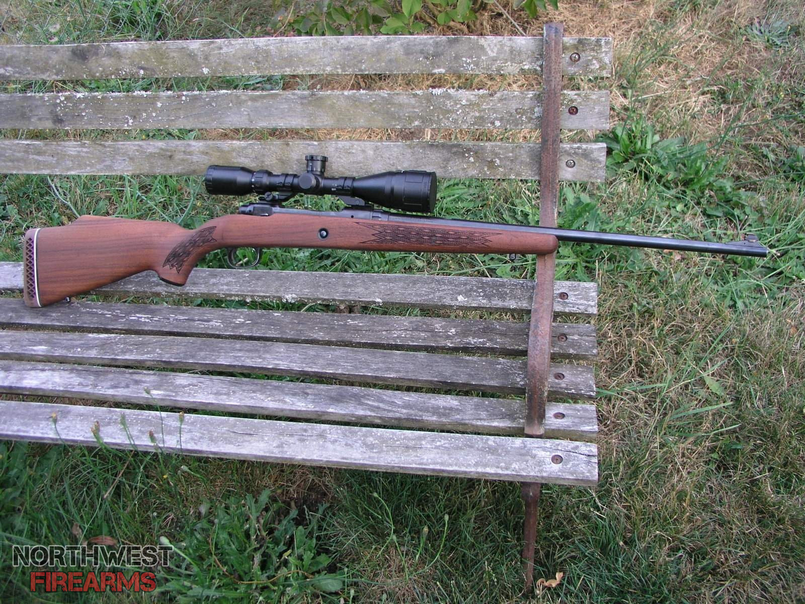

This rifle had a thick coat of shellac or some awful stuff.
I just sanded. And put on about 5-10 coats of BLO. [Till it glowed]
The burned wood areas were a pain to avoid..
This modern gun was way easier than the old WWII and Winchester rifles I'm use to.
I didn't have to stain it. And get the color just right.
Damn every time you post a picture of that thing I drool!!! You did a beautiful job!!

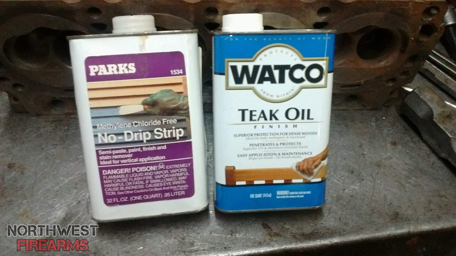

I don't know what wood you have, but on a 788 I wouldn't be surprised if it's birch. I bought a pretty ragged Savage a while back and refinished it for my nephew. Being the packrat that I am, I still had the cans I used.

If you have checkering to deal with, I went lightly and didn't really scrub the checkering because I was afraid to damage the points. Because I did it that way the checkering panels are a bit darker.
Here's how it turned out.
The teak oil gave the stock a reddish/brown color that I really like. I suppose a good clear oil finish on it would give the finish some gloss.

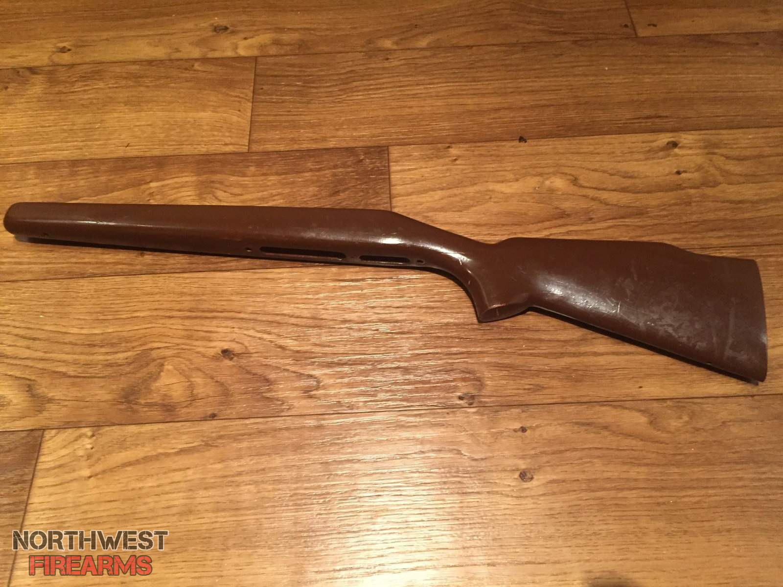

Pre photos.... I went and bought some of that citrisstrip stuff, put it on tonight well see how it is in the morning. i don't know if its worth it but I'm thinking about hollowing out the barrel cavity in the stock some more attempting to free float it. (you could see areas on the barrel that appeared to be rubbing and the barrel cavity was not smooth at all. but i think in turn that would mean trying to do some kind of glass bedding (maybe just the lug because I've never done glass before)
i know I'm getting ahead of myself here, but if i were to just glass bed the lug space, then wanted later to try the whole action. can you put one layer of glass onto of another, (will it bond to itself?) or would i have to extract it all to bare wood again and try the whole thing)?
anyway thank you for your input, ill try not to be shy and post photos of my mistakes too..
when i get it all stripped ill try to take some good photos and maybe you can tell me what kinda wood it is... i can't tell by the grain pattern (not that i could see it anyway)
