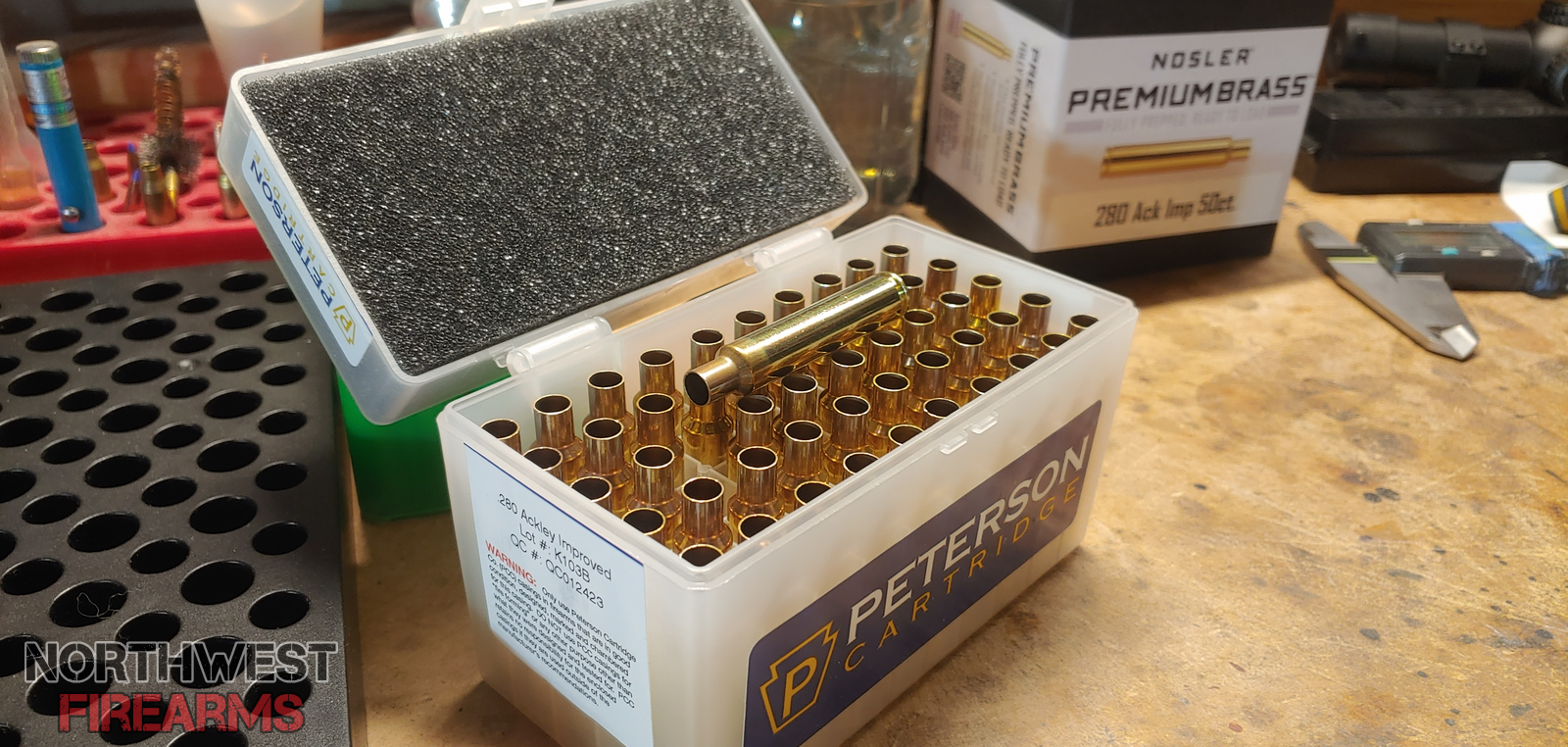

Supply chain issues has been my biggest hurdle in learning reloading since I started 2 years ago. I have dozens of email notifications still unfulfilled and have had to settle on almost all components. Last week I found out Grafs has Petersons brass in 280AI.... and a heavy weight of cognitive dissonance set in, as I had invested in 100 pcs (not cheap at all) of Nosler "Premium" brass and have a recipe with those delivering about 3/4moa... why change anything now. Long story short a few days of cognitive dissonance went by and I caved and bought 150pcs (again not cheap) of Petersons brass. So now I will find out.
New unfired, I measured 10 samples from each brand.
Peterson, average: 202.1gr, Extreme Spread: 0.7gr
Nosler, average: 178.34gr, ES: 1.9g
Question: how many grains of powder charge would you drop back to start over load development with new brass?
I'd say use the same charge and loading steps to establish a baseline comparison.
Then go from there and see what you should change.
You're not worried about decreased case capacity? The Nosler brass is a fair amount lighter which leads me to believe it may very well have more case capacity than the Peterson.
Nope, not unless it creates a compression load, than I'll reduce it. But that's me, do what makes you feel comfortable.

I tested a further out seating in my Nosler brass and was able to safely increase powder by 1.8g and gain velocity. Was going to adjust my Nosler recipe before I found the Peterson brass.
currently I think the safest start is to start over where I started with the Nosler brass. 55 to 58.5 is a 6.4% difference and Hammers dont line up with conventional load data and typically exceed load data.
Did you test the further out without increasing the charge? If so, what was the results?

My current Nosler recipe is 58.5g. 3157fps, 3.345" COAL
I cant recall what my logic was but I loaded a seating depth test ladder but started that at 59g, 3.43" COAL. That gave me 3125fps. I didnt hit pressure until 60.6g 3221fps. My notes tell me to zero at 60.3g/3202fps at that new seating depth.
Little after the fact but you could load up 2 rounds and see what the results show. Might also give you a better idea of how the other brass might affect your results.
Not seeing the need knowing I can increase charge. I might load 3 at the new node to see how it groups and record velocity data.
But Im moving to the Peterson brass. If I had no actual data my research has me starting at the same starting point as I did the Nosler. There's no published load data for Hammer bullets they tell you to start at the closest lower weight cup and core.
mulling this over is there any correlation with the weight difference and reduction difference in charge?
10% reduction sounds reasonable for a weight difference of 13.3%.
There is always the reduction recommendation when changing components. Adding the fact that the Peterson is that much heavier, yes I think this is additional reason to err on the side of caution. That brass has to go somewhere and if the external dimensions are the same for that cartridge I think it's fair to assume the brass is thicker, therefore decreasing internal volume.
