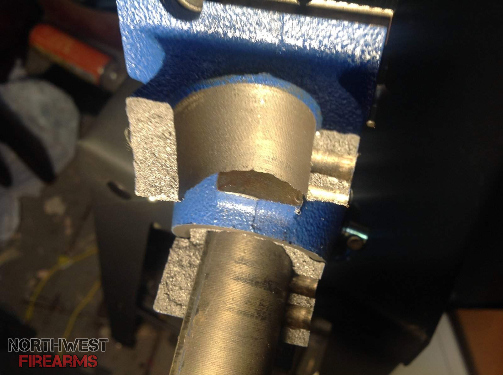

I didn't heat the vice. just the barrel nut... I wasn't even using a cheater bar when it broke. I realized that there had to be some sort of lock tight in there because most AR barrel nuts are torqued between 40&80ft lbs, and if pulling back on it with all I had didn't budge it.. Heat was the only solution. I just heated with a propane torch around the the nut until I saw what I assume was grease or thread locker boiling around the barrel extension. The vice didn't even get warm. I can't say I had all my weight in it because I was sitting in a chair beside the vise which was clamped to a grinder stand.. one hand on the wrench and the other on the stand to keep it from tipping over. I was quite surprised when it broke...After seeing stuff boiling out the back I assumed I had released the locking compound and it would break free easily, so I wasn't even pulling that hard on it.
I've tightened and loosed several barrel nuts in this vice without any problem before this. I don't know what Ruger puts in there but it's some strong stuff.
Well I put on a football helmet, and a had at it agian. this time with the 4" Craftsman vise I have out in the shop.
Ya.. I should have done in the first place, but it's cold and dirty out there and I didn't want to put pants on last night... and it's nice and comfy in my gun cave. Won't be making that mistake again though... I'm gunna install a bigger vice in the gun cave so I can work pants free... and have the right tool for the job.
As I figured, it really didn't take a lot force to brake it free. there was definitely some sort of super duty thread welder in there that needs heated to release. A shorty 1/2 ratchet and about a 10" piece of cut off 12 guage barrel as a cheater bar(together about the same length as a standard 1/2 ratchet which I couldn't find) and just a little tug, and it came right off.
I will be getting another one of those vices believe it or not... it rotates on 2 axis which is super handy for building lowers. well worth $20. maybe if I show them my wound I'll get it for free. I just won't be using it for anything that involves any kind of force.

Does the metal seem weak on the inside of the casting?

Yes the metal seems very weak inside the casting.. cheap chinese pot metal... and since it rotates on a second axis, it has extra holes drilled in the side for the locking screw... weakening it even further.
It's great as a third hand, like I said before, but that's about it. Now were it machined from good steel, It would be just fine. you can tell from the picture it looks like compressed sand where it snapped...
It's great as a third hand, like I said before, but that's about it. Now we're it machined from good steel, It would be just fine. you can tell from the picture it looks like compressed sand where it snapped...
