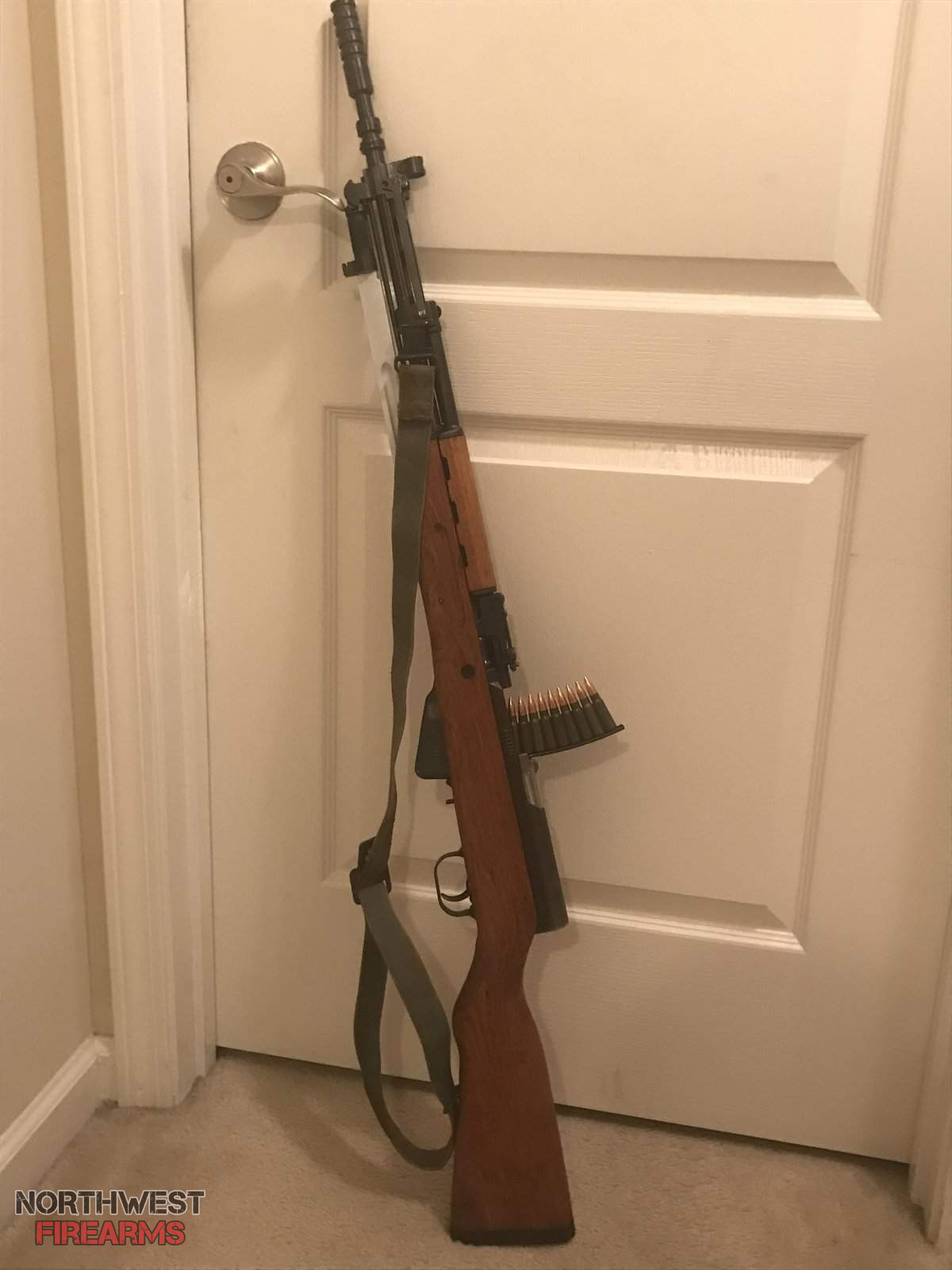

That has a hollow place in the stock for the bore snake as others alluded to above? I wasn't aware. Still, I'm too old for war and prefer other toys for hunting.
There is a hollow hole for a cleaning kit. Solvents are supposed to be in a can in a leather pouch. The SKS makes a good hunting rifle. If I get another rifle with a wooden stock I'd probably shave a hollow hole for a bore snake.
