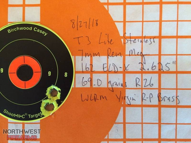

I went to the range today for a final choice and zero verification. Which, oh which, load to choose? The tried and true 160 Accubond and 3,000 FPS, or the upstart 162 ELDX with it's shiny new "heat shield" tip (cough A-Max cough) and ballistic coefficient advantage? Not to mention that I killed my best bull to date with a single shot last year, and I already load the same for my brother, and I have 800 of them already, and...
So it's obvious which way I was leaning. But accuracy is (almost) everything, so who wins?
From my last range session the scope was zeroed for the AB. I looked at the ELDX target and adjusted the scope to zero for the ELDX before I fired a shot. Windage was good but I got aggressive with elevation. Just two shots, I know, but at 80 degrees or more the barrel takes forever to cool.
Down two clicks. Fire two more, different target.
The top group is .261", the bottom group is .088", but exactly 2 clicks below the .261", so I can't cherrypick. I'm calling it four shots in .261" and I don't care what @Stomper says. There's accuracy and precision right there, I don't care who you are.
Accubond was up next. Leaving the zero where it was, I figured the AB load would be three left and two up. Well whaddya know.
I think I'm done. ELDX wins, but AB is a decent backup.
