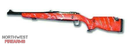

For some reason it reminds me of the canadian search and rescue rifle by Ruger. sar-rifle-30.jpg
Something about a shorty bolt gun really piques my interest.
Me either, I first heard of it when researching long vs short action ruger "boat paddle" stocks. Apparently it's not actually built by Ruger but it is a Ruger 77 action in a diemaco chassis. It's difficult to be sure as I haven't found alot of information on it. From the one site that did list specs it has a 14.5" bbl, folding stock, five round mag, 30-06 chambering and provisions for ammunition storage in the butt.

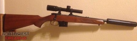

Sounds like what I did to one of my Tikka's in 223. Didn't SBR, but 16" with a 6" can still pretty dang handy. Went with a Leupold Delta Point Pro for the optic. Makes for a fast handling, quiet carbine.
Same rifle in Avatar pic.
