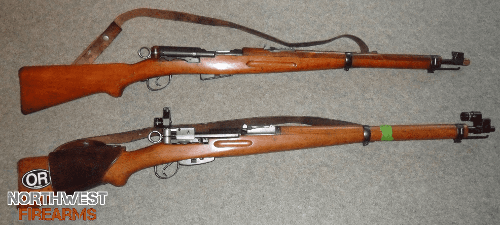

Ten years ago my m/96 cost me the equivalent of ca. $850-900.
Both my Swiss carbines - the K31 and the K11, were on the rack in a USAF base R&GC, and I just lucked into them - how they came to be here in UK is a complete mystery but I'd guess that a US serviceman brought them here hoping to be able to use them, and somehow ran foul of the legal system that prevented him from taking them off-base and into the community. The management of the R&GC were never going to say, as all commission sales were confidential, but neither of them have import marks on them - anywhere. They had to go through the process of being proofed before I could actually buy them, yet another barrier in the way back then. Nowadays EVERY milsurp firearm is proofed automatically - something the importer has to arrange.
For Mike - sure, we CAN refurbish a piece that might have it appearance enhanced by doing so, and a lot of people actually do. Birchwood-Casey does well here in UK. but don't forget there are many native-grown unguents and refinishing stuff - has been for hundred of years - that sell as well. Every gun show here, and game show too, has a demo stand where skilled stock finishers show how YOU too can get that professional-looking finish... Watching the man from Holland and Holland a couple of years ago, making a $100 Boyd stock look like something to grace the gun rack of HMtQ was a lesson I'll never forget.

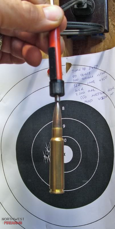

This is five shots with 155gr Lapua scenar at 100mfrom the K31 -
This is another ten shots from the same gun - 168gr SMK bullets - the haze is rainfall.....

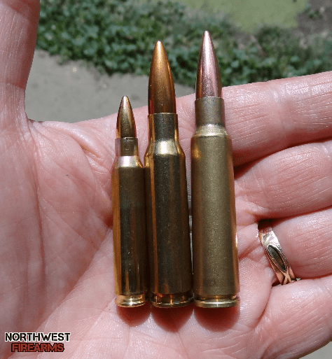

And here they are for comparison - L to R - .223 Rem, .308Win, 7.5x55 Swiss - note the ultra-long ogive on the Swiss round.............

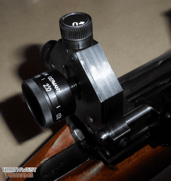

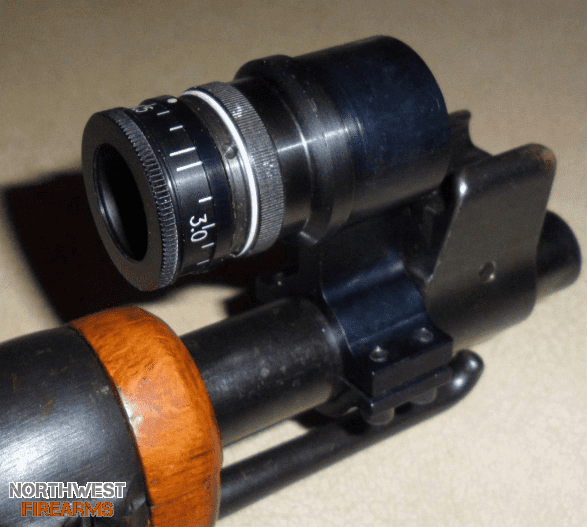

This is the slightly older Swiss Products diopter sight set-up, if anybody here in interested in that kind of thing -
Rear - note the sliding spacer set-up -
Front - note that this has an optional Gehmann infinitely multi-adjustable diopter foresight element - that's around 120eu by itself.
Here is the older, non-adjustable-for-eye-relief rear sight unit -
This set is now in New Zealand.....
The Most-up-to-date unit has an adjustable height foresight unit of great beauty, mechanically, just the kind of thing you'd expect to see on a Swiss rifle of any kind, let alone an old milsurp item. Prices have taken a serious dive since Swiss Products severed partnership with Brownells and Grafs, and are now considered to be on a par with the best that Germany and Switzerland can offer, with the added benefit that the SP sights go up to 1000m, whereas the homegrown versions are only really any use for the 300m that the Swiss shoot.
IF you do make contact with SP, please mention my name - it can't hurt, right?

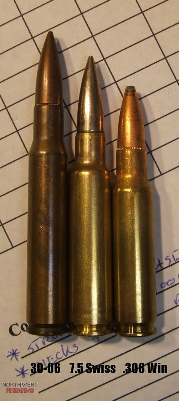

The 7.5 Swiss is an interesting cartridge. It has features that echo other notably
accurate and powerful rounds over the last century. Its case is shorter, stouter,
and quite tapered when compared to it's contemporaries. The sharp shoulder and
squat powder space reminds me of the 'Ackley Improved' series. P.O. Ackley thought
we could take most standard rounds and make the shoulder sharper and the powder
room a bit bigger, instantly improving performance. In almost every case it worked.
The 7.5x55 might have been built by Mister Ackley. It's every bit as powerful as
the 30-06, while also having the easy to find accuracy of the .308. In addition,
it functions smoothly with the unusual straight pull K-31 action.

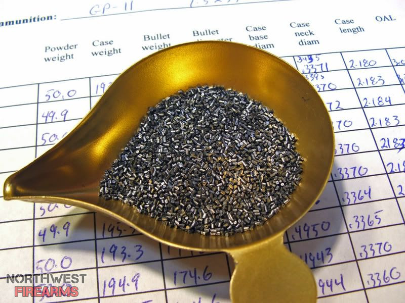

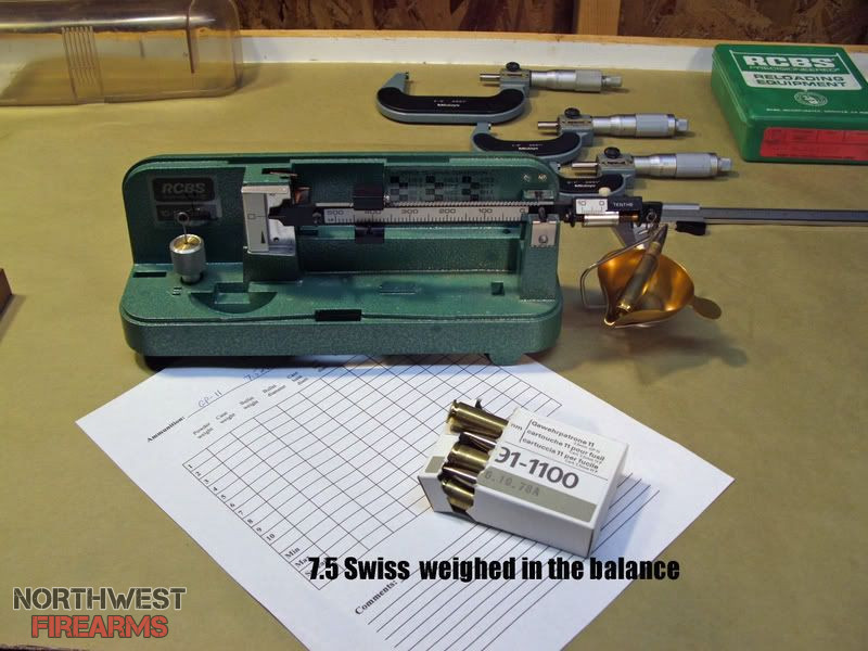

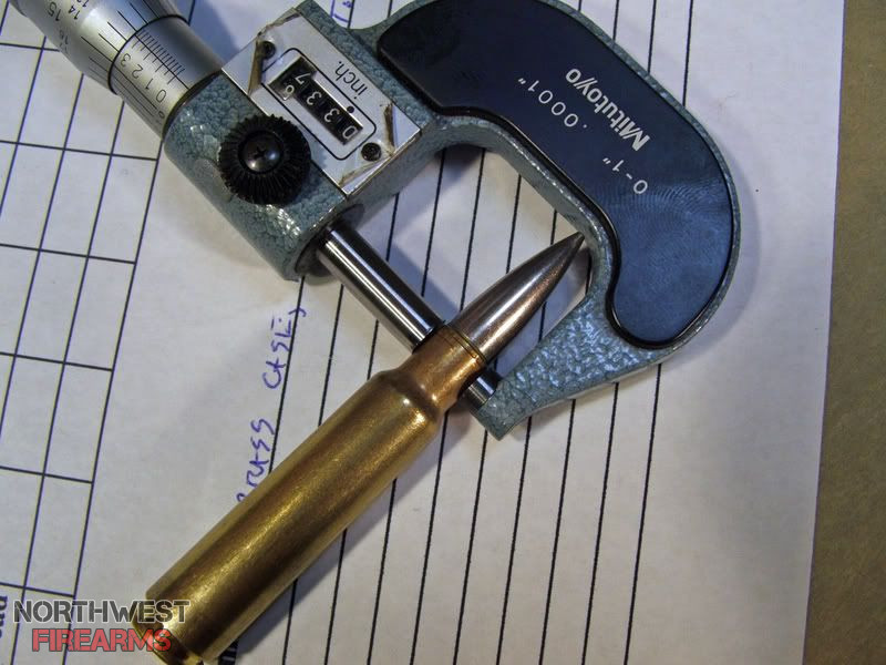

As usual, the measuring arsenal includes an RCBS 10-10 scale, Mitutoyo micrometers,
Central vernior calipers, some other assorted goodies, and a large cup of coffee.
Starbucks beans, ground at home, drip type coffee maker. A shlop of cream
in a big cup, and we are good to go.

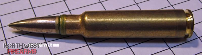

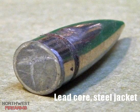

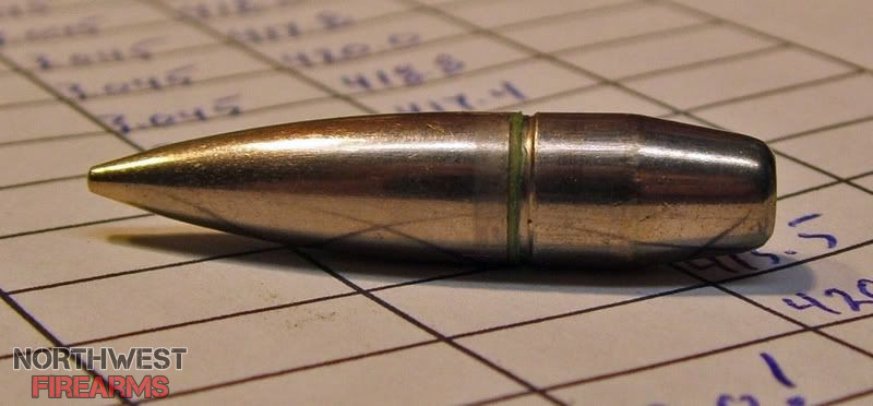

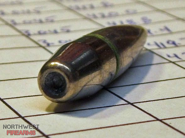

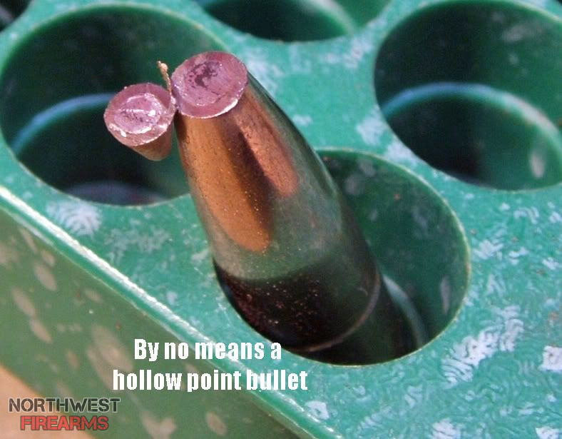

GP-11 7.5x55mm is brass cased with a magnetic steel jacketed bullet. The bullet
core is solid lead with no voids, and seems very well bonded to the jacket.
Several bullets were sacrificed to the cutting wheel (monkey curiosity strikes again!).

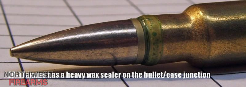

A feature of the GP-11 noticed by most people immediately is the unusual sealer
applied to the bullet/case junction. Unique in my experience, the Swiss painted
on a heavy band of wax. While it's not uniform by any means, the sample I looked
at had wax about .012"thick and .030" wide.

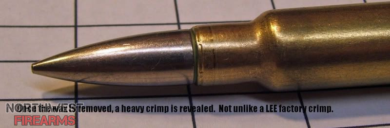

This wax seal was easily removed with nothing more than a rough towel and a bit of pressure.
It's a soft wax, even 25+ years after it was applied. Once removed it revealed
a very heavy bullet crimp. Looking for all the world like a 'LEE factory crimp' its
a very firm and uniform crimping of the case into the bullet cannelure.
Many precision shooters swear by a crimp to encourage consistent powder burn.

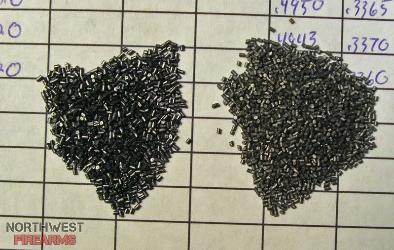

The largest variation was found in overall loaded cartridge weight, mostly due
to the non-uniform wax sealer. Weight spread was 415.5 grains to 420.2 grains.
About 2.2 grains of that can be accounted for with case weight variations, and
another 0.5 grains in bullet variations. The rest seems to be the wax.
Over all length measurements were the most boring of all. It measured 3.045" Exactly.
No variation, *0*, Nada, Zilch, Sigh........

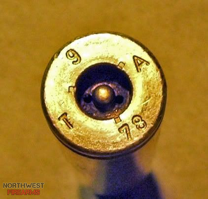

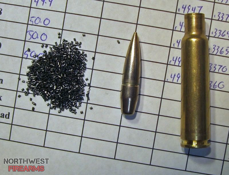

Case base diameter measured from .4941" to .4952", a .0009 variation. The horror
of it! Almost a thousandth of an inch! Those crazy drunken Swiss!
Case neck diameters ranged from .3360" to .3372", a variation of .0012" This
was of course measured after the wax was removed. The variation seems to be
due to the very firm crimp distorting the case slightly. Still minimal by military
ammunition standards, and certainly not bad at all by commercial standards.
There was almost zero variation found in neck diameter. They were round.
Case length began at 2.180" and ended at 2.184", a range of .004. This measurement
found no wild fliers, but was spread evenly across the range.
Tearing down the ten round sample, we find this:
The bullets pulled from the case with extreme force. The first one took four attempts,
till I realized a 'pull' was not going to do it, and a 'jerk' would be required. (Please
hold all jokes till the end of the article!). Even so, many bullets required two or three
attempts to get them out of the case. Not because they are glued in, but simply
that very heavy crimp set deep into the cannelure.
The powder appears quite fresh. It's an extruded grain not unlike IMR 4895, but with
a shorter grain. In grain size it looks like AA2015br powder, but has the same shiny
coating 'look' that IMR stick powders have.
Powder charges weighed in from 49.9 grains all the way to a whopping 50.1 grains.
A 0.2 grain variation. You graph it, I'm going to take a nap.
Once pulled down, cases were weighed. They ranged from 193.2 grains to 195.5 grains.
This is a variation of 2.2 grains, and the largest spread of any single component.
The cases were mirror bright inside. Berdan primed, the twin flash holes were very
clear in the flat base inside the case. Looking at the pristine flat base inside the case,
a question came: How in the world did the Swiss form the anvil for the Berdan primer
while leaving the inside of the case flat?
Using the wildly dangerous torch trick to blow out the live primer (nothing too dangerous
in search of data for our readers!), an extremely uniform primer pocket was found.
In fact, the pocket appeared to be milled rather than punched. If so, this is incredible
precision and care for a military round. The flash holes also appear to be drilled
rather than punched. Stunning quality and meticulousness for a military round!
The bullet, as stated, is a steel jacketed number with a lead core. Full metal jacket
with a strong boat tail. Weights ranged from 174.3 to 174.8 grains, a 0.5 grain spread.
Most notable were the diameter variations: Only .0004". The bullets measured from
.3076" to .3080", and were perfectly round. No variation at all in diameter was found.
