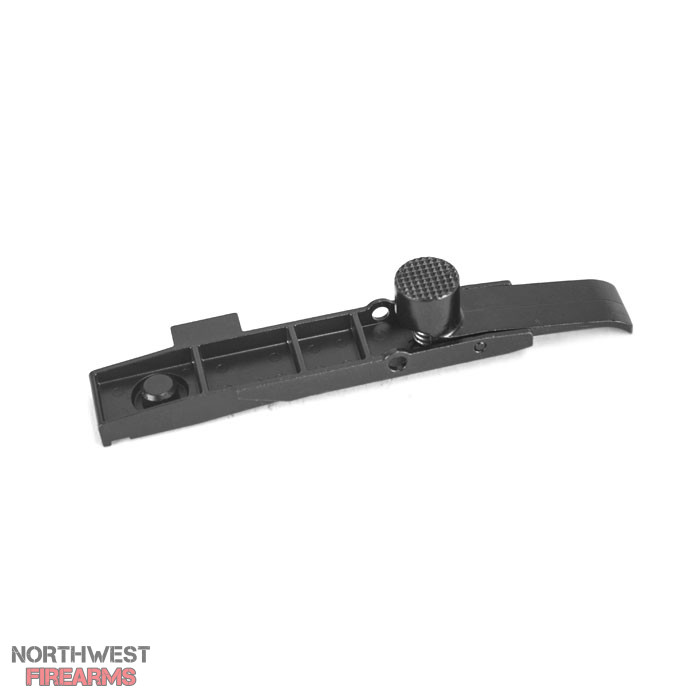

I've got myself into trouble installing a new bolt release on a Mossberg 930 JM Pro (https://www.gggaz.com/mossberg-930-tactical-bolt-release-pad.html). After install, my shell stop is able to release two shells when the bolt release is depressed while the lifter/elevator is in the down (closed) position and bolt closed. Prior to install, the shell stop did nothing when the bolt release was depressed with the lifter/elevator in the down (closed) position and bolt closed. If I reinstall the original part (#15-21) or replace with OEM new parts (#15-18, 21) I have the same issue. Thinking I'm doing something incorrectly during assembly but I'm unable to shake the issue despite reassembling in many different sequences and throwing new parts at it.
