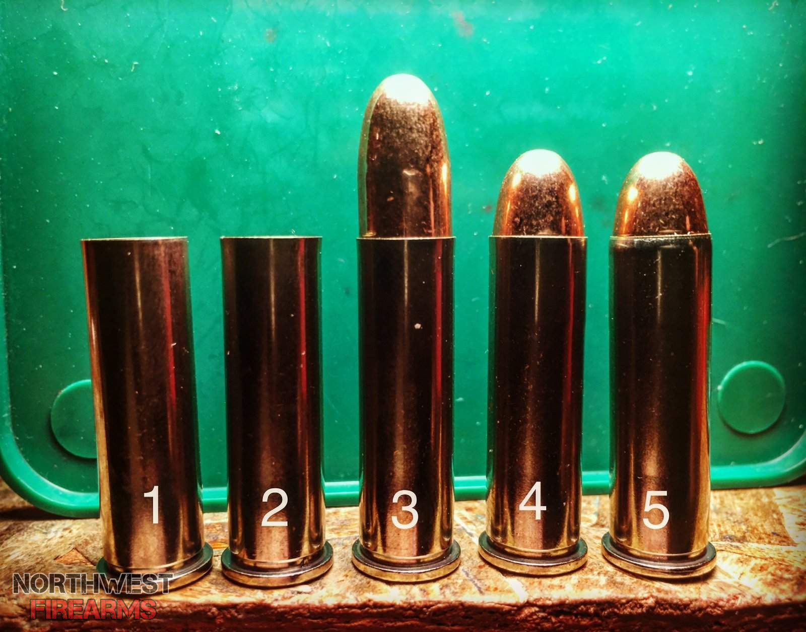

The below image shows just how little crimp and belling is needed. I created this a while back for my Instagram account to show the differences in the steps.
The rounds shown are .357 Magnum and use roll crimp and not taper crimp. The concept is the same though with amount of flare and crimp. Overdoing case flare/belling will result in cracked cases and overworking the mouth of the case leading to cracking when fired. The idea is to use 'just enough' to get what you need done without going overboard.
#1: case unmodified
#2: case with bell/flare added so Bullets starts to seat properly
#3: bullet should sit inside case a little bit. On this setup the bullet is actually nested .110" inside the case.
#4: bullet seated to near proper depth. Because the die crimps AND seats the bullet you cannot fully seat without crimping in one step, that's why it's not fully seated.
#5: seated to proper depth and enough crimp is added to remove the earlier case belling as seen in photo #4 & #3. The top of the ram is where the die is dialed in for the crimp and seating

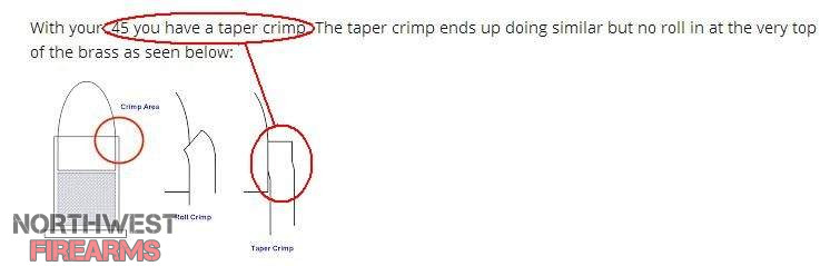

With your .45 you have a taper crimp. The taper crimp ends up doing similar but no roll in at the very top of the brass as seen below:

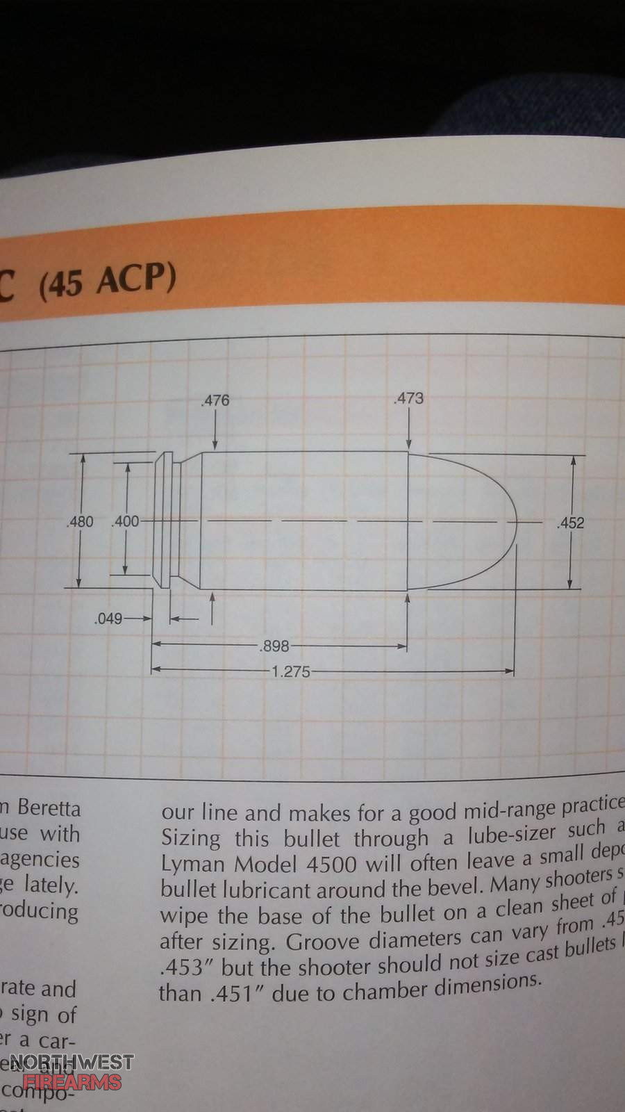

On the cartridge drawing there is a measurement at the mouth of the case. In this case it is .473 for 45 auto. After you crimp measure the case mouth with calipers. .45 auto usually crimps between .473 to .470. That is about where you want to be so the case mouth headspaces in the chamber properly.
