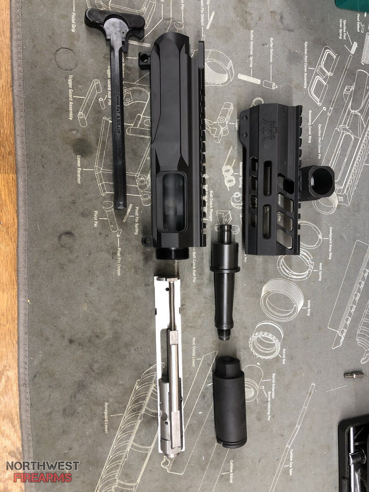

I don't have any of that fancy aero shell grease I see people suggest for the barrel nut when building a rifle. Will any grease do? Or do I need to use a specific type of grease to keep the threads from seizing? What are your recommendations?
I've use high temp lithium grease used for bearings and it's worked fine. By worked fine, I mean to say that I've put several thousands of rounds through after installation and removed the barrel and nut and swapped the barrel with no galling of sorts. Avoid any type of anti seize that would cause galling between a steel barrel nut and aluminum receiver. If you can get your hands on Aeroshell 33MS, that is a sure bet.
Would something like white lithium grease work?
