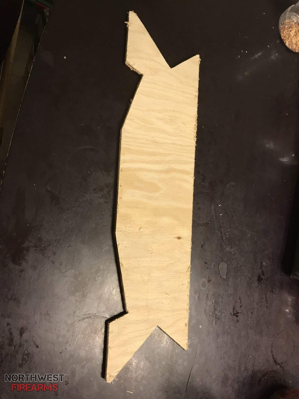

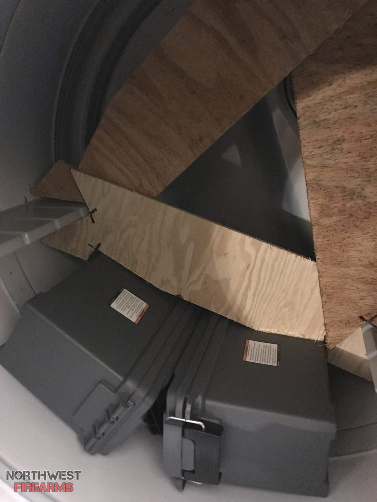

right now, I set it up with dry tumbling. Wet tumbling would work too if you have water tight containers.

I give you an A+ for ingenuity and crafting!

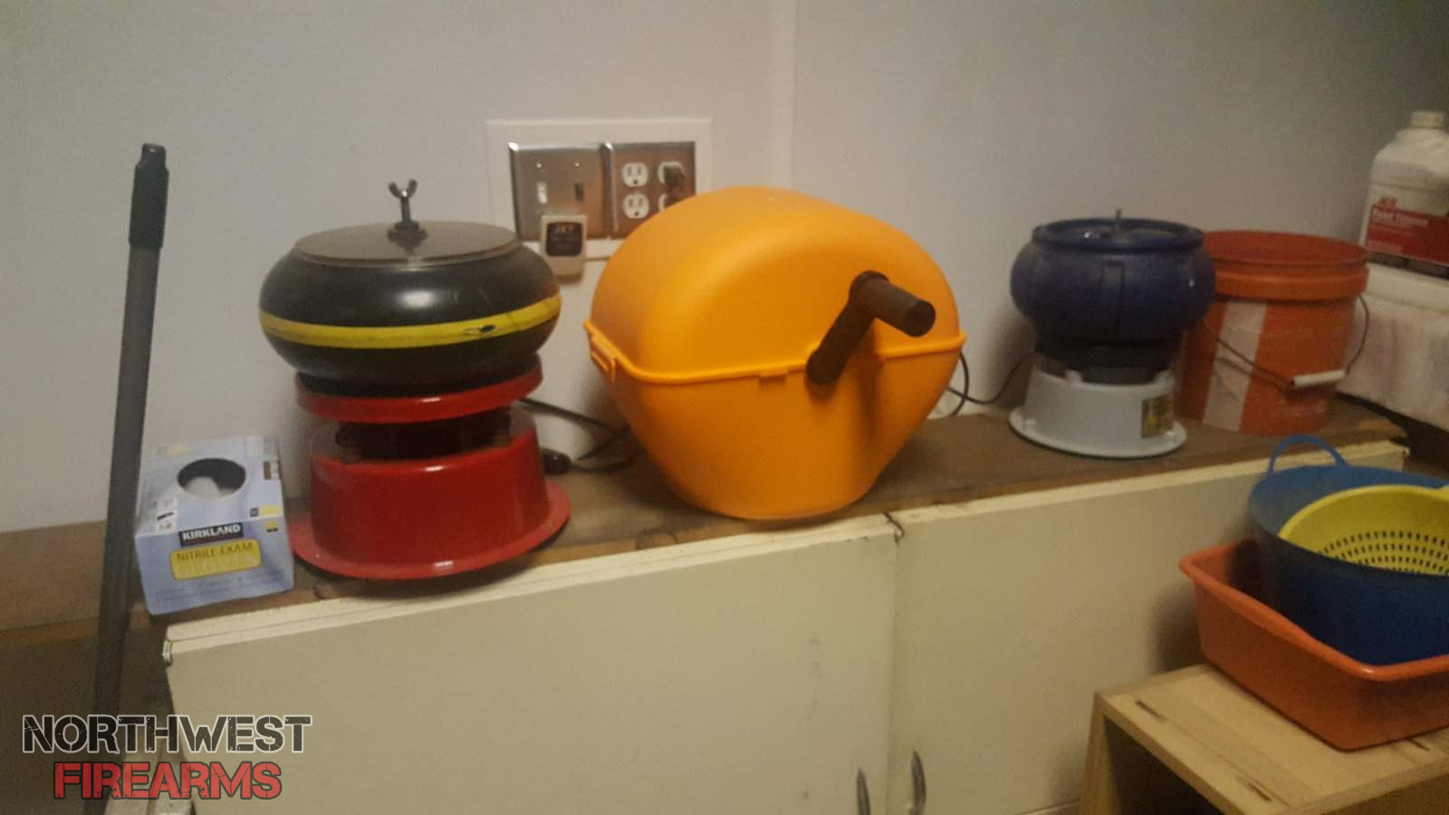

I don't have that many cases to Tumble at one time. Although I do have a big thumblr tumbler that has a lot more capacity than the puny ones....
If I buy a new tumbler, I don't know where to put it since my house is packed with stuffs, especially I am getting lots of reloading gears. After I get done tumbling, I put away everything and those ammo cans will be used to store newly loaded ammo too. If I don't have that many cases, then I use two of those ammo cans and leave the rest empty.

You could probably use a great big container and take up the surrounding space to hold it in place with an inflatable floaty mattress or something too.

Lots of people use this small plastic drummed cement mixer from Lowes that's $199 when on sale.
Shop Kobalt 4-cu ft 0.5-HP Cement Mixer at Lowes.com

...or skip the wood, wrap the ammo cans in a big blanket(s) or even tarps to fill up the dryer drum.

brass is heavy. Spread them out evenly will reduce the unnecessary stress to the motor. Keep them stationary will create waterfall effect necessary for brass tumbling.
