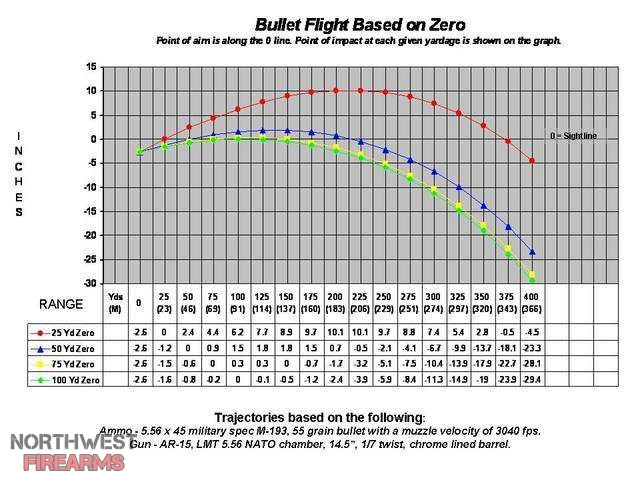

Having recently joined the AR15 club I went searching for iron sight/RD zero..
Wow.. 25/300m, , 36/300 yards, 50/200 yards and 100 yards.
Ballistic calculators are handy and fun to play with to see how the trajectory changes.
After playing around with one for a while I found that a 100 yd zero is good for up to 100 yds point and shoot and a 50 yd zero for up to 200 yds point and shoot with xm193 ammo.
Graphs helped me see the trajectory a bit better as well and where to put the "tube" for my use.
Not mine...
For me it looks like the 100 yd zero would work well as most of my shooting is in the 100 yd range.
For the occasional 200 yd shot it looks like it's 2.4" low, which isn't much of a hold over at that distance. One click is easy enough to remember and put back if you want to dial it in.
So according to this ballistic calculator I found: JBM - Calculations - Trajectory
MPBR based on Mk 262 running around 2363fps with a 5" "vitals radius" is 288yd, recommended zero 247--this looks like a 25/250 is "close enough". Worrying part is I drop below Mk 262's frag velocity at only 50yd... at 288 I only get 1730.

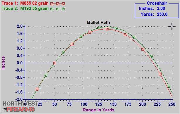

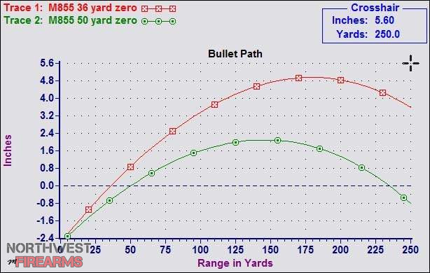

The reason I prefer a 50 yard zero is because it never rises more than ~2" above the POA. With a 36 yard zero, you are approximately 5" above POA at the mid-point, and a traditional 300m military zero puts you 6" above POA.
I don't like the thought of putting a shot over a target, and I hate worrying about when to hold low and when to hold high.
With a 50 yard zero, I'm +/- 2" out to 250 yards while holding dead on, and then only need to hold over from there. Here are some charts to help illustrate:
36 yard vs 50 yard zero from 20 inch barrel with m855 02.jpg M855 vs M193 16 inch barrel.jpg
The top chart is for a 20" barrel, and the bottom chart is 16". These will change a bit based on barrel length and velocity, but not too much. The basic principle is still the same.
This is why I favor the 50/200 yard zero.

The problem is that a 36 yard zero essentially is a 300 yard zero! At the midpoint, around 175 yards, you are hitting 5" above POA.
My rifles are multipurpose, and are more likely to be used on small to medium sized critters, and hopefully never used on 2-legged varmints.
For hunting or pest control, 5-6" high could go right over the target or miss the vitals, where 1-2" high should still be a good shot.
Everyone is entitled to run what they are comfortable with; I'm just trying to explain the reasoning behind my personal choice.

At 36 yards, a 50 yard zero will be about 3/4" low. Either one will work just fine at that distance!
