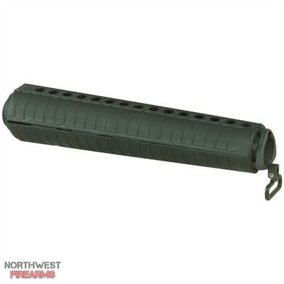

The number one accuracy enhancement for the AR is floating the front handgaurd. IMHO
If you want to keep the "As Issued" outward appearance???:rolleyes::rolleyes:o_Oo_O
The Competition Highpower Service Rifle shooters for many years have use a sleeve underneath
the stock hand guards. Also most add a lead weight. :eek: A little shade tree gunsmithing
cut off sling mount on the front sight so the sling will attache to the float sleeve.
https://www.brownells.com/rifle-par...m16-nm-free-float-barrel-sleeve-prod9943.aspx
