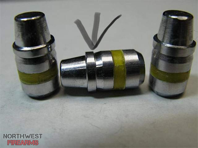

Most revolver bullets have a notch in the bullet for the roll crimp to go into. IE as the bullet is still moving on one axis and the brass is moving in a separate axis they don't interfere.
Taper crimp starts placing horizontal pressure to a bullet still going in a vertical direction.
