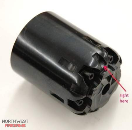

Hey G.G.,
That's what I have, someone redid the finish plumb brown to make it look older, I suspect a re-enactor. They sanded or ground most of the manufacturers name off the barrel, with the right light and a magnifier I can make out most of Euroarms Prescia Made in Italy, but you have to look closely it was a pretty sloppy job. Fortunately they didn't deface it more than that. I got it cheap and wanted it for a shooter, the design is superior to early Colts and I'll feel free to shoot the crap out of it without worrying about the brass frame on my Pietta stretching.
I had to replace the nipples due to multiple dry firings and mixed flash hole sizes. Either the hammer or the cylinder was replaced because the hammer doesn't reach or fit into the safety notch between the chambers, which forces me to have to load only 5.
I wear a size L glove, mainly because I have long hands for my size, it feels almost toy like to me, but all this aside I really like it.
The hammer doesn't have the part that should fit into the recess.
How does yours fit together?
My Pietta has little pins between the chambers that fit into a notch on the hammer face that strikes the caps. Locks up pretty well and for practice I wouldn't hesitate to load all 6.
I don't know if getting a replacement hammer would fix the problem or not, if I can even find one.
If I have to I could take some photos of the hammer and cylinder.
What say you?
Gabby
I just found this one and wonder if yours looks like it?
rm32.jpg Mine did but wouldn't engage the safety notches.
the bottom of the hammer face contacted the cylinder and wouldn't allow it to engage. I beveled it off in hopes it would, but I would have to remove the whole hammer face to do so, so rather than ruin it completely I stopped tinkering!
At least it still shoots. I think if the little top spur that covers the top of the cap was longer it might reach the safety notch. The hammer shown here is $30 when in stock, so I'm not going to experiment anymore. This is what the cylinder looks like in my gun. About the only way I can think of to allow the hammer to engage the notches would require grinding away the web. see photo, that stops the hammer from engaging the notch. I'm not going to do that either.
