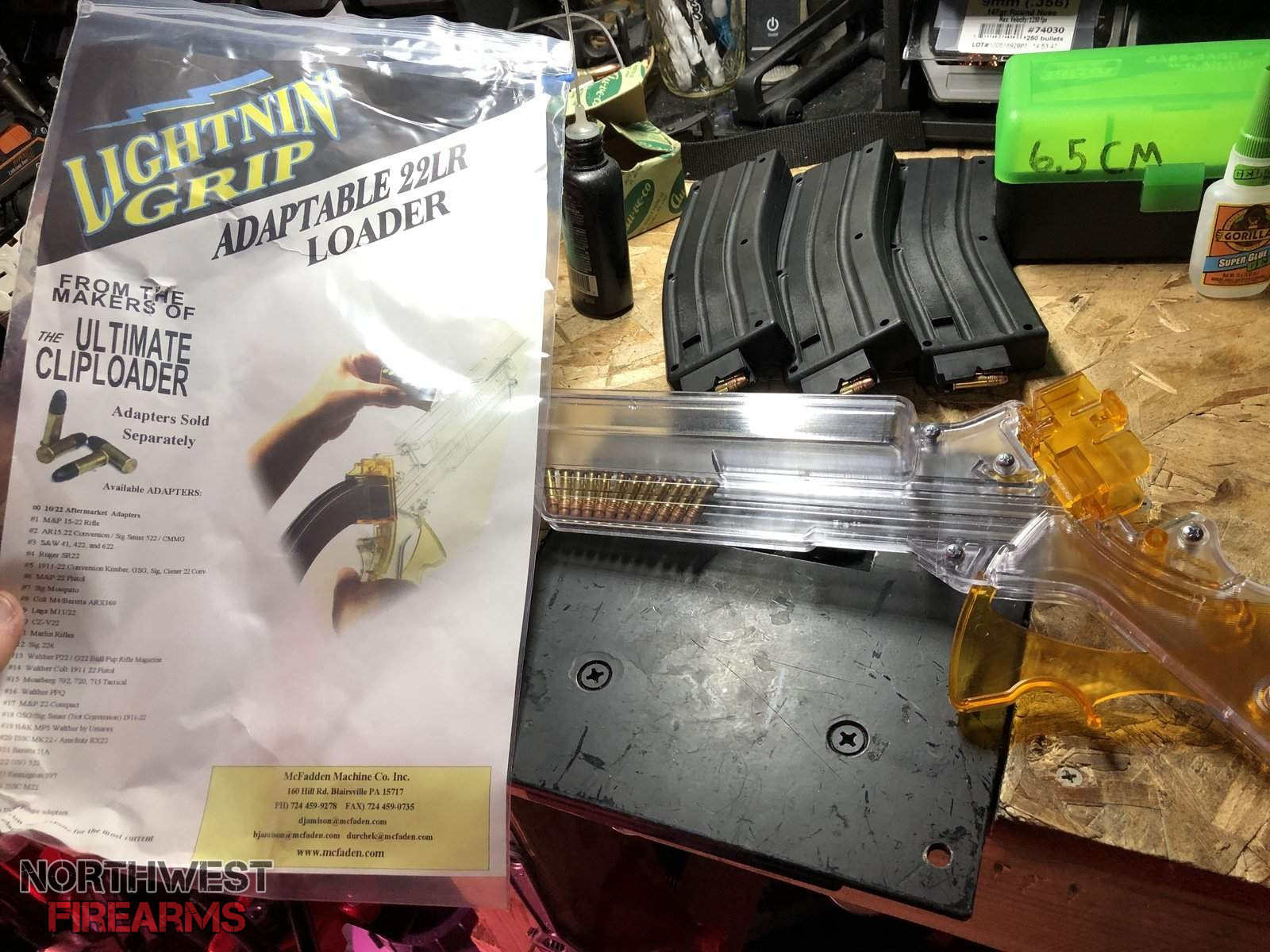

Since you asked......
Ok, ok, ok......I use it (to me it's the best for the BX-25). But you have to get the "right one" (Champion part #40430). It doesn't work with the "other brands of magazines". And, I don't use it load the factory 10 round magazines.
