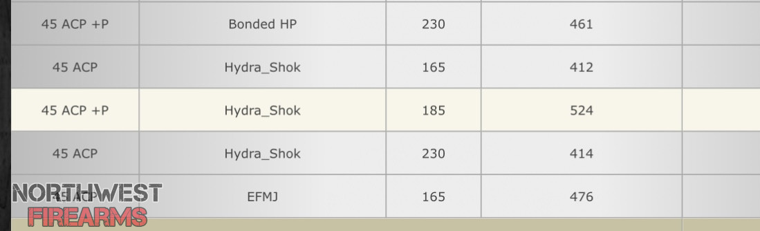

405 grain 45-70 at 750 fps, energy = 506
.45 acp slightly less than that

Let's assume a 400 grn bullet in the Cyclops, and compare it to a Buffalo Bore 300 grn bullet going 1300 FPS, per a recipe from the web:
Cyclops:
(750*750*400)/450240 = 500 ft lbs
.45 Colt
(1300*1300*300)/450240 = 1126 ft lbs
So the .45 can be loaded to beat the snot out of the load that Scott was shooting. But does it typically?
I looked for a more pedestrian load, and CCI Blazer 200 gr JHP goes 1000 FPS.
(1000*1000*200)/450240 = 444
A hunting cartridge:
Barnes 200 gr hunting cartridge:
(1025*1025*200)/450240 = 466
A self defense round:
Civil Defense 78 gn +P hollow point:
(1900*1900*78)/450240 = 625
So it seems like on average, they're pretty close.
