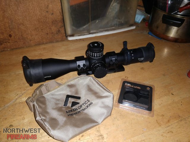

2022 is the year I'm branching into long range marksmanship. In my search for gear within my budget I ran across some videos about the Arken 4-16 and 6-25 SHA series scopes. The reviews and budget price, $400 and $450 respectively were both intriguing but seemed too good to be true. Then I ran across the reviews by Rex Tibor, author of Sniper 101 who can shoot to back it up and also trains as a contractor for .mil.
I decided to pull the trigger on the 6-25 scope and so far it's been everything I've seen in the reviews. It looks and feels like it's a top tier scope. The turrets are just perfect in feel, smoothness, and most importantly repeatability with top tier tracking error. Glass is much better than expected, though with a few small compromises compared to scopes costing five times as much.
The scopes are better suited to precision shooting due to fine reticle, but does have partial illumination that makes it doable for tactical and general purpose usage. My intent with this scope is precision long range, which is why I went with the 6-25 version. The 4-16x version would otherwise likely be the better choice

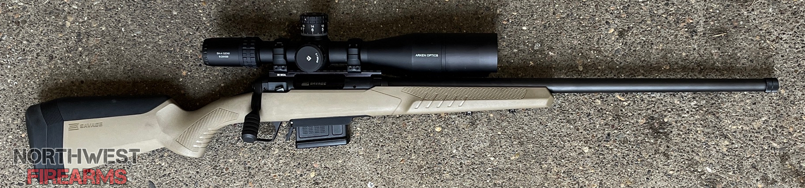

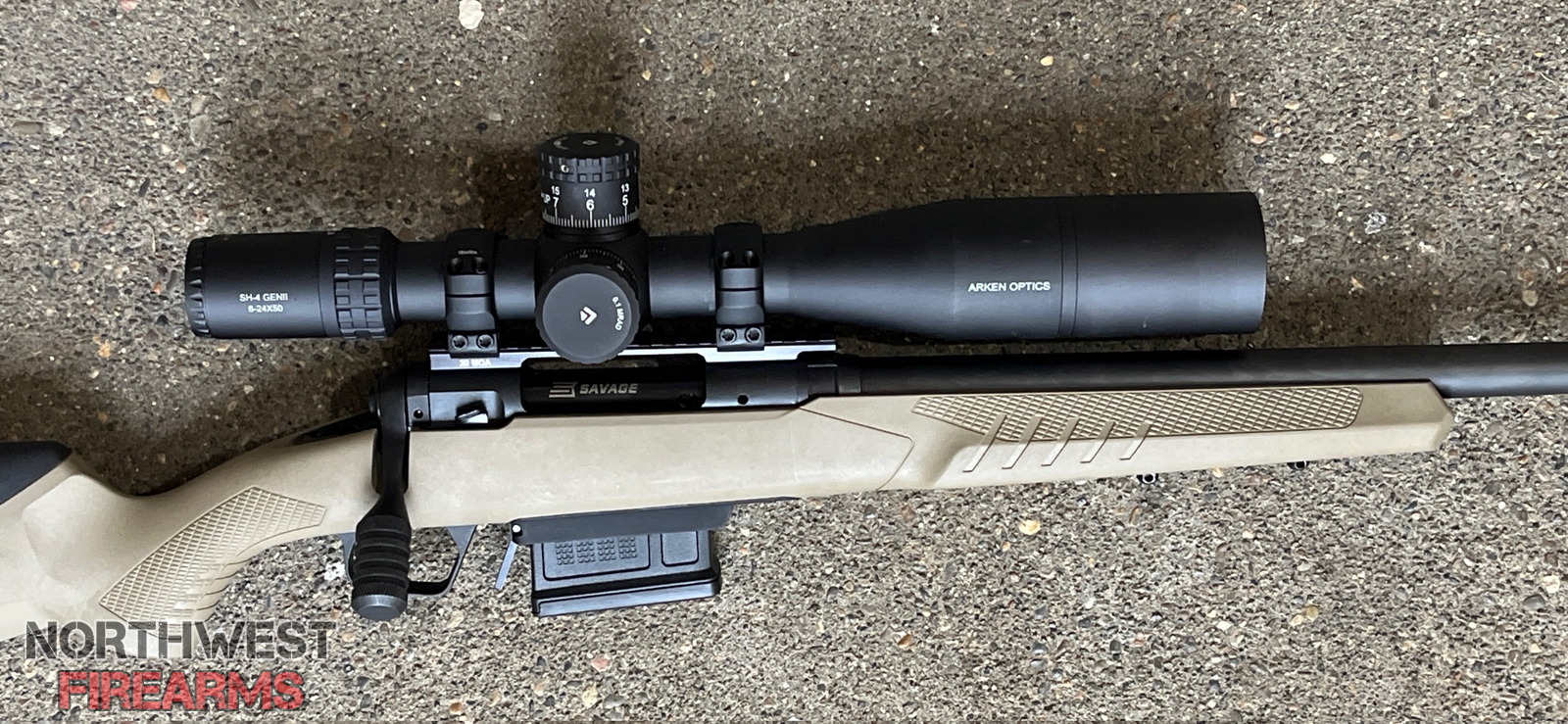

Scope test mounted on a Savage 110 Tactical Desert to give an idea of the size.
Comes with:
  • Manual
  • Zero stop wrench, but is a standard hex size if you lose it
  • Sun shade
  • Bikini style lens caps
  • Lens cleaning cloth
What's great:
  • Tremendous value. Compares with scopes in the $2k USD and over class and even some at >$3k USD.
  • Well made, solid, and beefy. Rated for 50 BMG.
  • Turrets compare with the very best
  • 34mm tube gives a lot of MOA adjustment.
  • Optics are on par with much more expensive scopes
  • Comes in MOA and MIL models.
Compromises
  • Sunshade not threaded so no ARD. Then again, this scope is primarily designed for precision as opposed to tactical applications.
  • Eye box is small at 25x, but still very usable.
  • Dims slightly (as expected) from about 16x on but still bright.
  • Illumination is limited to the central cross hairs.
  • At 36.6 ounces and 14" long without sun shade it's pretty hefty. The "smaller" 4x14 is only one ounce lighter at 35.6 oz.

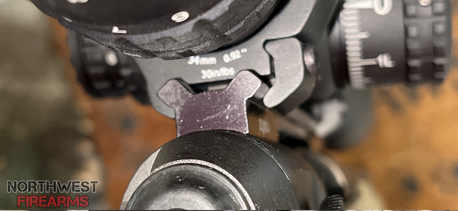

I bought the accessory combo pack on a Black Friday deal. The kit comes with flip up lens caps, 34mm rings, sand bag, scope level, and throw lever. All are nicely made and work well.
The rings are high value, beefy, and STANAG compliant. STANAG is an extension of the picatinny system that allows for more surface contact and results in a stronger mount. They have a smooth finish inside and lined up perfectly with no lapping required. Mounting hardware is the same for base and ring and uses some pretty beefy Torx screws, with tool and extra screws provided. A nice touch is that the torque specs are printed on the rings. Too bad they only make them to fit their 34mm tubes and not other sizes. At $60 USD they compare with rings in the $150 USD range.
This picture shows the markings on the rings - tube size, height and torque. BTW these are the low height which was perfect on this rifle providing a fat quarter inch barrel clearance. You can also see the STANAG shelf in the gap above the picatinny rail that came with the rifle. That rail will be replaced with a Warne STANAG I have on order.
