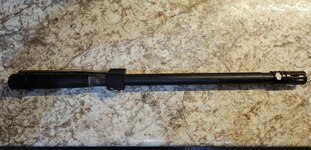

I dug up a cheap looking upper out of my parts stash and it had a cheap looking BCG in it. I am going to use this upper for my first upper build project of 2025. I have a used 16" 300BO barrel (pistol length gas port) that I am considering for the barrel. I want a 300BO upper set up so I can shoot cast loads down at the silhouette range.
Before I do that build I am going to try out this BCG in the AERO upper and see if it functions well.
