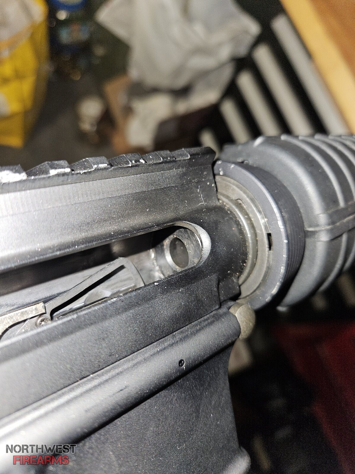

I found and installed my Stern Defense mag well adapter for M&P/P320 mags. I tried cycling a couple of hollow points I had on the bench and it didn't go well. Hopefully round nose rounds feed better. I can tell this set up is going to be a fussy eater.
The barrel in this upper has the lame feeding cone. It's a big jump from the feed ramp built into the mag well adapter to the feed cone.

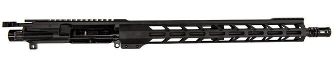

I want to build a micro pistol like what's pictured. 4.75" 5.56 barrel with a CMMG .22LR kit so I can run a bufferless lower

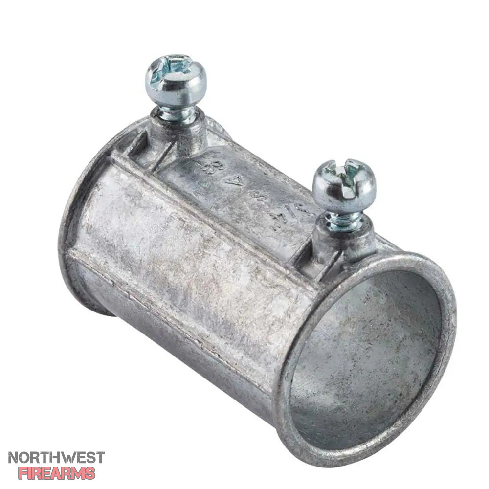

Next upper build on the list is a goofy one. Plan is for another bloop tube project but with 300 BO 16" barrel. Instead of using copper tube like on the Glock 21 project, I will use 3/4" EMT pipe. It should slip right on the barrel all the way past the gas port. This will be a manual loader set up. To secure the EMT to barrel I will try something like this.
Holes will be drilled throught conduit pipe and into barrel to act as dimples for the two set screws to rest in. I will powder coat it and the EMT pipe black to lower the ugliness profile. The connector above will be hidden under handguard so it shouldn't be obvious what materials were used. I have a cheap Bear Creek Arsenal barrel that will be sacrificed for the project. I may make the bloop tube ridiculously long since EMT pipe is cheap. It should be fairly easy to remove if I don't like it.

Decided I wasn't going to pay $10+ for a stick of EMT, so I used some left over black pipe from a slamfire shotgun project. I still need to put a finish on the barrel "shroud" but here are some mock up pics. 300 BO barrel is 16", shroud extends it out to 24". Still working out some details with attachment of shroud to barrel. It is going to be really ugly.

I'm getting close. The "collar" that holds the shroud to the barrel is heavily rubbing on the inside of the cavernous handguard. I will go to town on it this weekend with a file and I should be able to wrap up the initial phase of project as well.

Did a little massaging, with coarse file, nearly all the way around the collar. Test fitting went well and handguard spins freely over collar. I need to refinish it and it will be ready to go.
