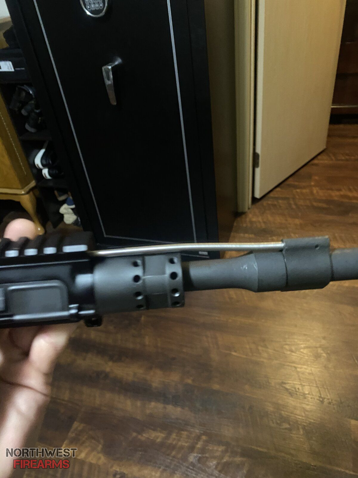

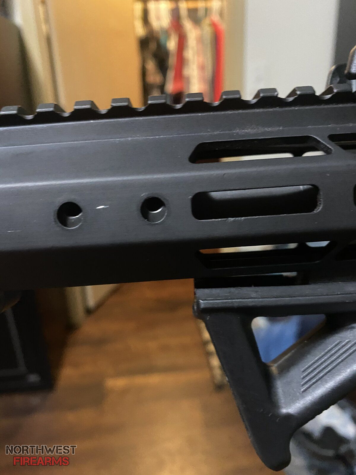

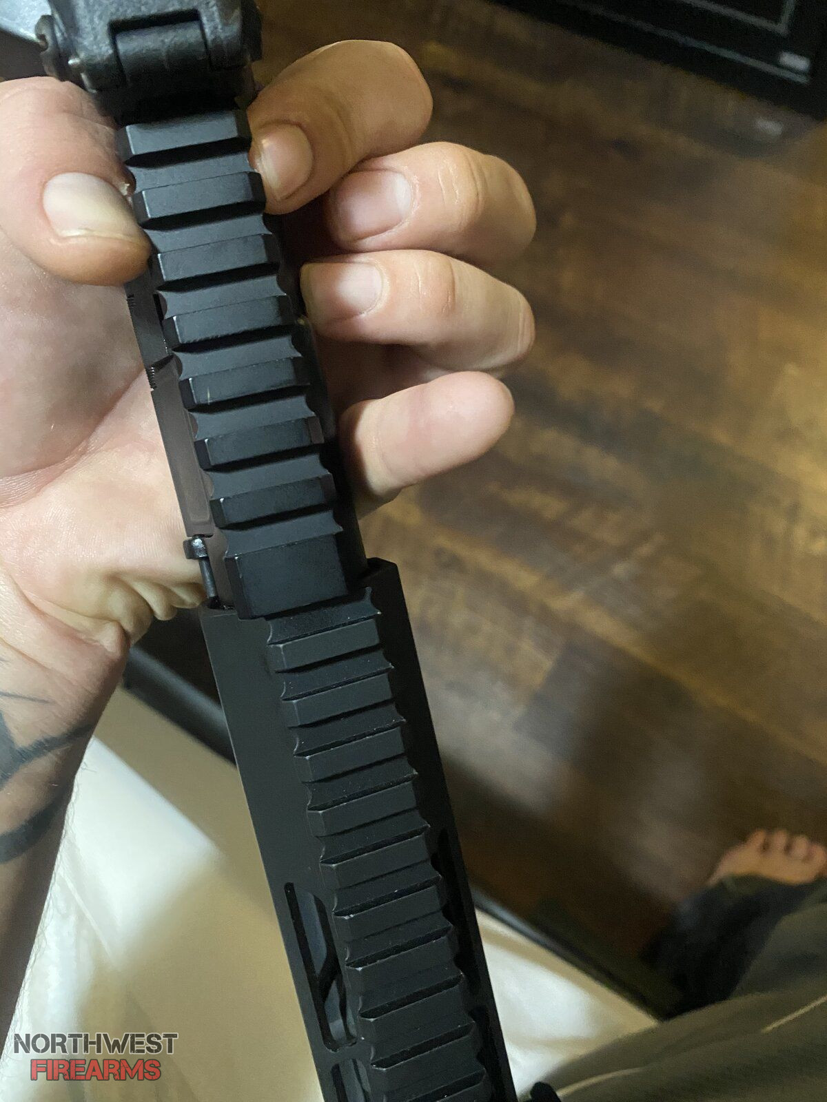

96FF6F14-C9B2-48B0-AD80-12AB2B21295C.jpeg EC6061A2-DEC1-46FF-BF42-38D84CDBCA7D.jpeg
The second picture shows where the threads need to be and the last picture shows the angle if the holes are aligned.it wasn't that bad when I bought it. But after messing with it it has just got worse
You'll need some shims. Try flipping the nut over and screwing it in from the other side first.
Remove nut, reinstall using shims, making sure to lube threads with Aeroshell or equiv. Torque to 35-80ft.lbs (generally speaking).
