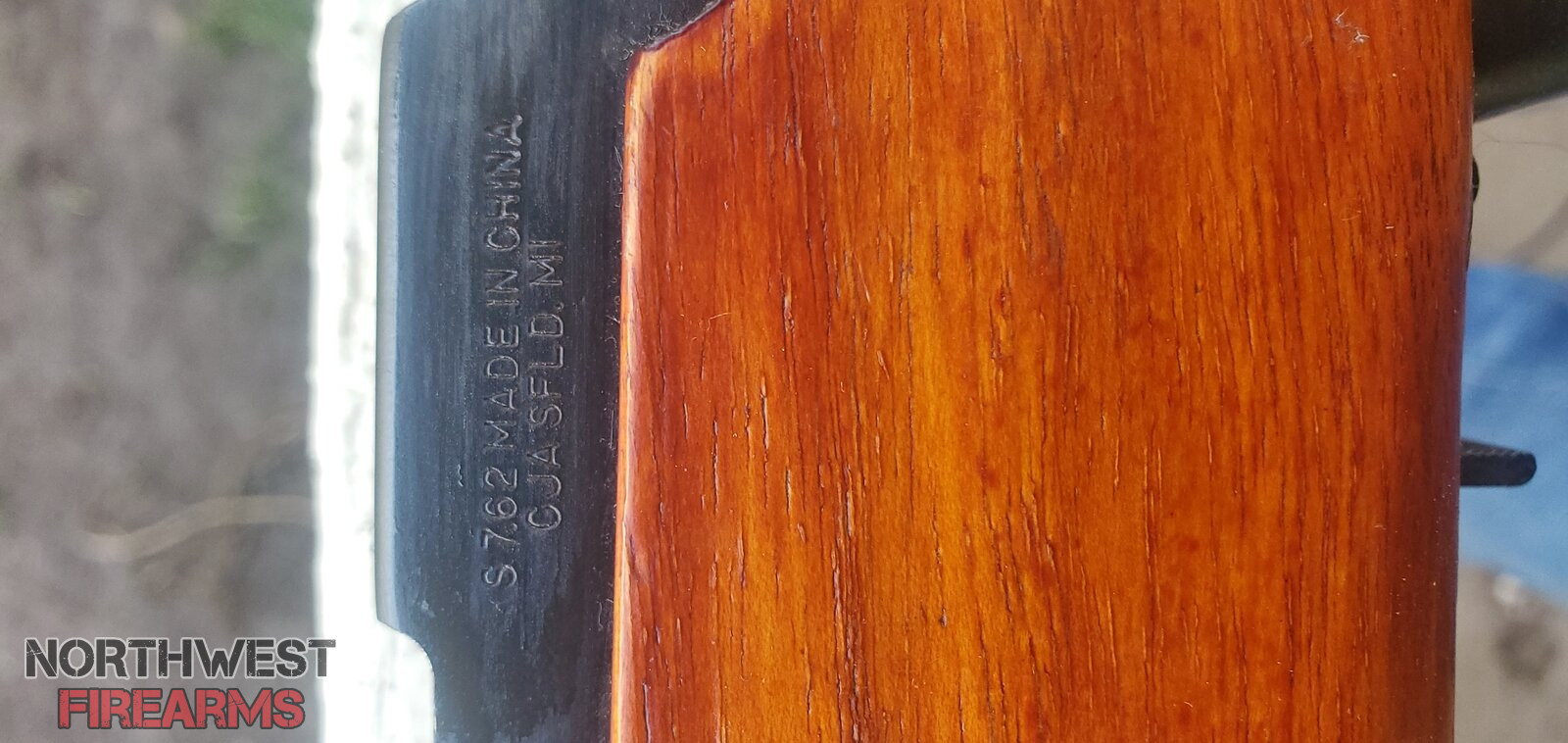

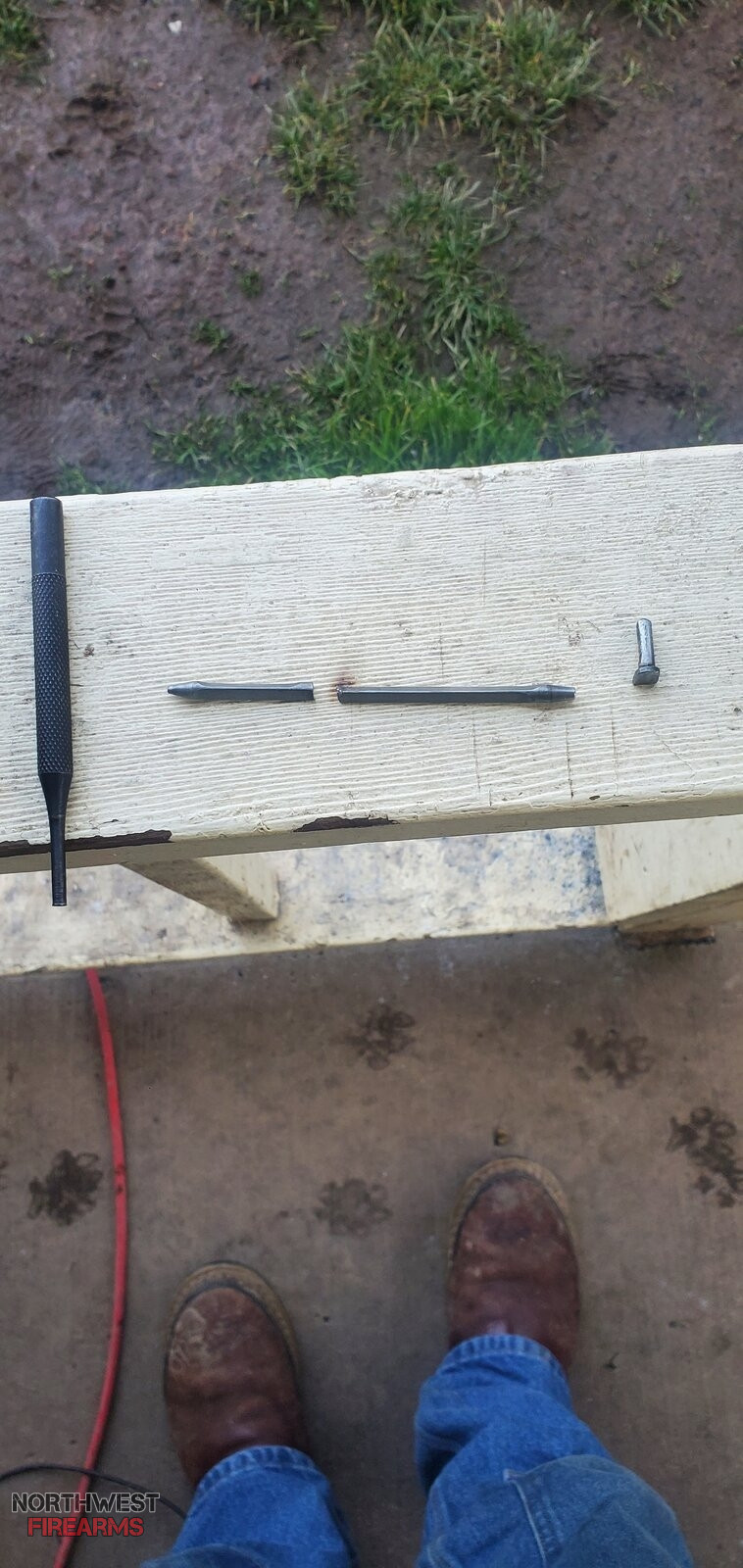

I recently received an SKS. Went out shootin it the other day and the firing pin broke in half. The retaining pin is a MOFO to get out. Need to get another firing pin but don't know what this rifle is. Its chinese, i know that much LOL.....Pics incoming in about 5 minutes....

That's all you need to know that it's Chinese. If you have an anvil with a hole on the flat, that will work for removing the FP retainer. I have an extra used Chinese FP if interested. Nice looking weapon. PAX

AWESOME!!! Just got the rest of the pin out. What a pain in the a55.......I'm interested in the FP
So looking at the pics closely, it looks like it says 26. Is that a type? I know about type 56's but I don't know how to identify the "type" of rifle

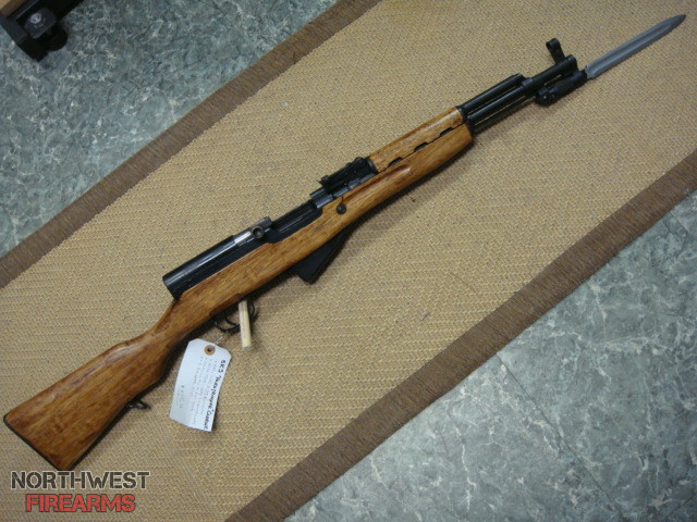

Yours is an early military model, with a blade bayonet and milled trigger guard, a very nice specimen.

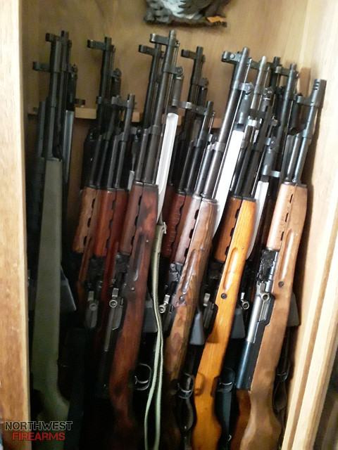

The 3 Chinese characters to the right of arsenal /26\ say "type 56." I also have a NEW 2 piece Murray FP if you want. I have a couple of each flavor including 9 Paratroopers, but none of the Holy Trinity, East German, North Korean or NVA. PAX
