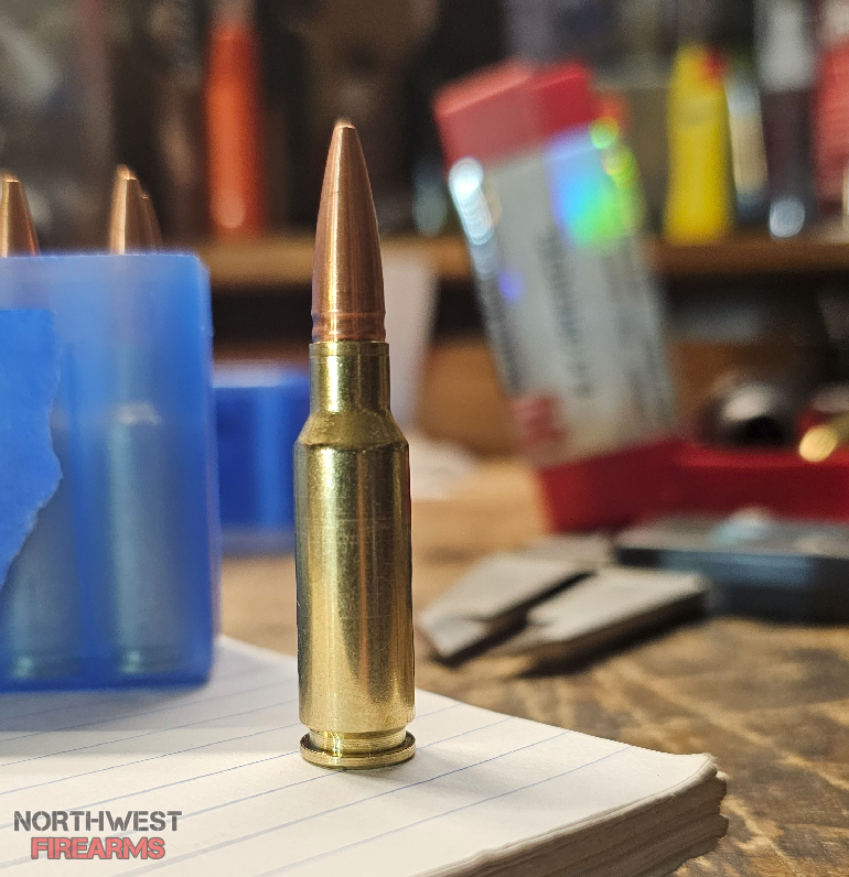

Ive got a handload for my 6.5 Grendel but I'm finding the neck tension is lacking, about .001". I'm having to crimp to help control COAL when chambering in a semi auto.
I'm using a Hornady "Custom Grade" full length sizing die. They use an elliptical expander. I searched their website for spares or different expander sizes and cant find anything to buy.
2 questions:
What would be the best ideal way to control neck tension?
Is there something I can do with the Hornady die to control neck tension?
