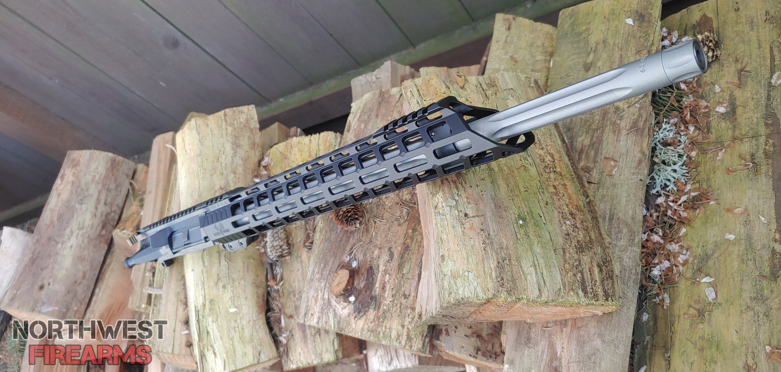

The unboxing..... just wow.
Beautiful. That's from Grendel Hunter? Pretty much looking at the same upper in an 18". Want to install a Dead Air brake so I can put my Sandman suppressor on it.

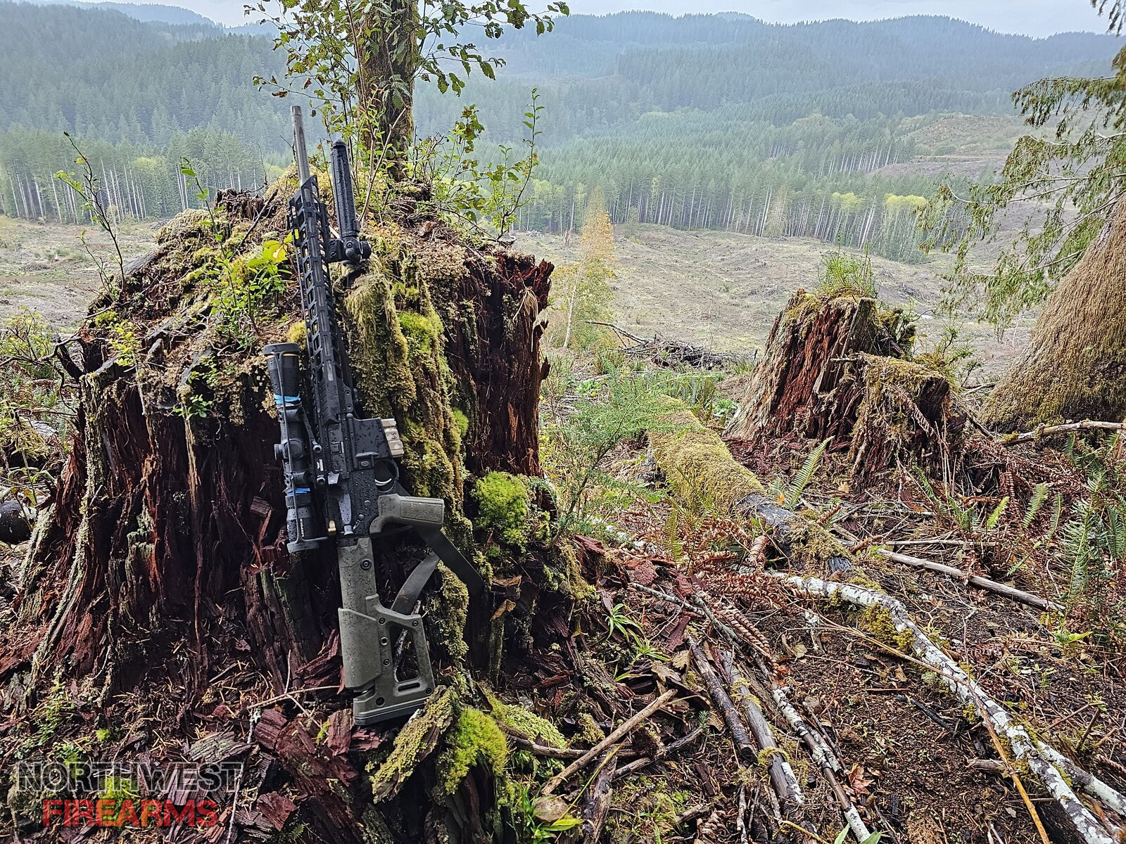

Ive had all summer to play with it and love it. ASC 5 and 15rd mags work fine, the 15rd wont feed the top one so its downloaded to 14. ARStoner 25rd mags work fine. I went with a carbine buffer assembly and a Magpul PRSlite rifle stock, works great after working out issues with spring and buffer weight. I thought the adjustable gas block was kinda hoaky dialing it in, seemed ineffective.
I worked up a handload with a 97gn Absolute Hammer bullet at 2800fps with A2520 powder. I'm getting about 1.25moa and hitting out to 300yds with only a 6in holdover. I'm limited to 300 with the scope I have because its a simple 3-9 and doesn't have external turret dials so a 200yd MPBR zero works fine out to 300yds. At some point I will upgrade the scope as I think the caliber and my handload is capable out to at least 400yds.
Ive been hunting deer with it all season, no luck but its been a great carry rifle at 9.3lbs.

yes, the upper is from Grendel Hunter. They did an excellent job, and fast shipping. They use Satern barrels and Ive heard mixed reviews but when it was still unfired I examined the chamber and bore and crown with my borescope and its one of the smoothest cleanest new bores Ive ever purchased. The crown is a perfect edge. I think my rifle is more accurate than I am or my handloads but need to work on that.

I wont be back for a week to weigh it for you but iirc it was about 9.5lbs with my Leupold 3x9 scope. 20in bbl...
