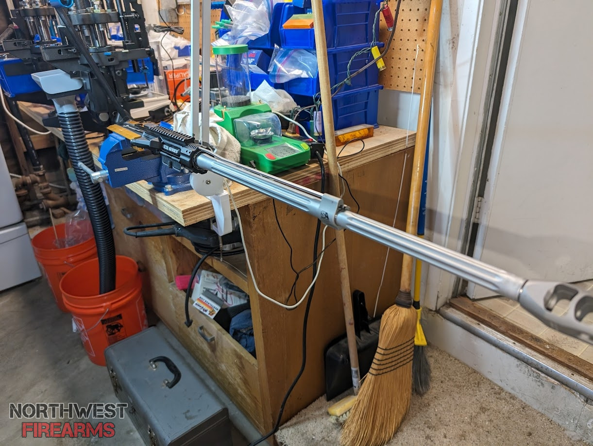

Building a 6mm ARC upper. Will use an other setup for the lower. Have:
Upper: Aero M4E1
Handguard: Aero 15" MLOK
Barrel: 22" Shaw. On order. HBAR fluted.
Gas Block: Superlative Arms .750 set screw
Muzzle break: Not sure
BCG: Like to get a DLC version of Toolcraft 6.5 Grendel, hard to find these days.
CH: Not sure.
Optic: Not sure
Received the 22" Shaw barrel. Looks nice. Even dimpled the underside of the gas port!
Got the 6.5 Grendel BCG. DLC coated, it should be slick but easy to clean. Bought through 65 Outfitters, although Arm or Ally had a better price. They wouldn't sell to my state.
Barrel installed. AGB also installed. Got the handguard in too. Now just need to get a crush washer to complete the uppper.
Got some 6 ARC new brass and 103gr Hornady 103gr ELD-X bullets on the way. Will load a ladder with CFE-223.

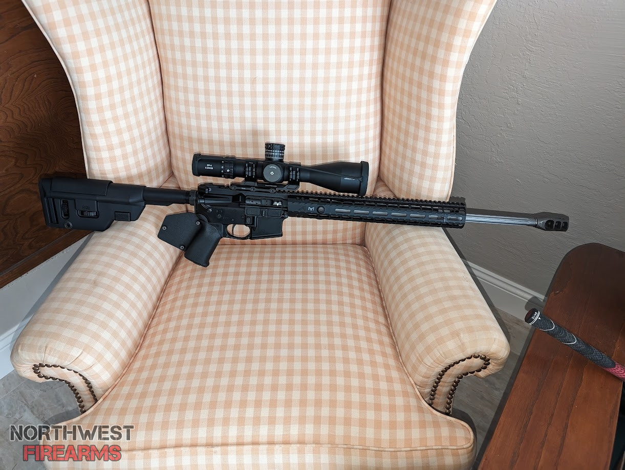

Nice looking rifle, especially at 850+ yards.
I think everyone has an AR in their safe that they never shoot anymore. Someone who is interested in a 6mm ARC can easily convert to it with a barrel, a bolt and a magazine to get started. You can always do more and better, but it is a very fun caliber to shoot.
Setting up the gas system was pretty easy. Now ejecting at about 4 to 4:30. Last round locks back with 103gr Hornady Black factory ammo.
