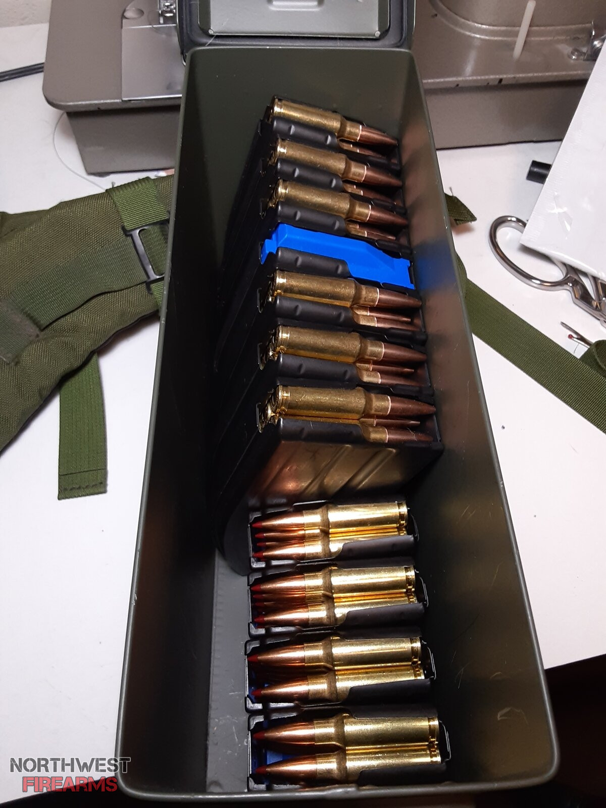

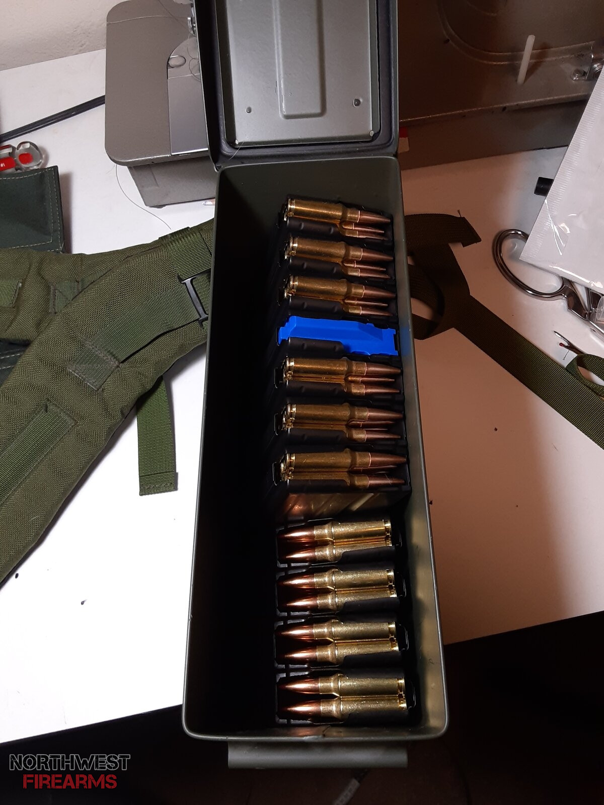

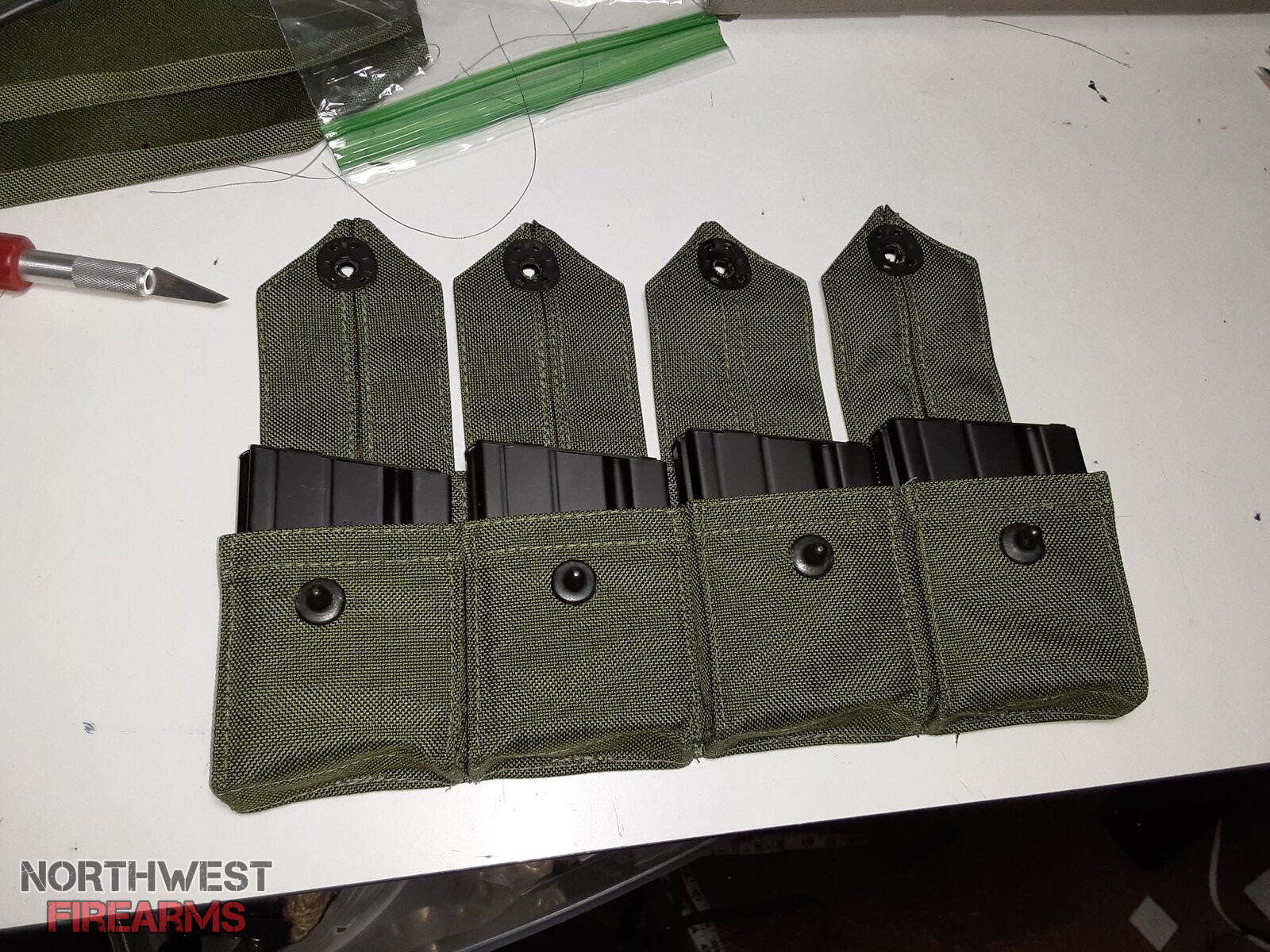

I run C-Products Duramags in 10 and 20rd sizes, and ASC 10rd size. Esstac Shorty KYWIs are the largest that fits the 20rd Duramags, too tall for the 10rd mags which is why I made the 4 cell Retro style pocket. 11 of the mags fits a standard 30cal can by the way. 20220722_151821.jpg 20220722_153310.jpg 20201109_171156.jpg 20201109_171207.jpg 20201014_163905.jpg 20201012_141354.jpg

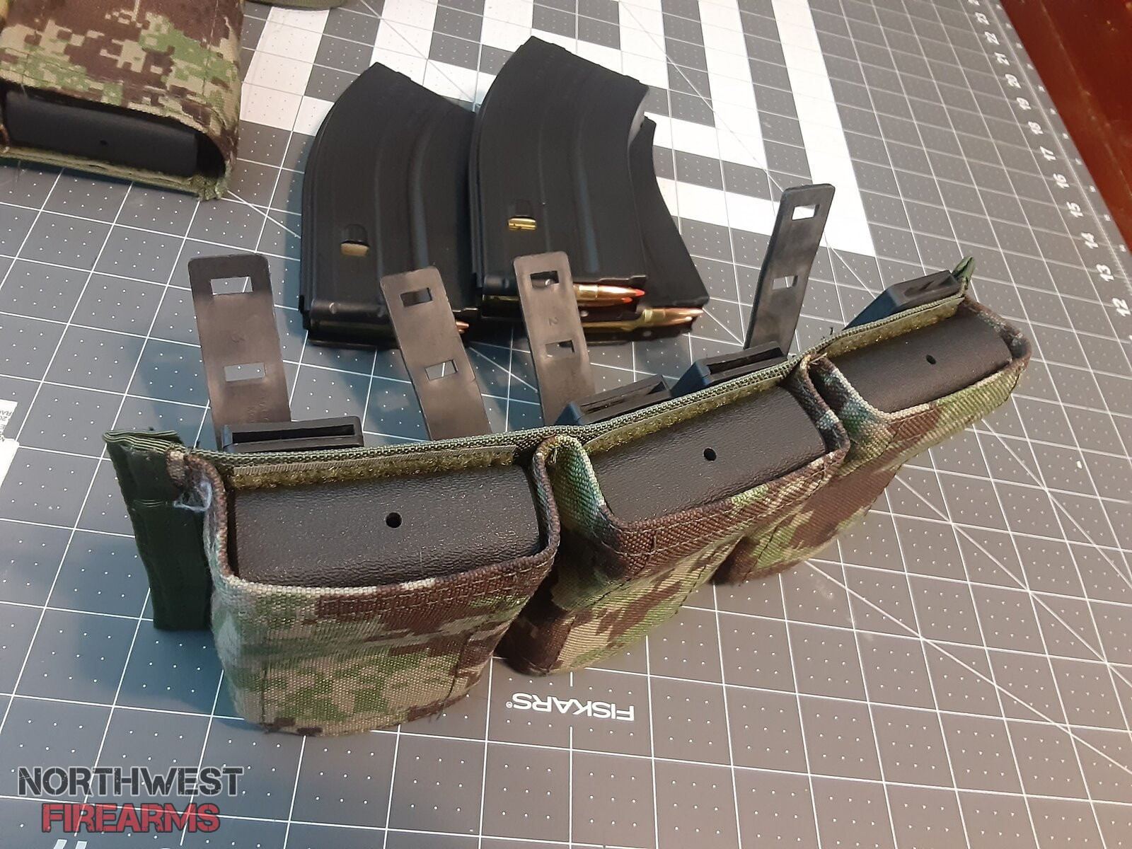

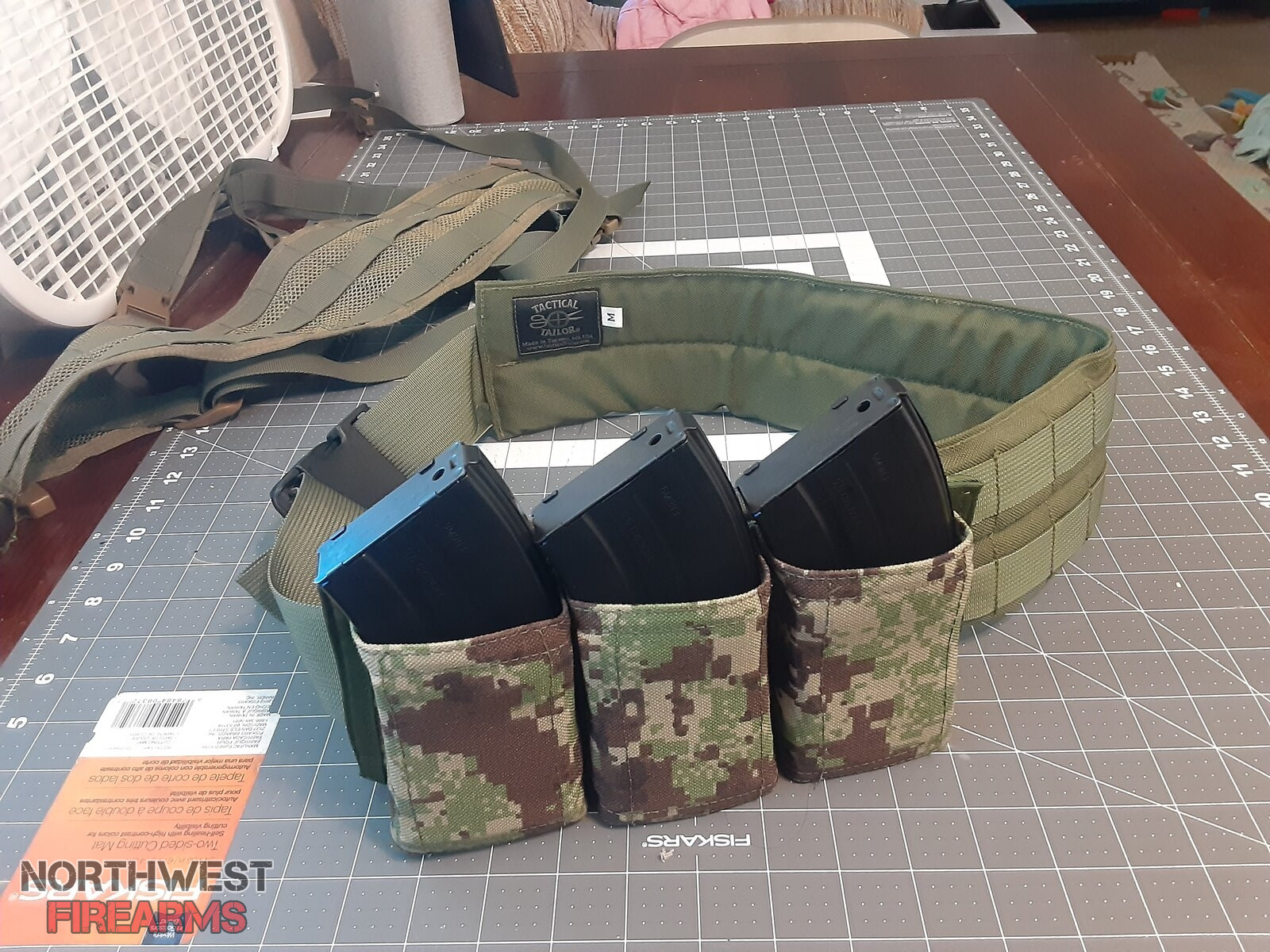

Edit. I also made a 3 mag retroish belt/MOLLE pouch for the 20rd mags 20200918_123743.jpg 20200918_131104.jpg 20200918_131124.jpg

I run C-Products Duramags in 10 and 20rd sizes, and ASC 10rd size. Esstac Shorty KYWIs are the largest that fits the 20rd Duramags, too tall for the 10rd mags which is why I made the 4 cell Retro style pocket. 11 of the mags fits a standard 30cal can by the way. View attachment 1417081View attachment 1417082View attachment 1417083View attachment 1417084View attachment 1417085View attachment 1417086
Edit. I also made a 3 mag retroish belt/MOLLE pouch for the 20rd magsView attachment 1417088View attachment 1417087View attachment 1417089
