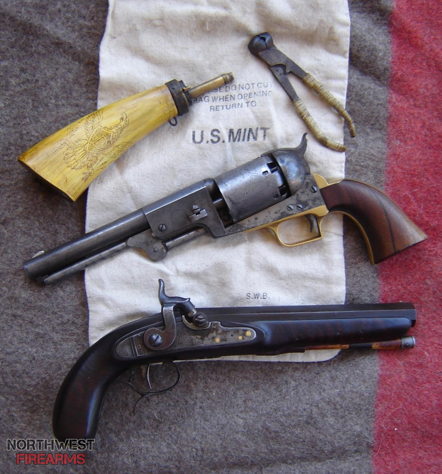

Here is my pistol that I made from spare parts....Maple stock
Andy

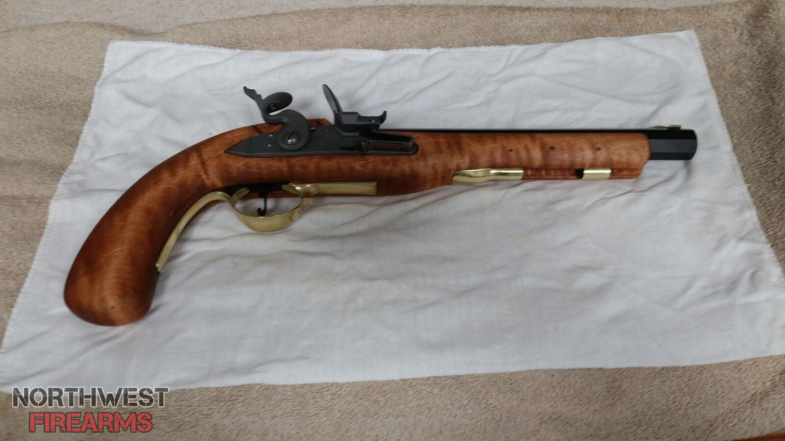

I built this flint lock pistol stock from a blank, (not a preformed one) , Purchased a Lock from Jim Chambers and misc other parts and barrel from other muzzle loader companies.
It took some time to complete build as it was my first attempt at pistol building.
As far as the wood goes, the tightest grain piece you can get will work better on the in letting. My blank was more of an economy grade maple.
Their are a lot of good books on the subject.
Or you can restock a more modern rifle.
