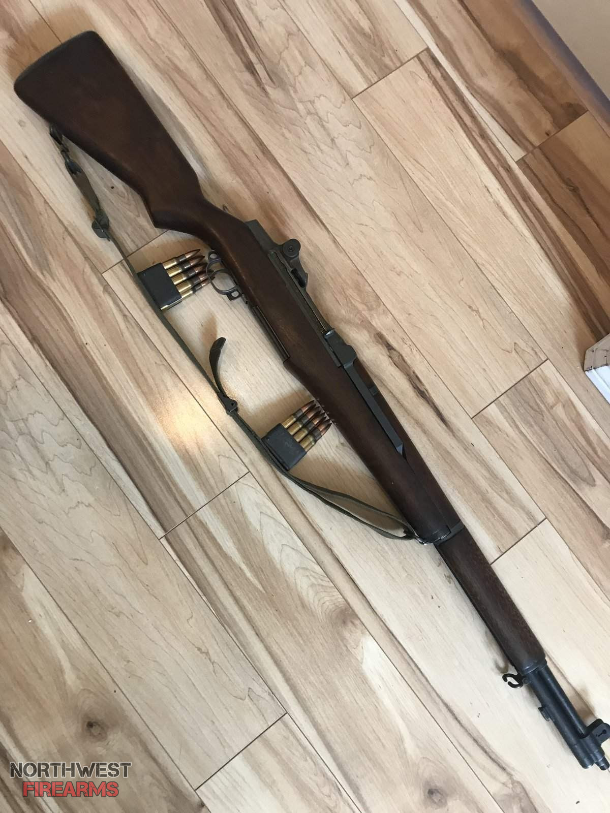

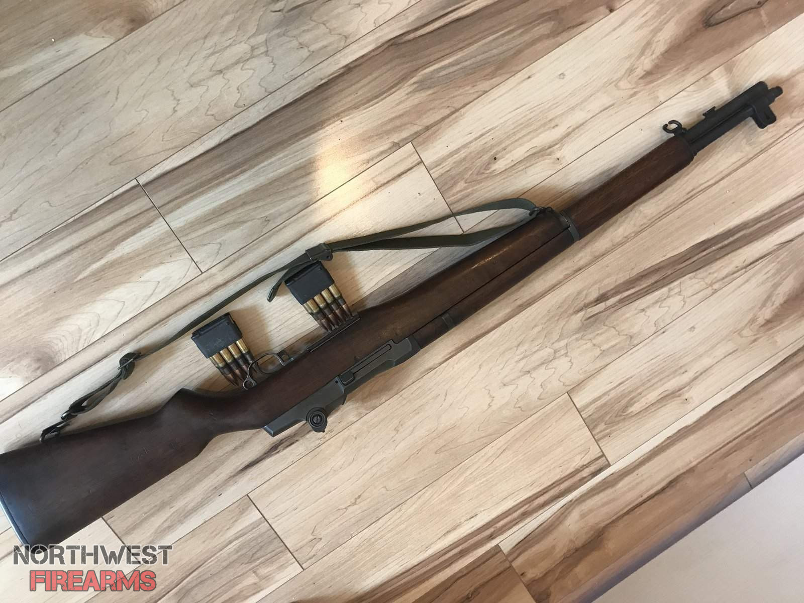

Winchester M1 Garand. Muzzle wear just under 2 and throat wear just under 5 on the 12-53 Springfield barrel. Most parts are Springfield, but the receiver and the trigger guard are Winchester from WWII. Includes sling and 2 clips of LC ammo. $1,200 and buyer pays transfer fee. New lower price $1,000

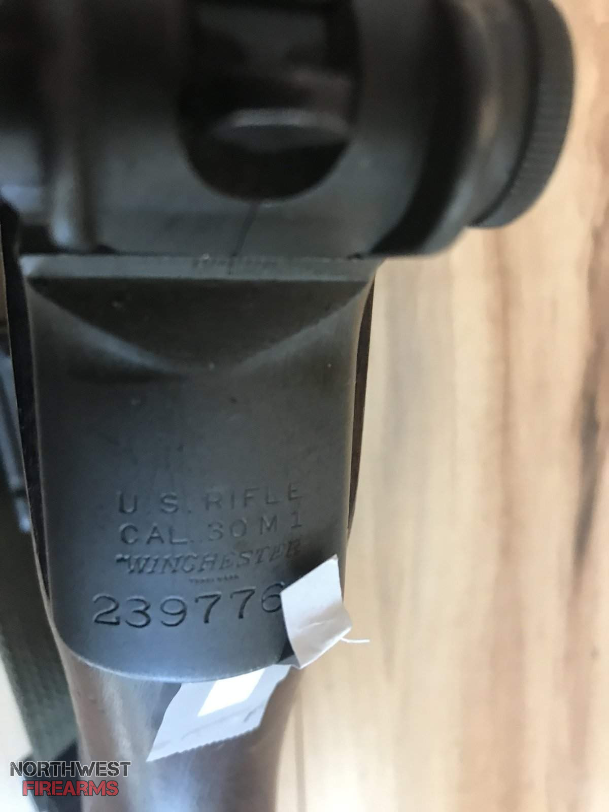

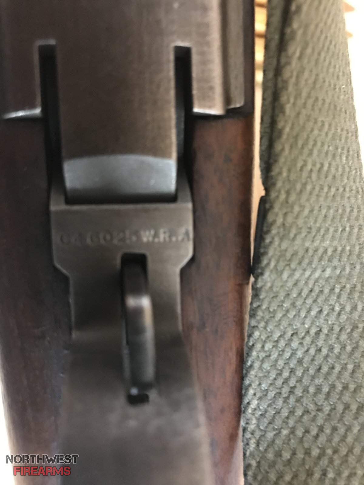

Any arsenal markings on the receiver leg? Picture is a bit dark to decipher, does the receiver appear to be repark’d or no?

There are no arsenal markings on the receiver leg. The receiver may have been reparkerized. It is a slightly lighter gray color than some of my other WWII rifles.

Yes it went thru Clean & Repair After it went to WWII....
Rebuilt somewhere. W/ a MW of 2- and a Throat Erosion of 4-
